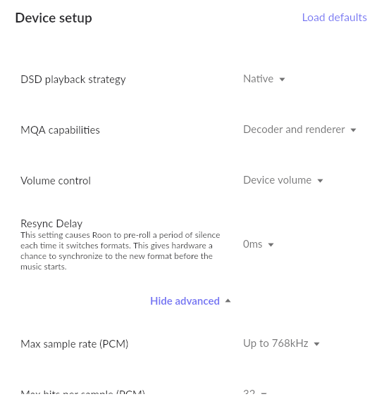

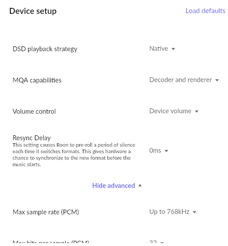

Would adding Resynch Delay in Roon help since it should detect the rate change prior to HQPlayer upscaling and add some pre-roll silence/resynch opportunity?
Give it a try. It did not prevent clicks/pops in my case.

And regarding the resync suggestion: in this setup, Roon’s Resync Delay was already set to 500 ms when the problem was happening. So I don’t think increasing the delay further would really solve it. This does not seem to be just a brief transition artifact — the state appears to remain wrong during playback, and the ticking continues periodically instead of settling after a short delay.
