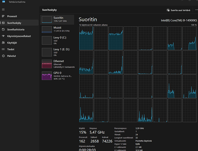

Yesterday, the official 24H2 appeared for download on Microsoft’s website. I think +5-10% more performance. In the picture psgl super 512+ with all the goodies…
