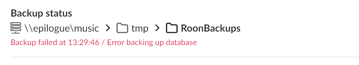

I am experiencing problems with my backups. Until beginning of September my daily scheduled backups worked flawless. Every night the server did run this successfully. Since about 6 weeks it started to fail from time to time. The only message I see is:
But there is no additional info on the reason, no log, nothing I am aware of. Where can I find out what causes the fails? Backups are essential and I am feeling VERY unsecure of this.
I also tried to backup manually but the result was the same:
Just a curious question here, but from your screen shots it seems you are backing up to the same share where your media files are located?
I’d firmly recommend a completely separate location for the database backups. And just checking, you are aware that backups does NOT include your media files, just your database, settings, edits, playlists and such stuff?

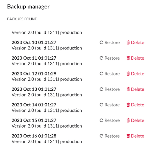

Also, just another access related check - if you select ā€˜clean/restore’ via the 3 dots in the scheduled backup window - does it correctly display a list of all your backups? I use this to delete some old backups I no longer need.

Thanks for your input, Stampie. I had a look at the log-files of the roon-server and was able to find the entries where the backups failed. The 2 backups stop at a different progress (10% vs. 30%). Further than that, I am not able to really understand the logs properly.

Daily run while watching the progress
10/19 13:29:46 Trace: [backup] uploading files. bytes transferred: 4871760931/16028496549 (30%)
10/19 13:29:46 Trace: [backup] uploading files. bytes transferred: 4871769391/16028496549 (30%)
10/19 13:29:46 Warn: [backup] failed to sync: putfile hash: AttachedDir:/Users/rkarpa01/Library/RoonMounts/RoonStorage_edd12c747c81ca48607327083b405492939114f6/tmp/RoonBackups/6b952f04-ee94-dca4-0478-648ead8aa47a/d4/56/d4563b08f127614791cd8cde1d7838c7ff9720efb209cff900483d146e6a8ed4: Result[Status=UnexpectedError, ErrorText=System.IO.IOException: Is a directory : '/Users/rkarpa01/Library/RoonMounts/RoonStorage_edd12c747c81ca48607327083b405492939114f6/tmp/RoonBackups/6b952f04-ee94-dca4-0478-648ead8aa47a/d4/56/.tmp-d4563b08f127614791cd8cde1d7838c7ff9720efb209cff900483d146e6a8ed4'

10/19 13:29:46 Warn: [broker/backups] failed sync on FileBrowser.Entry: \\epilogue, music : \tmp\RoonBackups: Result[Status=UnexpectedError]

Yes, whenever it was a successful backup, I can see them in the restore-panel. I use auto-rotation using 10 recent backups.
