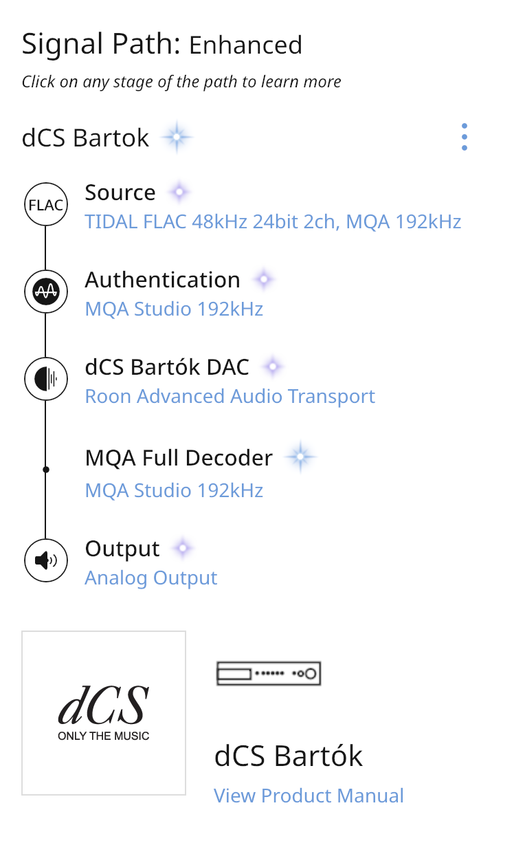

I sent the same inquiry to dCS but hopefully Roon staff may also have an answer. In my current setting, Bartok can properly process MQA files with the network input but not with the USB input (dCS setting of USB class 2 is chosen).
Below are the two screen captures. First is the proper function with the network connection (Bartok as Roon endpoint), and the second is using the USB output of Mac running as Roon remote. MQA files are properly authenticated in both, but only the network connection setting can decode the MQA files, while the USB connection plays them as 24/48 without decoding. On the other hand, I just checked and Bartok works as a “renderer only”, if I turn on the core unfolding.

My interpretation (which may be wrong) is that the first signal path (including the word ‘Enhanced’) is indicating that in this case MQA decoding is being carried out by Roon, and an ‘enhanced’ data stream is being fed to your Bartok. The second signal path indicates that a bit-perfect (lossless) stream is being passed to your Bartok, requiring the Bartok to carry out the MQA decoding.
Actually, the first signal path means that Roon authenticates the MQA stream. Roon does not perform MQA decoding here. Via RAAT it sends the bitperfect bitstream to Bartok, which carries out MQA Full Decoding, which is considered to be Enhanced. Roon knows about this because this information is fed back to Roon via RAAT.
The second signal path means Roon sends lossless bitstream to the DAC via USB, which can do whatever processing including MQA Full Decoding in the example here, but Roon does not know what happens in the hardware beyond USB so it is not shown in the signal path.

@wklie Thanks for the clarification. What you said is exactly right, and I know that Bartok is not decoding because the display shows that it’s no MQA and playing at 24/48. I’m beginning to wonder if the original design is that way. The manual vaguely indicated that MQA decoding is done with network and USB2 (USB A) inputs, but there is no clear mention that USB1 (USB B) is MQA capable. It looks like something that dCS will be able to answer. I will keep you posted if I get a response from dCS.

Sort of. It authenticates but does not perform any MQA decoding if Roon knows your chain supports MQA Full Decoding, and you do not use any Roon DSP engine and volume leveling features. (There may be other scenarios too but I do not claim to know them all.)
If Roon knows MQA rendering (or Full MQA Decoding) is taking place, Roon requires this to be marked as Enhanced even if Roon itself is not doing any DSP or any MQA rendering (which Roon cannot do).
To my knowledge, the second signal path is not representing a renderer-only config.
After enabling Roon MQA Core Decoder, and setting MQA Capabliities to “Renderer Only”, we should see a Roon MQA Core decoding step in the signal path. This step is missing.
Your signal path looks like you’ve set it to Decoder+Renderer (incorrect) instead of Renderer-only.
