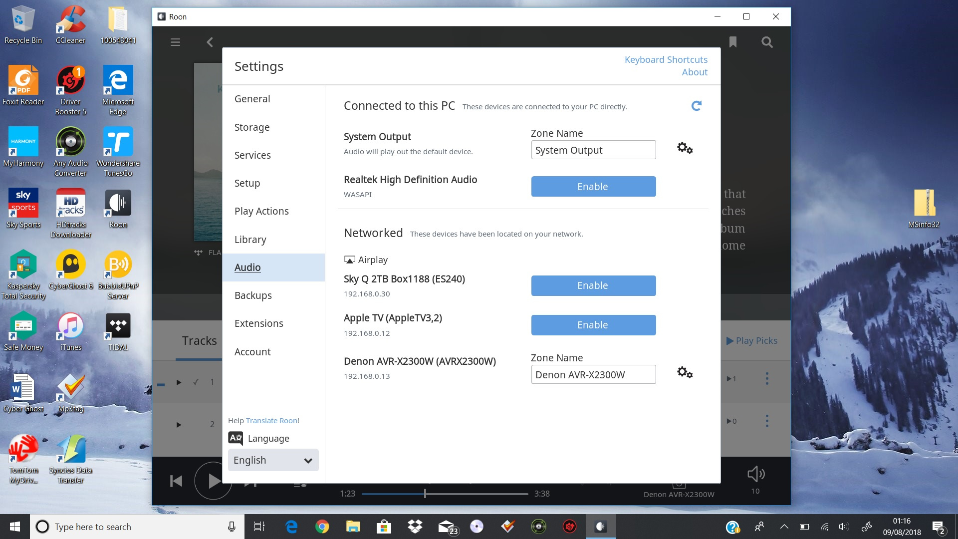

Hi Geoff, how do you enable HDMI? Is it in Settings, then Audio? Nothing is showing next to my Denon ( under devices located on my Network), either with HDMI plugged in or out. When I click the gear icon next to Denon and choose Device Set Up,again there is nothing pertaining to HDMI? Thanks.
Hey @Robert_McHugo,
Can you share a screenshot of what you see in Settings > Audio?
HDMI should show up under Connected to this PC. Do you see any HDMI options here?
-Dylan
Hey Dylan, see attached screen shots. Each time i play a track in Roon, the Denon switches itself from Aux1 on the Denon to Airplay
irplay, whether connected to HDMI or not.@Robert_McHugo - you will need to have your Denon connected directly with your laptop via HDMI in order to get the maximum quality.

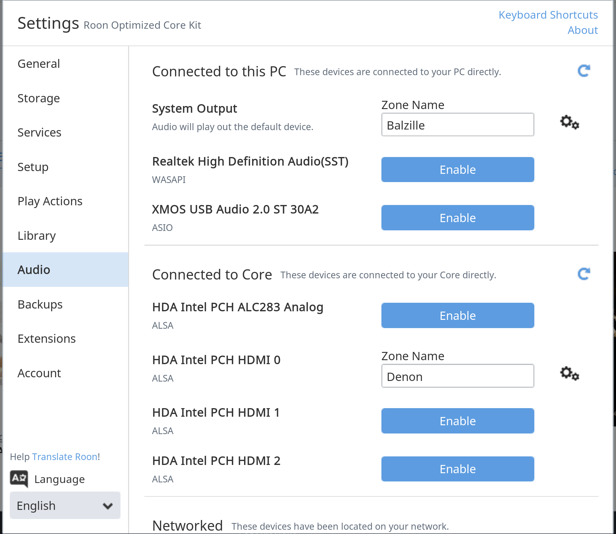

As an example, here’s some of the audio devices I see in my setup:
My Roon Core is running on an Intel NUC using Roon’s ROCK operating system. The HDMI connector is the HDA Intel PCH HDMI 0 device, and I use that to connect to one of the Denon’s HDMI inputs for my music. The Device Setup that I use within Roon is:
And the Advanced Setup screen looks like:

Hi Geoff. How do I connect to Roon Core direct? When I set up Roon initially, the results were as per my screen shot, ie “connected to this pc” and “Networked” as opposed to “”Connected to Core” like yours. Would I need to go through the set up process again, ie uninstall and reinstall Roon? Thanks.
Hey Dylan, further to my screenshots, under “Settings” - “Audio”, my screen is very different from Geoff_Coupe in the thread.
I have showing, “Connected to this PC” and “Networked”.
However Geoff has showing under “Audio”…“Connected to this PC” and “Connected to Core” which has the option to enable HDMI. I cannot figure out how to access “Connected to Core” which I assume would allow me to disable Airplay from the Denon and enable HDMI?
Any help or advice would be much appreciated. Thanks.
You have Roon installed on your laptop, I assume? Then that is the full version of Roon, which has all three components of Roon ( Core, Control, and Output) included. So your Core is running on your laptop.
You may not see an audio device appear in Roon until you have connected your laptop to your Denon with an HDMI cable, and turned the Denon on. If an extra device appears (i.e. in addition to the “System Output” and the “Realtek High Definition Audio”), enable that and give it a name (e.g. Denon). Otherwise, it may be that the Realtek High Definition Audio device is your HDMI port (but I think this is unlikely). In this, I am assuming that your laptop does have an HDMI port, of course…

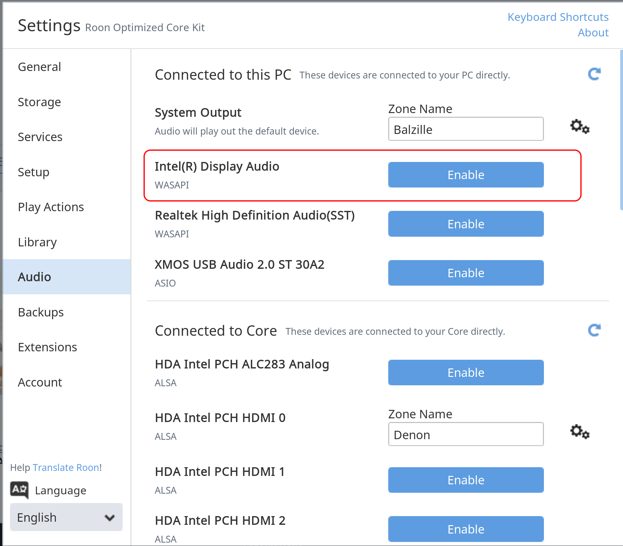

Here’s an example of what you might expect to see. These screenshots were taken of one of my laptops that does not have an HDMI port, but which does have a USB-C port, into which a USB-C to HDMI adaptor has been plugged. The first screenshot is of the devices when I do not have anything connected to the HDMI port.
The second is what I see when I connect a monitor with built-in speakers to the HDMI port. Note how an extra device appears - this is the HDMI channel. Enabling this in Roon would enable me to play music through the monitor speakers.
Provided you can connect your Denon directly to your laptop using an HDMI cable, I would expect you to see something similar to this.
