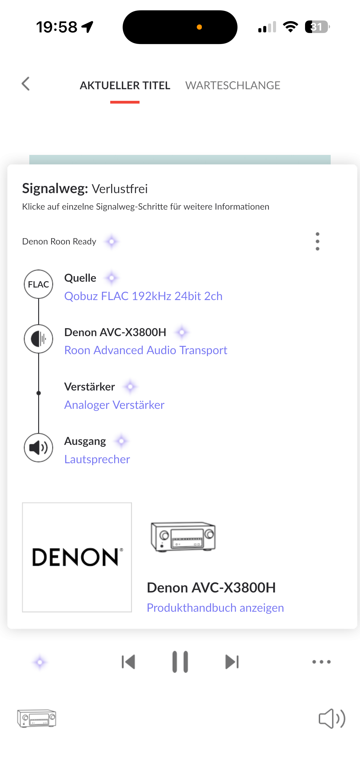

Denon AVC-X3800H is ROON READY now
Since the last firmware update fro Denon my AVC-X3800H is Roon ready!

I can confirm the AVC-X3800H works pretty well as a roon ready device, aside from the signal path converts back to PCM after processing, even though the manual confirms the Denon can play DSD at 5.6MHz.
Ideally, I’d like to avoid converting back down to PCM and keep the higher quality DSD.
Has anyone had any luck with the settings?
