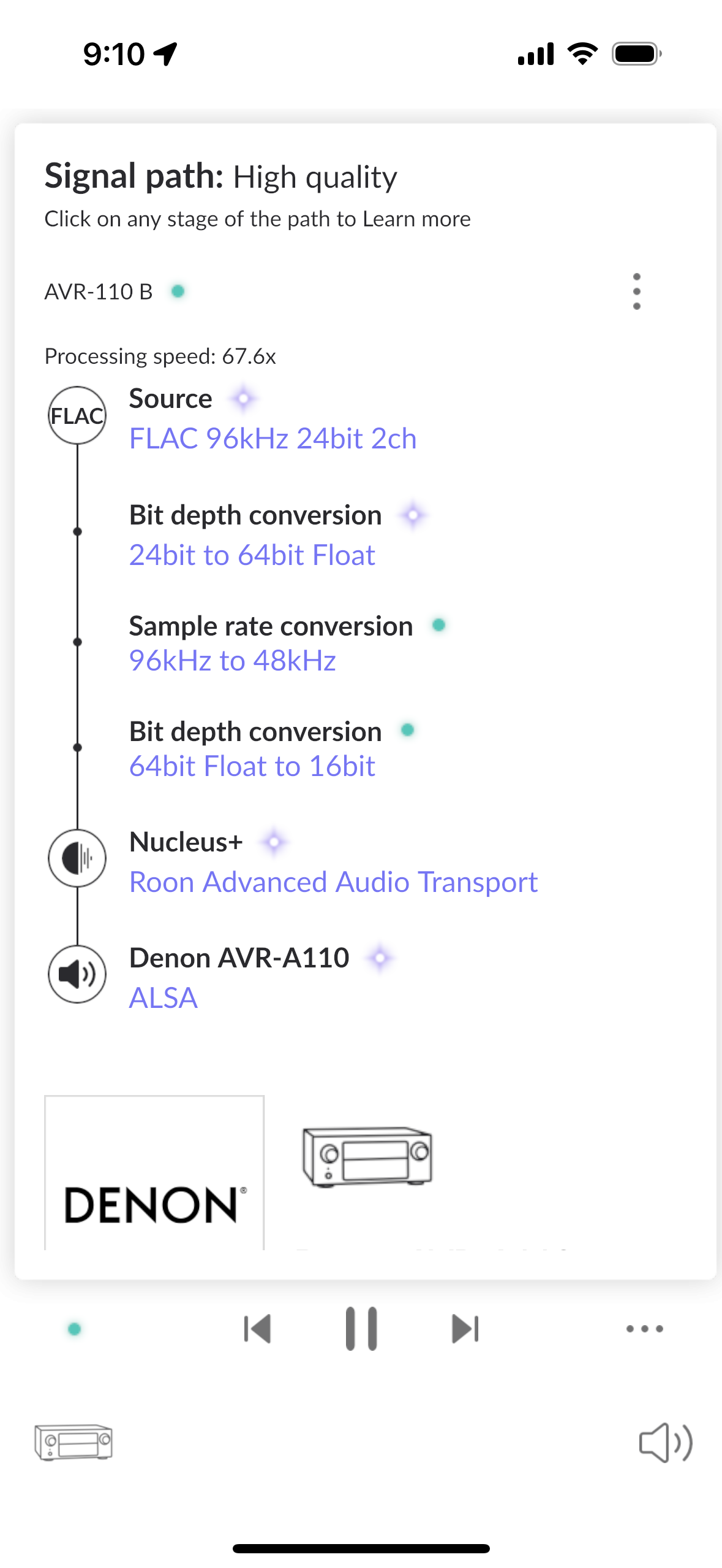

To save the guesswork, whilst playing a track can you take a screenshot of Roon’s Signal Path and post it on here.
So I have more info on this. If I hit play on a 192/24bit song Roon appears to randomly play it at 192/24bit or 16bit. I will take a screenshot but at the moment it is playing correctly at 192/24bit. I can’t figure out what is causing Roon to downsample.

I am starting to think there is a small bug here. The Nucleus+ has two outputs - HDMI A and HDMI B. When I attempt to play music using each output enabled I get different results, one of high quality and the other is lossless but I am playing the same exact song each time. Any thoughts on why this may be happening?
You apparently have two Zones/Endpoints set up; is it possible that you have DSP (Muse) enabled for one of them? Or do the two device setups differ in the Advanced settings?
E.g. you have 48kHz set as the max sample rate in one of them:
So the Mac sampling rate option disappears on the zone in question. Actually any settings referring to PCM or MQA disappear on the zone that is downsampling.
I am only using one zone meaning one HDMI connected to the Denon AVR but since the Nucleus Titan has two HDMI outputs I have been able to test both ports separately just to see if the problem only existed on one of the HDMI ports which is not the case. The problem follows to whatever HDMI port (A or B) that I use.
As I have mentioned in my original write up the port that is NOT connected to the Denon AVR can still be chosen as an output. When I do this no downsampling occurs. I don’t know if this is happening because no HDMI handshaking is occurring or not. What this does tell me though is the Denon AVR that I have defined in Audio Setup on Roon is capable of playing at the original sampling (ie not requiring downsampling).

Ad for HDMI, I have removed this from the equation since the problem exists without any cables connected to the Nucleus (for testing purposes). Meaning I can reproduce the problem with it without an HDMI cable connected where on HDMI A it downsamples and on HDMI B it does not downsample and both have the same output device selected on Audio Setup
