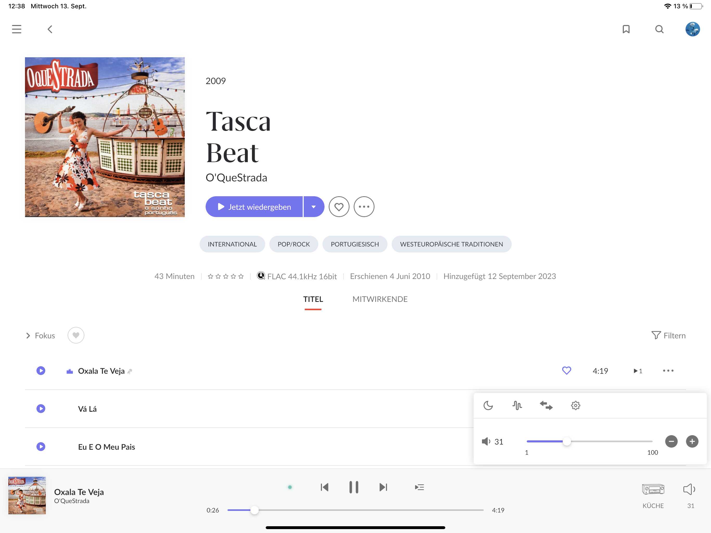

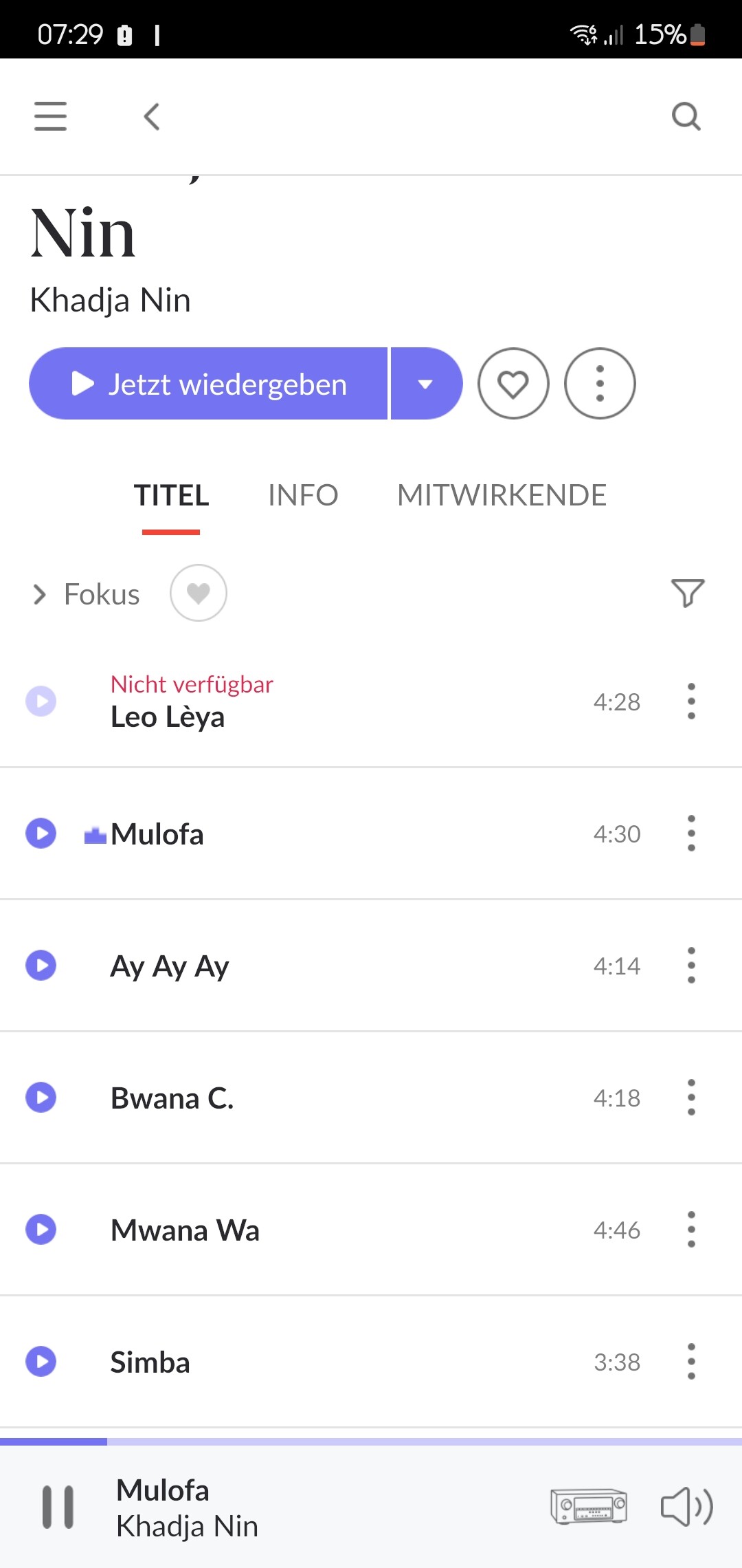

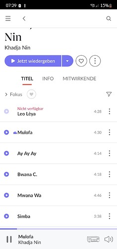

Hello Noris,
I’ll send you two screenshots from today, 09/13, where this problem occurred.
Again the process: I changed the playback device via the double arrows in the volume menu. Then the device turns on, the track played off but it was only heard when I pressed the volume button.
