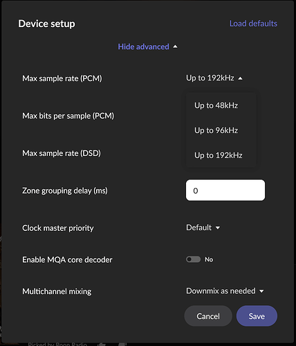

For some reason, with the 150 the lowest max sample rate you can choose for it in Roon is 48kHz. So if you want Roon to do the downsampling to 44.1kHz instead of the 150 it looks like you have to do it with Muse’s sample rate conversion instead.
I’m a bit confused. Why would you want to down sample? Doesn’t that affect the quality of the music is a negative way? Or is it that Roon does a better bit perfect conversion versus what the speaker will do?
The device does it regardless, so let Roon do the conversion because it does it with excellent precision.
@jcharr1, the option is up to 48 kHz.

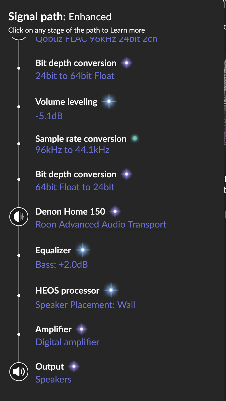

Here is with using Muse custom sample rates. It takes it down to 44.1
Right. But the problem is that if you only set the max sample rate in the speaker settings and play a 48kHz+ file Roon sends it as 48kHz and the 150 still downsamples that to 44.1kHz. If you want the 150 to not do any downsampling at all and let Roon do it you have to set Muse to resample everything to 44.1kHz. I have absolutely no idea if any of this actually affects the sound quality, but if you have hi res files and don’t want the 150 doing any sample rate conversion it’s not enough to just set the max sample rate in the device settings.
A 96kHz file with only the max sample rate set for the 150 and no Muse conversion.
WIth Muse custom converting everything to 44.1kHz. The 150 is no longer downsampling.
I guess Roon would convert 192, 96 kHz to 48 kHz, and 88.2, 176.4 kHz to 44.1 kHz. Evidently, the Denon does it different.

I turned off airplay on the 150 via the heos app and it’s still down sampling. @WiWavelength has advised it won’t receive a higher rate. Can you put up a screen shot of your signal path?
I think he’s mistaken the inbuilt DSP on the device only operates at 44.1 which is why it’s downsampling and has nothing to do with Airplay. You can defeat the eq in HEOS and see if it changes anything but as it likely is always active in the signal path even if its doing nothing it might not change Airplay would have never revealed this so either way is the same but you choose which you prefer to use. If removing the HEOS eq changes it apply the EQ via Roons Muse instead.
Playing 48/24 via HEOS shows its playing at 48/24, but not from Roon. The 150 still down samples even with the EQ (Bass/Treble) on the 150 reset to 0 and airplay disabled. If @WiWavelength is correct then HEOS is displaying 48/24 but its streaming at 44.1/24. Makes no sense.
Heos is displaying the input of the file not what it’s doing under the hood. This has been explained.
