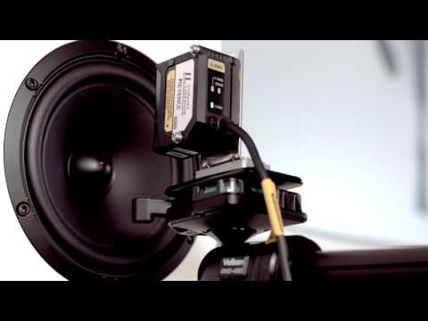

SAM is not room depending. They are measuring speaker movement.

I think you misunderstand SAM. It is about timing and bass extension. The room is a completely different thing altogether. When I read about people who don’t like SAM because it ‘muddies’ the bass, I try to explain that it’s not SAM that’s the issue.
From a practical point of view you should see SAMed speakers just as if they’re a new set of speakers; they go deeper in the bass and therefore need to be set up in the room as if you have just bought new speakers that go deeper in the bass.
When you start to use SAM and you have adjusted where you set your speakers up, then, if you want to do room correction, go ahead. Just don’t get SAM confused with room correction or think SAMed speakers should automatically sound better in the same room and position.
One thing I can say about SAM. It’s not a gimmick. It’s really clever and it makes an already good sounding amplifier sound even better, given proper speaker setup.

I’m curious about the technology here. As a concept I’m viewing SAM as “speaker correction”. That is using correction in the amp to compensate for known speaker characteristics, similar to headphone correction. Room correction could/should be layered on top depending on your viewpoint. At least you’re starting with a better behaved speaker.
Here are some details about SAM and his effect on speaker bass performance:
Hah, I’d read that but was looking to summarise the marketing hype and clarify the concepts. TBF it would have been a good idea to publish the link, thanks.
Yep, that’s about it.

The speakers are Monitor Audio MA-201 from around 1990. They are heavily modified so when I got them measured for SAM in 2017 the SAM profile was sent to me on e-mail. The speaker is not part of the online data base as the changes I’d done made them too different from the standard model. Even though the speakers were cheap (around 200 GBP for the pair in 1990) I got them to sound rather wonderful. The SAM profile did remarkable things too.
I am not using the speakers at the moment as I sold my Devialet amp early 2020. I do miss both
that’s what I need to know, how do or did you get them measured, I’d love to get a profile for the Thiel CS2.4 speakers.
