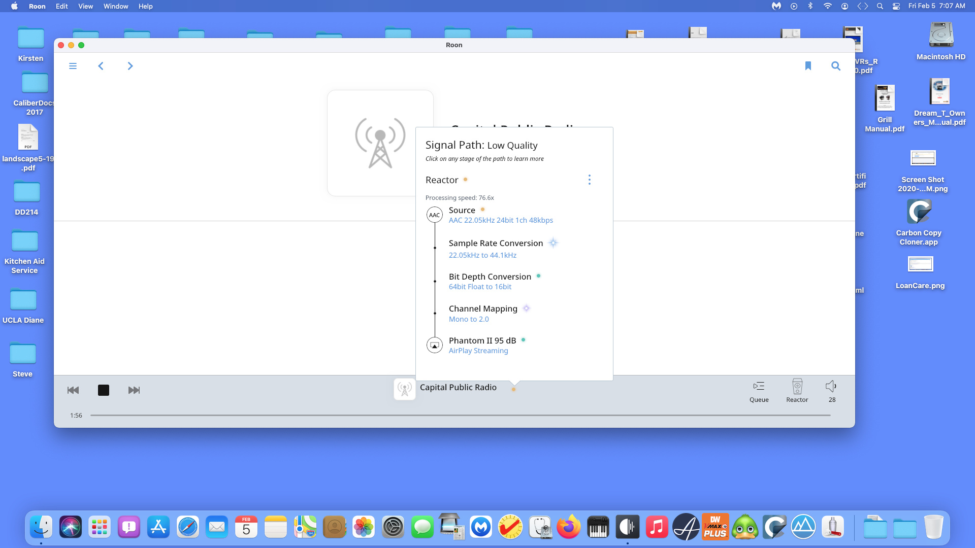

Hello Vincent. I am a Reactor user with Roon. I see you have an amplifier in your chain which is confusing to me. If the Roon Core is on a computer then there should be no additional amp in the chain. If you are using Air Play then that may be setting the limit on the resolution. Am I confused?
The Unknown DSP and Unknown Amplifier is internal to Phantom I. DSP is probably digital x-over and SAM, amplifier is the three ADH amps driving bass, mid and treble.

I’m still a bit confused. I know our equipment is a bit different but my flow chart ism I can call it that doesn’t have so many items. I’ll include a screen shot. Maybe the difference between Silver and Reactor?
Regards,
Guy
It’s perhaps because you use a lossy mono file, Roon convert it and then swap it to stereo before sending it to your Phantom
