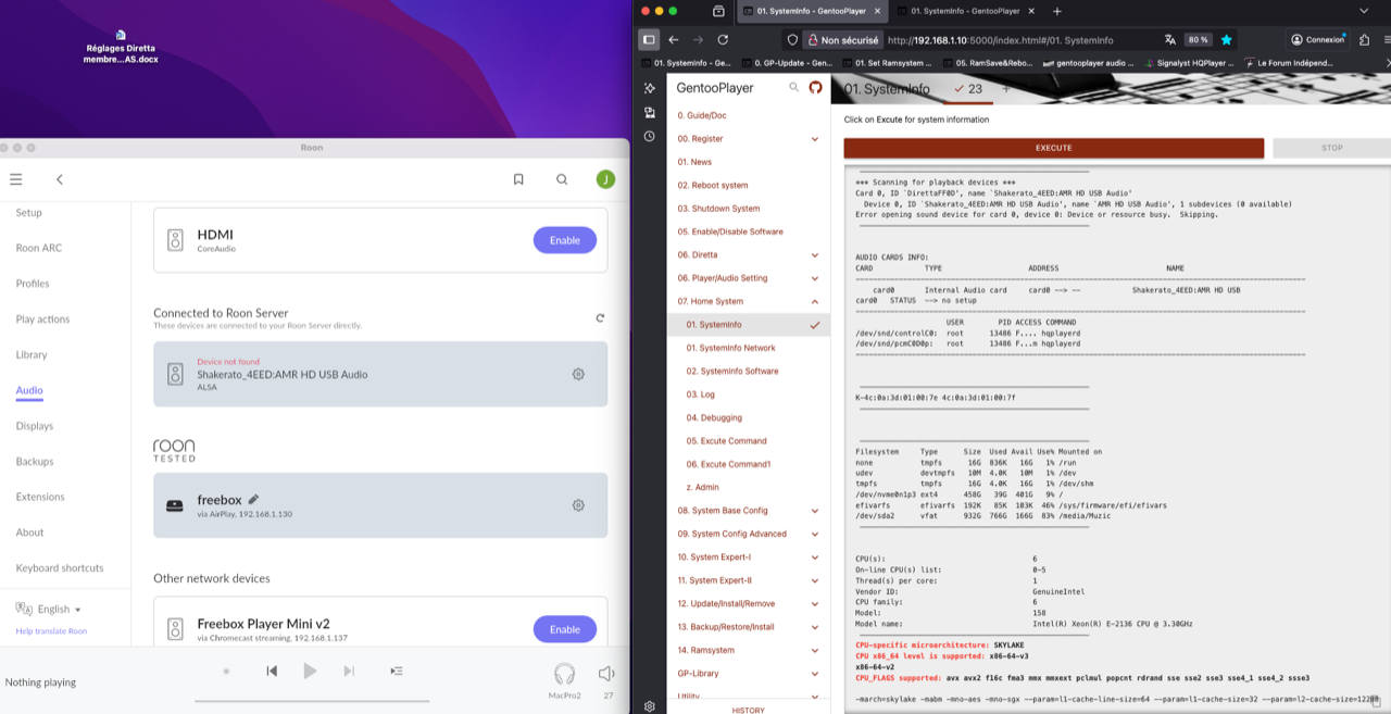

· As i said since last Roon update : 2,53 (build 1544)
· Diretta device USB
Device usually connected to ROON SERVER (and works well) now "not found "
I use Gentoo player on PC and Diretta device.
It doesn't work since i made the update.
Diretta device works well directly (Diretta Memory Play Controller), but not with ROON.
I can send screenshots...
Thanks in advance.

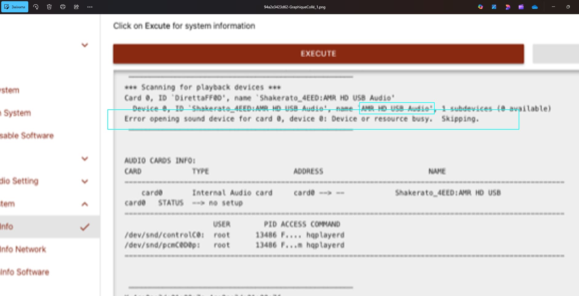

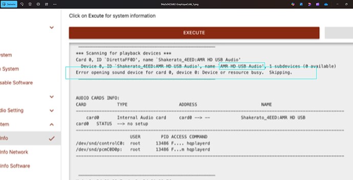

Hello @Jean-Bernard_Massonn,
In your Gentoo player diagnostic data, we see the same error as in Roon, that the Device is busy. So, most probably, some applications hold the Device in the exclusive mode.
If it’s working with the Diretta, it’s worth checking if any Exclusive mode settings may be disabled.

The screen shot was made as i was playing music wu-ith Diretta Memory Play, that’s why it was busy.
Her is the complete System info.

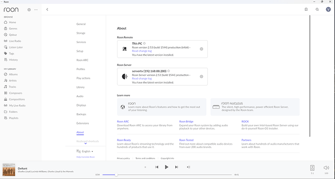

Would you kindly share the screenshot of the About window under the Roon-> Settings?
Your stack trace shows the same error as we see in the screenshot, that the device is busy.
I wonder if this is a normal message, but I’ll check.
Sorry, i don’t understand the window you are asking ? In Roon App ? in GP ?
Directly in the Roon application
