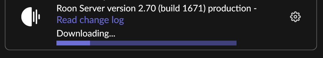

I tried updating Roon Server again today for the latest release and it failed again. The first image shows where the download got stuck. Note that it reached this point quickly (as usual) and then it just stops. The second image shows what happens after it gives up eventually.
Note that I have uploaded the latest Roon Server logs from my sonicTransporter.

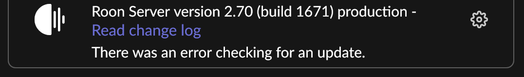

After trying another of couple of times to update Roon Server from my Roon Remote app on macOS, (several hours later) I tried to initiate the update from the just-updated Roon Remote on iOS and it worked from the first attempt. I have no idea if this was just coincidental or a fluke, but just sharing what happened.
