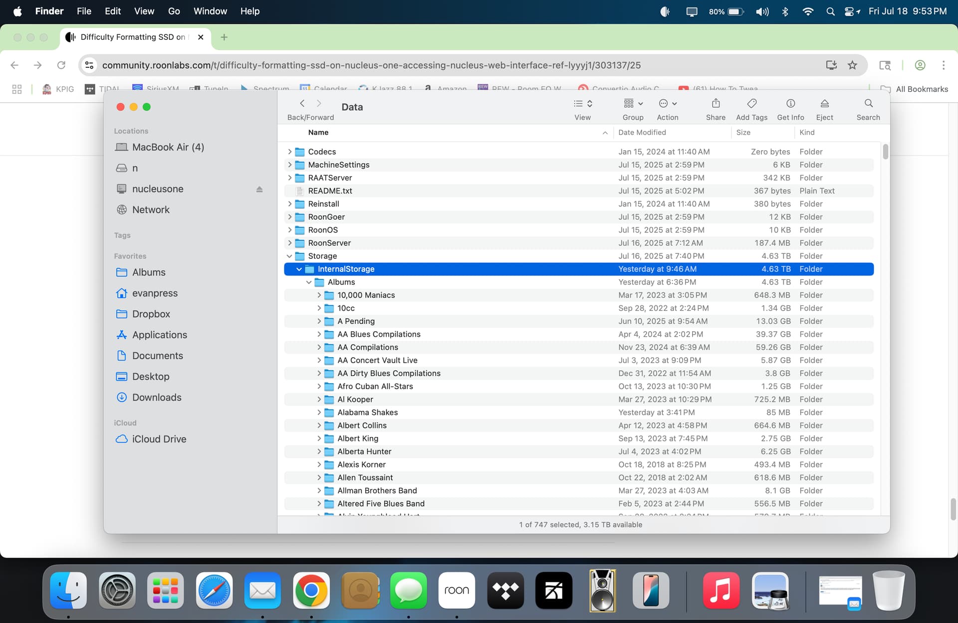

That’s because you seem to have copied your files into the Data folder on the Nucleus instead of into the Data\Storage\InternalStorage folder.
The Data folder is on the m.2 SSD of the Nucleus, which holds the Roon operating system and the Roon Server software. It must not be used to hold music files and folders.
Please delete all your music files and folders from the m.2 SSD and then copy them into the correct destination.

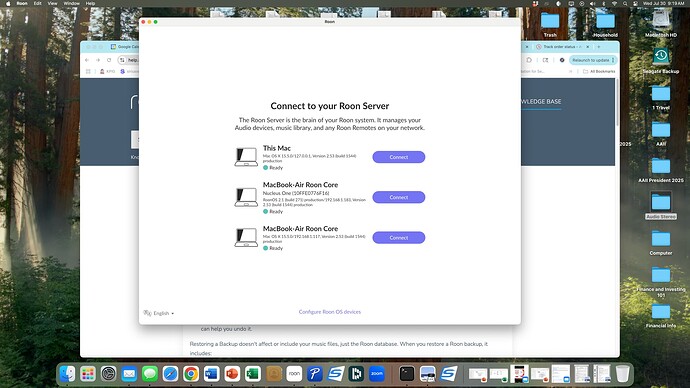

I set up my Nucleus One, transferred my music files from the former Core, AirBook, to the Nucleus One. Next step was to follow the instructions to Restore from a Backup. I copied my last backup onto a flashdrive and inserted that into the Nucleus. I opened Roon, Settings>Restore, found the last backup from the MacBook Air, clicked Restore, confirmed, when done I clicked Launch. NOW I am back on my MacBook Air, no sign of my Nucleus.
What happened? How do I fix this?
Because you restored the backup from the MacBook Air on to the Nucleus One, the database has the name of the MacBook Air. Look at your screenshot, the second entry shows the Nucleus One Roon Server (with the name of the MacBook Air).
Connect to it, and then in Roon go to :gear: > Setup and change the Roon Server name to something more sensible…
Hi @Evan_Press,
@Geoff_Coupe is correct - the Nucleus One simply shares the name of the database you originally hsoted on the Mac.
We sent over instructions in your other thread here for how to deeply delete the version of the database hosted on the Macbook Air (or at least prevent it from launching on startup).
Provided you change the name of the server on the Nucleus as Geoff advised in the post above, you should then be left with the Nucleus One as the visible, primary RoonServer in this network.
