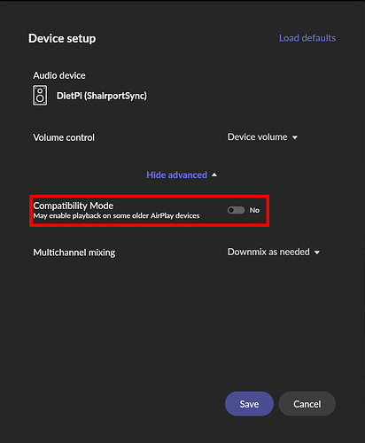

Thanks for reaching out. Can you please try to toggle Device Setup → Airplay compatibility mode for the problematic zones and let us know if this helps with the issue?
Hello! It did not help. The only change I noted was with that mode off, the play button came back after like 6-8 seconds and with compatibility mode switched on, the pause button stayed on indefinitely (but play never did start)

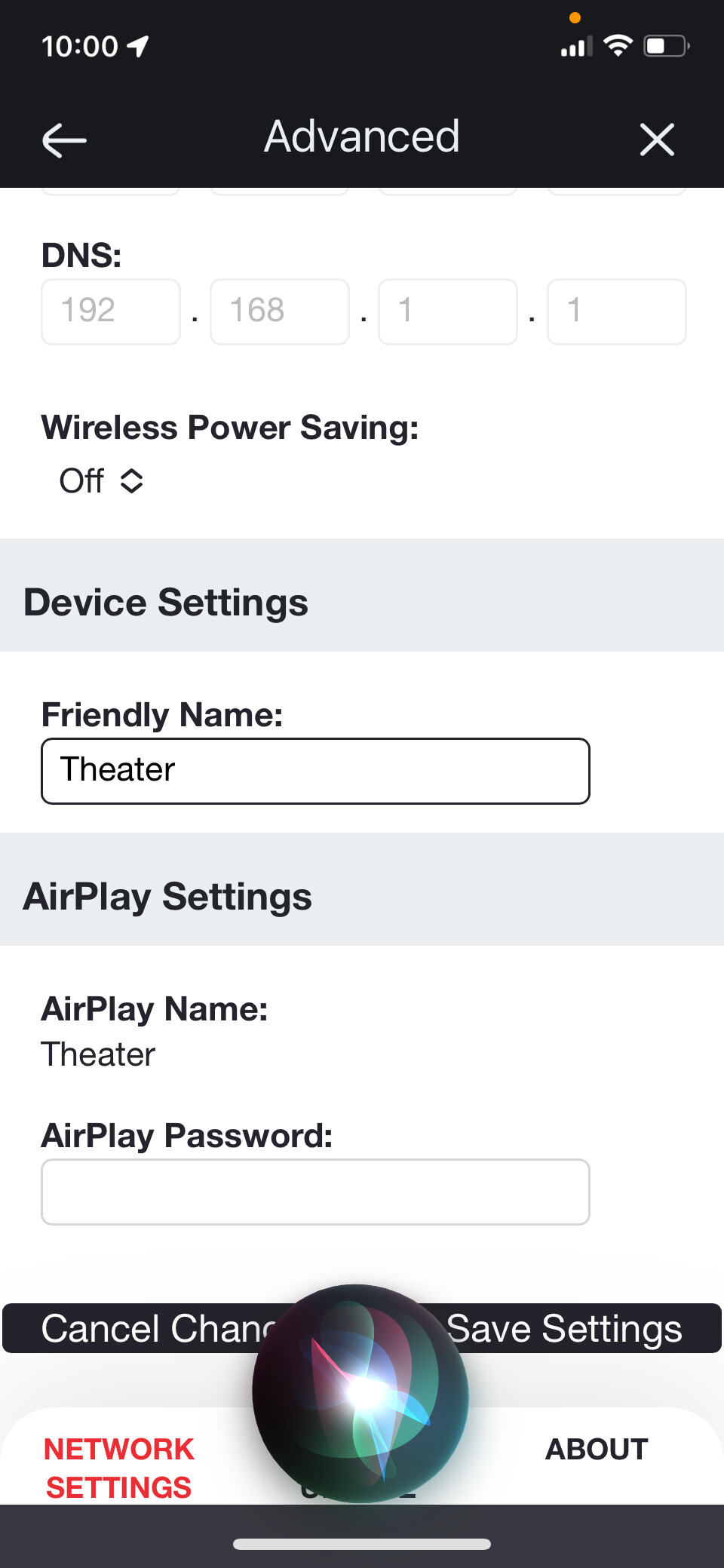

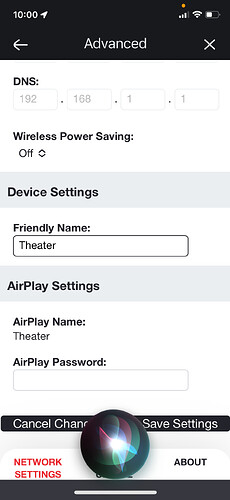

In the advanced settings for the device there’s the ability to use an airplay password.
I don’t use airplay (other than trying to avoid conflict with RHEOS) but maybe this could help:
Hi Peter! Thanks for the thought, but yes, each time it asks for the password I apply it. Also, I can trigger the Denon to turn on and play music via HEOS app as well as Apple Music
