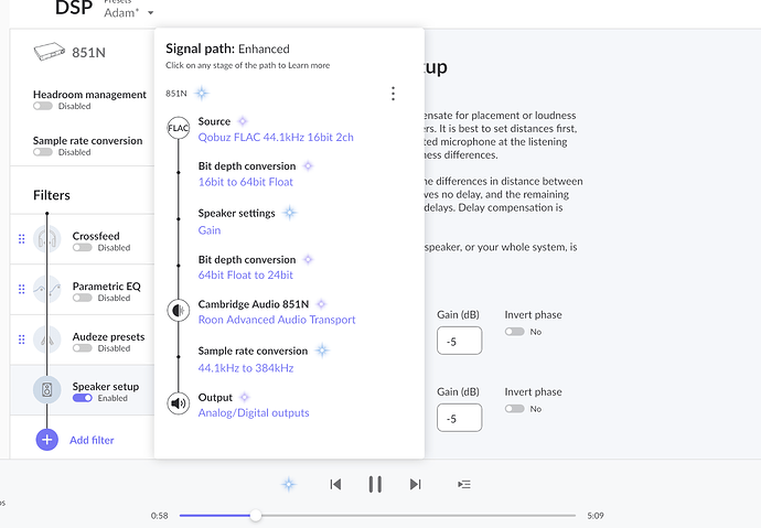

now i finded spaker setup and type type the db i want to left and right but is it possible to control with the app ore more easy but its much better than toggeling on the speakers with it´s dsp panel. Andreas
Hi how to do that. only way i tested was to adjust the eq down from 22000hz to 0 and coud adjust the volume that way. Andrteas

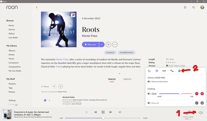

i dont have dsp volume as a option
Okay, new to me, but you’ve got device volume, which you should be able to use for your task.
does the extra conversion efeckt the quality in any way?

in short: no

now i finded it but there is no dsp volume choise if i have the dac in roon ready mode. that would I like to have someday. cause outherwise it´s the same as to have usb audio from the computer. thanks for the replies and the understanding from bad spelling. Andreas
it´s not working not using the dac in the cambridge just the digital signal in the right khz and bitrate. it´s only wen i have roon ready conection to cambridge if I use the asio i have dsp adjustment. thanks now I have a remotecontrol :slight_smile: but I prefer to use roon ready besides asio
