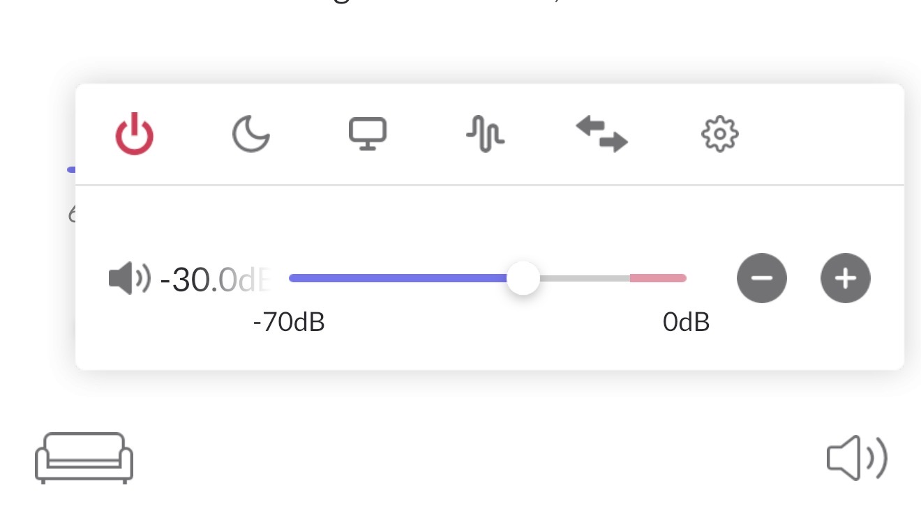

When using the Denon/Marantz remote extension, the endpoint does show an on/off status, but I guess that’s somewhat unique. Fortunately, I found a solution to the problem I’ve been having. I recently bought a new LG magic remote, paired it to the TV, and put it in a drawer as a spare. Somehow in this process I must have put the original remote in “IR always” mode, because I tried the newer remote and it works properly, with IR commands only being sent when the TV is off.
