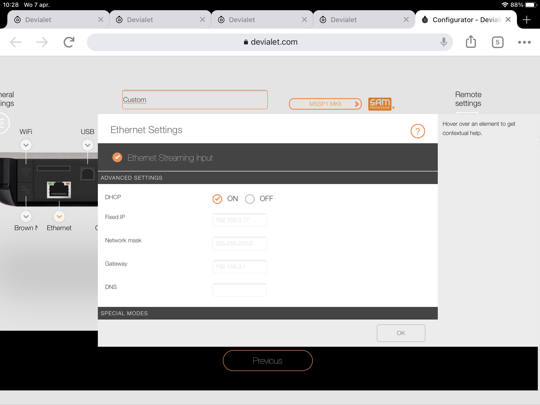

Did you try using a fixed IP and no DHCP?
