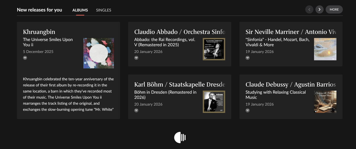

Hello @Jason_Kim,
Thanks for sharing that with us.
Do we understand correctly that the data shown in your screenshot is taking a long time to load?
If so, this behavior can sometimes be caused by packet fragmentation if the default packet size is too large for your specific network path. To test this, we recommend temporarily adjusting the MTU (Maximum Transmission Unit) on your Roon Server machine.

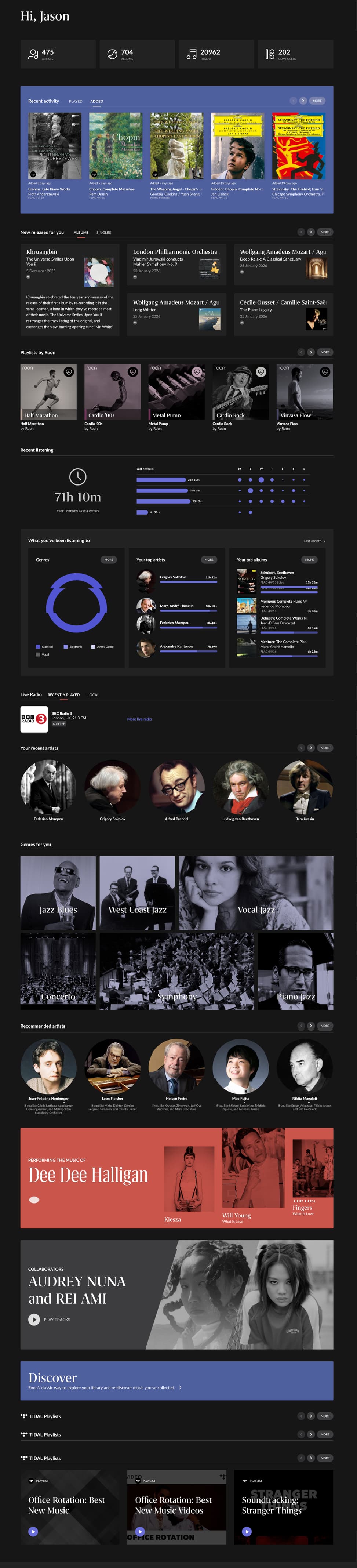

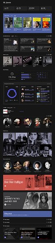

This is what I see. Not sure what other should have been here in this page.
Not sure if we can call it resolved. For now, it’s <15s but it can get worse as before. I’m gonna monitor it. Also, although it’s better then before, it’s still taking ~15s. Do you think that’s a normal latency?
