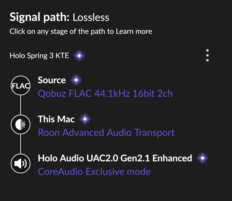

I have no DSP of any kind applied in Roon. I’ve added a screen shot of the signal path to the original post.

Enabling the “Headroom Management” with a -3dB attenuation seems to mostly resolve the issue, but it doesn’t completely solve it, and I don’t understand why any headroom attenuation at all would be required here since there is no oversampling applied, and no eq or any kind of filtration. It’s just 44.1, 16 bit trying to play lossless direct to the dac, and it doesn’t work (From Roon).
So you see clipping indications turning the signal path star red, right?
If so, -3dB only reduces occurrences and you need to decrease the value more until completely free from clipping - download my test file for proper full spectrum 0dB signal evaluation without ambiguities.
Wait … looking at the specs of your devices now, I see the Marantz input sensitivity as only 200 mV, unfortunately without specification on it‘s overload margin so not sure about max possible input level without analog clipping.
The Holo on the other hand actually puts out 2.9V RMS single ended which could possibly cause analog overload.
In this scenario you‘d get analog input clipping and your signal path star, when enabled, would never turn red, but reducing headroom also remedies that by reducing Holo‘s output.
All that said and looking at your signal path screenshot, I have no explanation for other digital sources not causing clipping occurrences.
