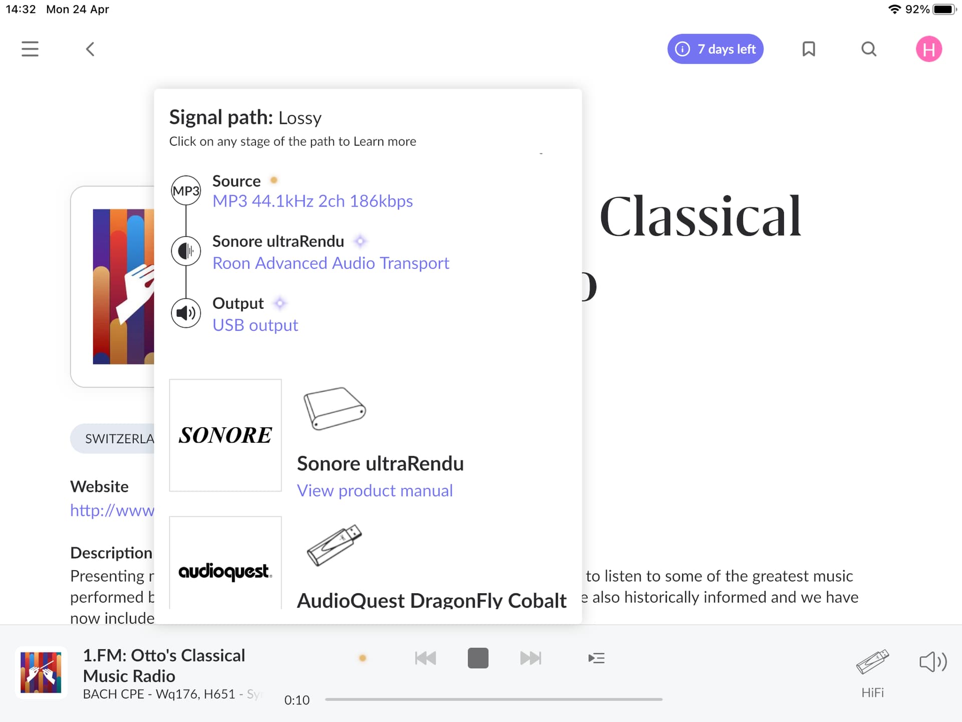

You’re not going to get clipping with no DSP active, which looking at signal path its not using any.
In the device settings for the zone you can adjust the USB buffer to see if it helps. You should not have to with a Dragonfly they are pretty plug and play. Do you only get this when using Roon from the Rendu ?

I’ve connected the Cobalt directly to the SonicTransporter, and the noises are gone. I guess the ultraRendu is defective, and I’ll get it replaced.
Here is the signal path now:
