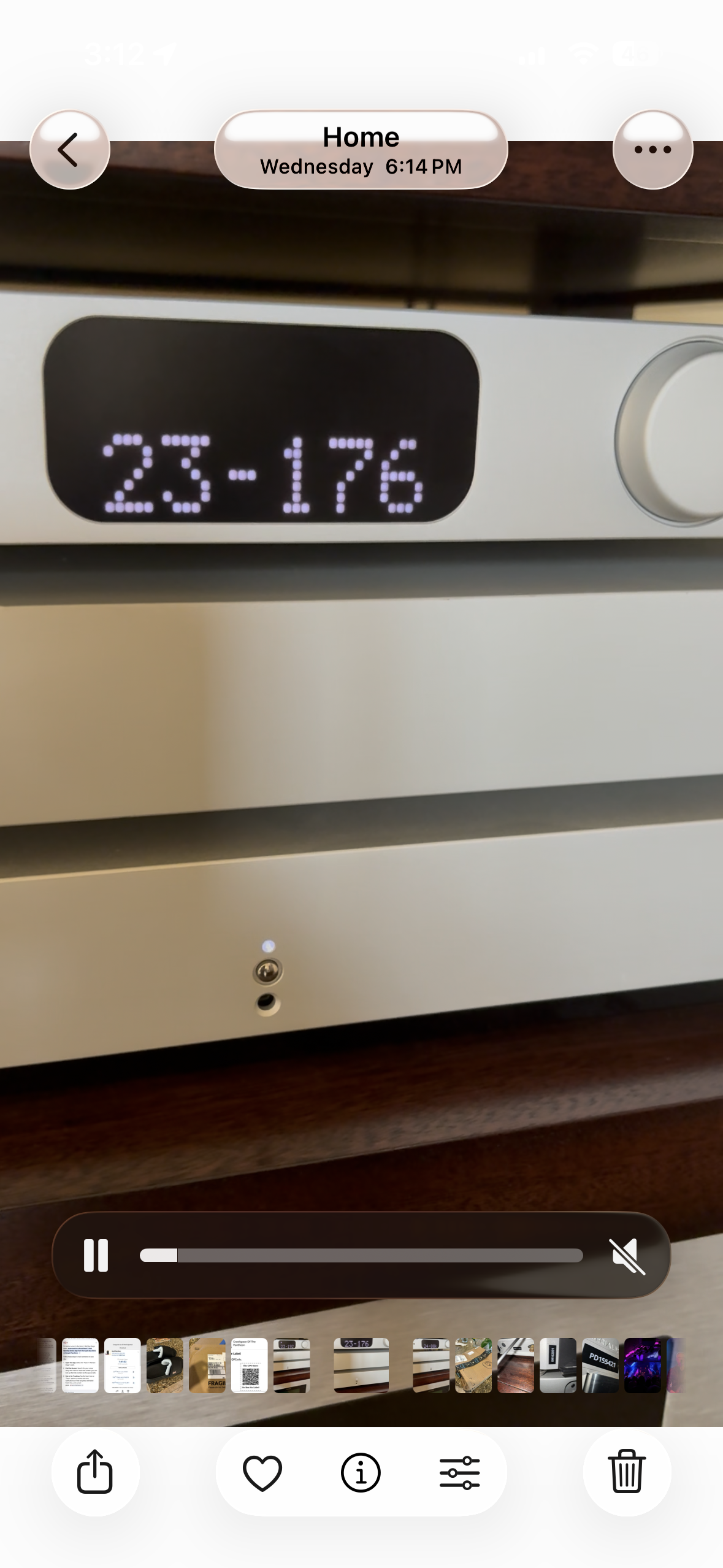

· I am experiencing distortion when trying to stream 24 bit 176.4kHz and 192kHz content from Tidal. I am using a Roon Nucleus One with a Cardas Clear USB cable to Pro USB module on my MSB Technology Premier DAC with Digital Director. The display on the MSB states 23 bit. I have no such distortion when using my Oppo Digital 203 as a Roon Endpoint connected to the Toslink input in the MSB Digital Director.

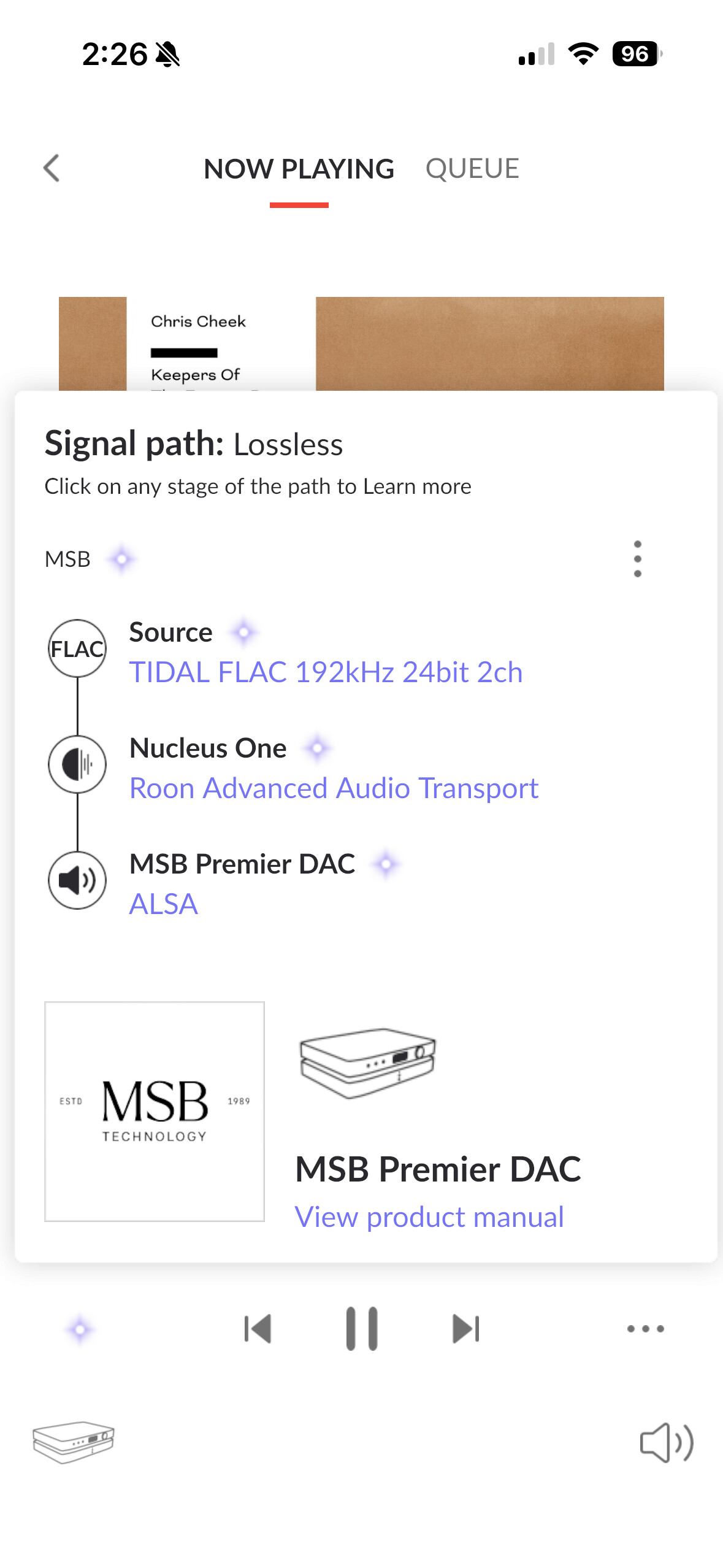

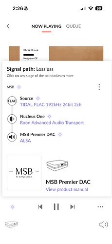

Would you kindly share the screenshot of the signal path and the timestamp when the next distortion happens?
The distortion is constant. It sounds like overload (similar to how a phono cartridge with too high of an output would overload a phonostage). I will take a screen shot of the signal path later today when I am home. Thanks!
