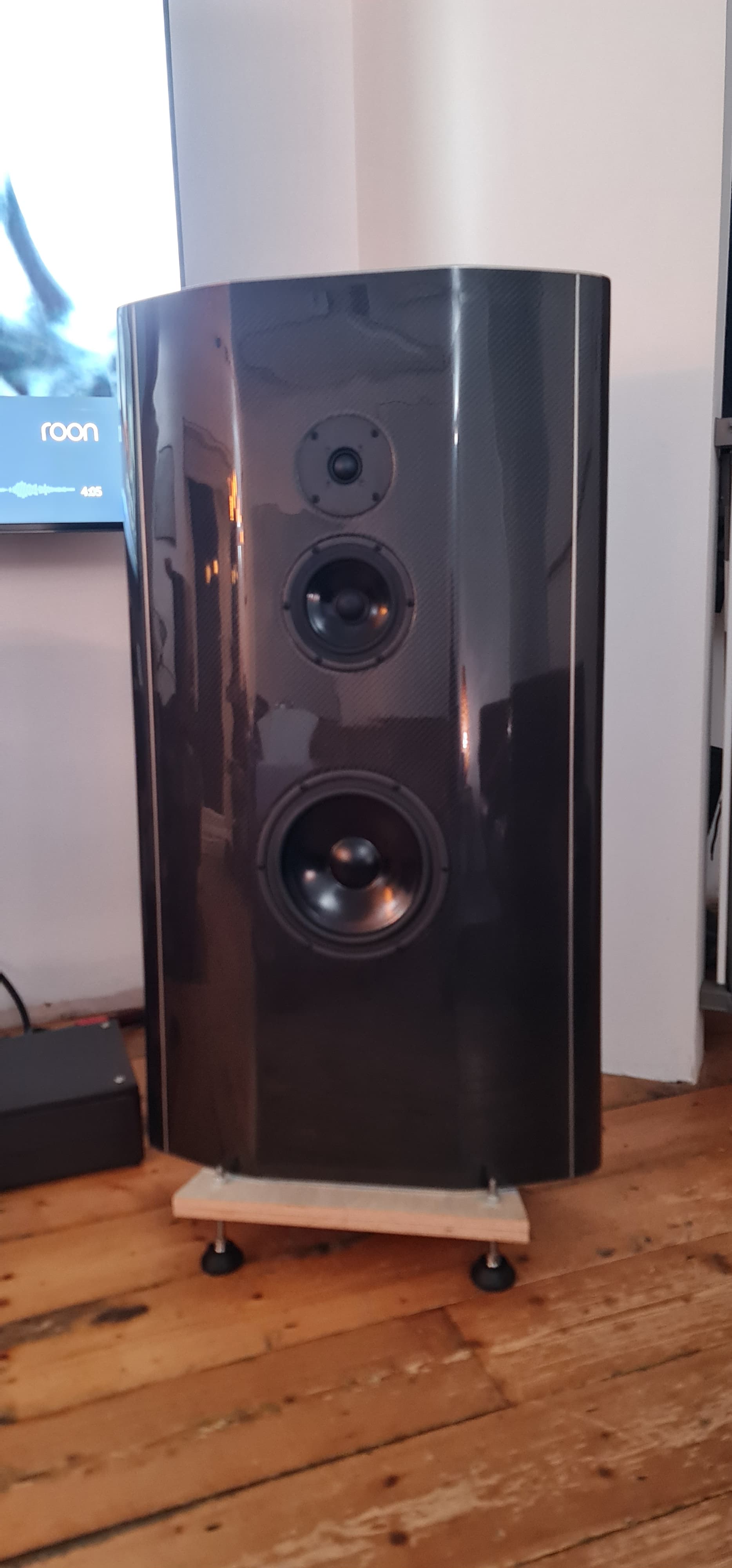

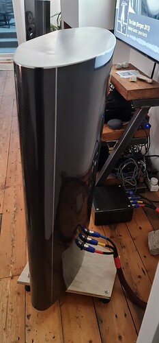

Finally, I have the second speaker finished and assembled.

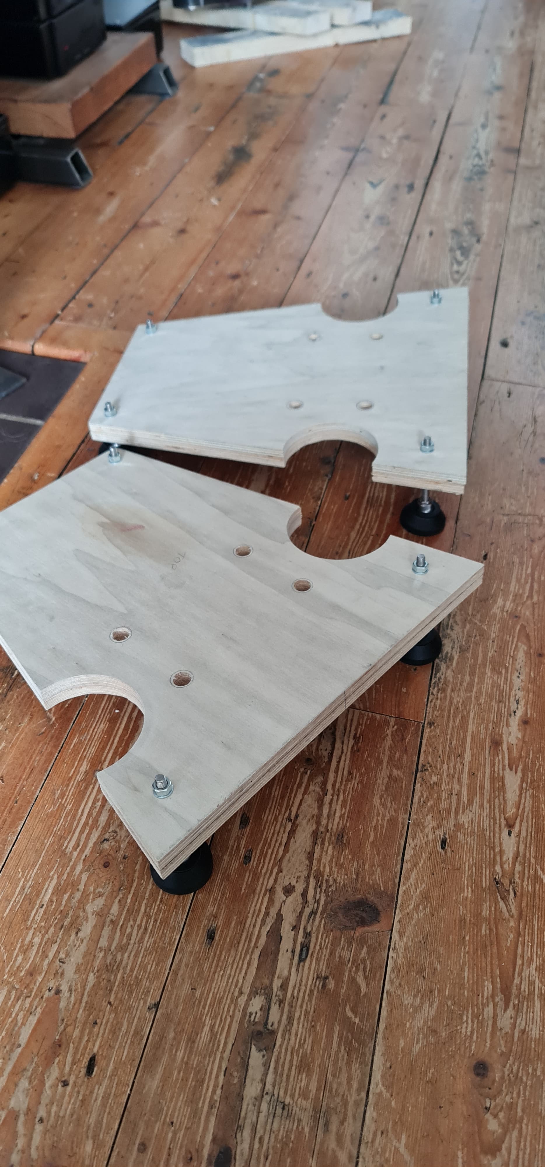

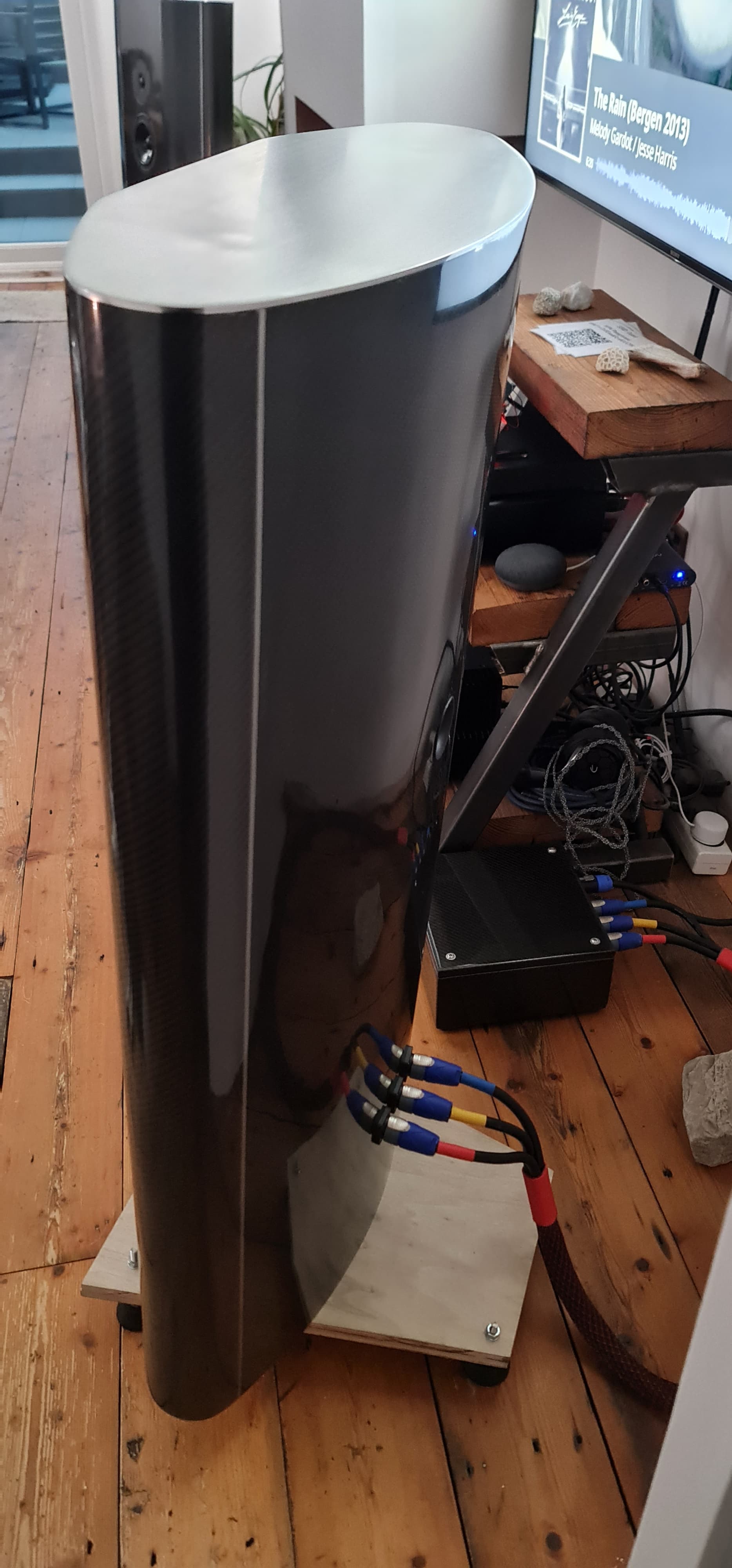

To enable me to make use of them and to free up space in the man-cave to make the stainless plinths, I’ve knocked together a pair of makeshift plinths laminated from 2 layers of poplar plywood:

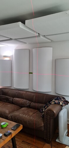

I got my geek on and set up the back-tilt, level, toe-in and distance with a digital angle-finder, laser level and laser ā€œtapeā€ measure.

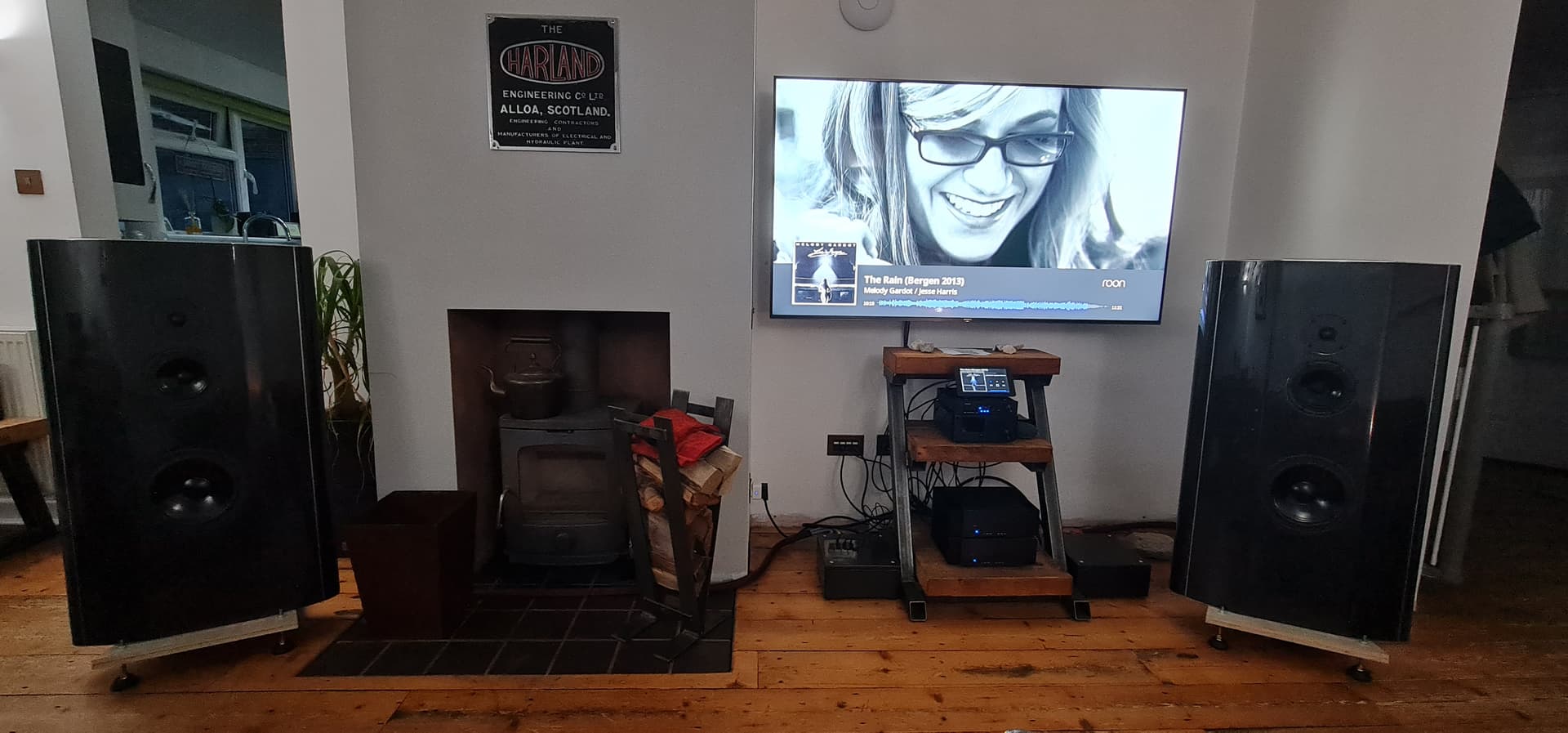

All set up and ready for listening:
Even without room equalisation, these are impressive.
Gone is the tiny sweet-spot that existed with my previous floor-standers. There’s now a huge wall-to-wall and floor-to-ceiling sound stage. Depth is impressive too.
Mid-range is detailed, yet smooth and not a hint of sibilance. Treble is light and airy, bass is fast and taught. The ambience on live recordings is amazing.
I might do some REW measurements tomorrow, though I suspect the tweaks will be minor. At the moment, I’m having too much fun.

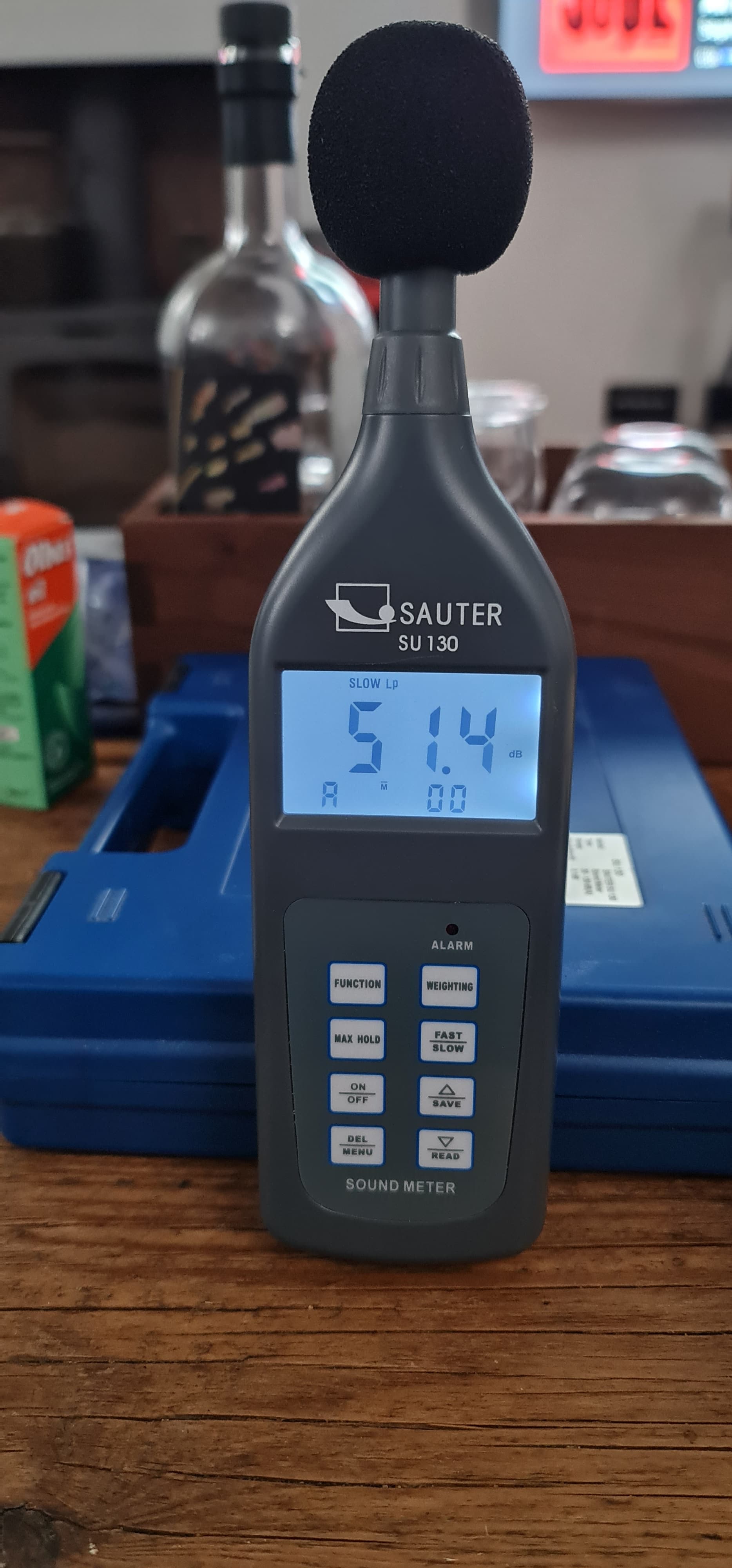

These speakers are really growing on me. Mrs Mad Scientist asked me to turn the music down (she’d gone to bed earlier to watch TV) and now wanted to go to sleep.
So I turned it down from ~ 70 dB(A) to this:
For reference, normal conversation is ~60 dB(A). Where I had to crank the standmounts to bring them to an enjoyable listening level, these just seem to sing at even very low levels. Don’t know whether it’s the wide baffle, the high-efficiency, or a combination of the two (I’ll have to ask Troels), but I’m really liking it!

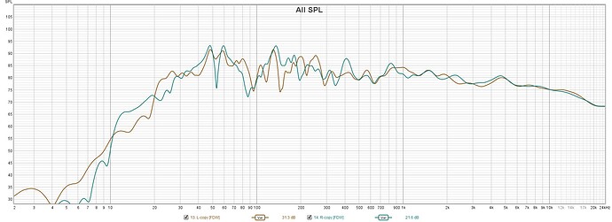

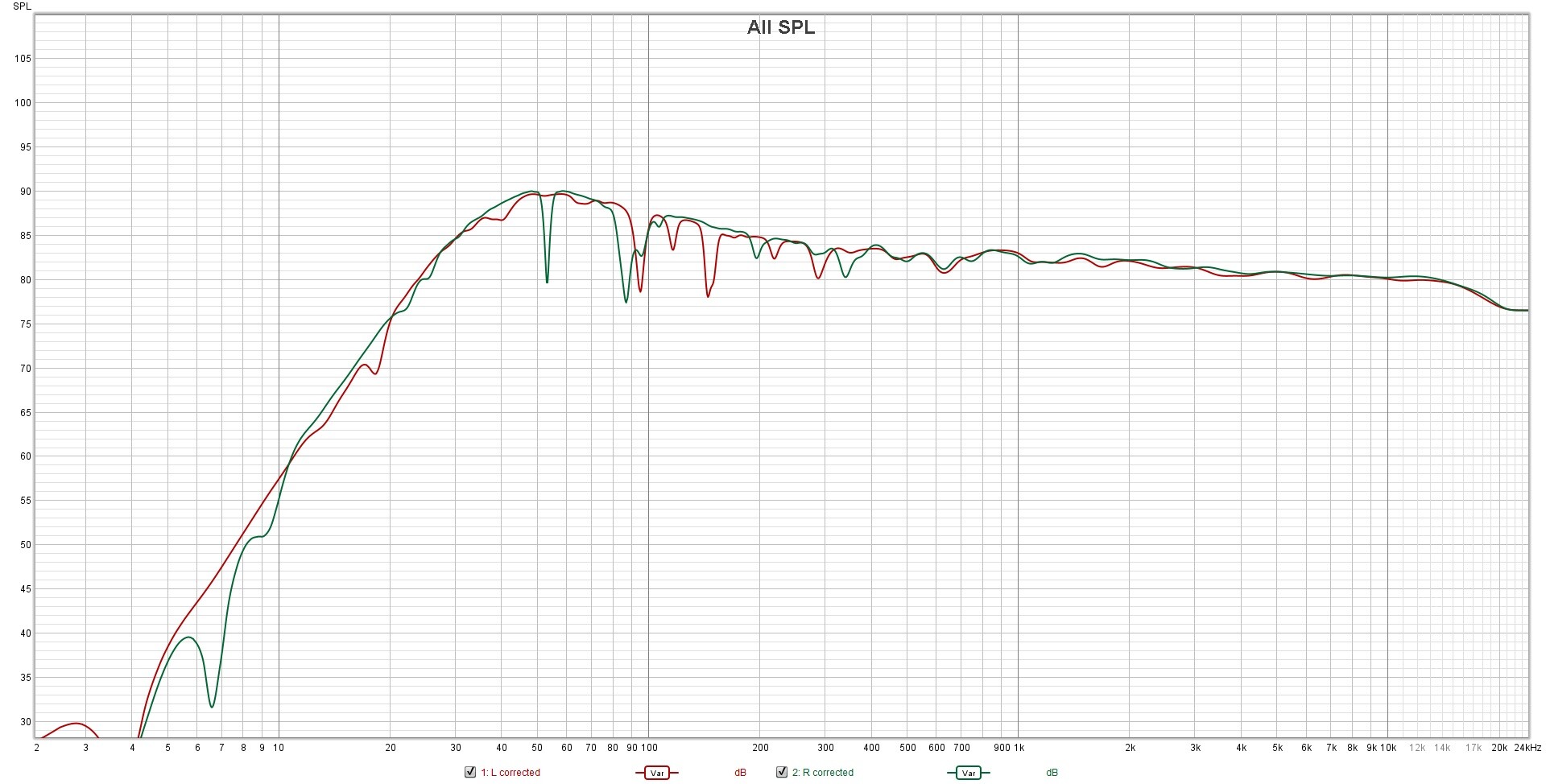

Not yet. REW FR measurement please :grinning: - VAR smoothing please.
Here ya go:
L & R measurements:
After correction using inversion:
I might do some further playing around with REW to try to improve things further (haven’t tinkered with rephase yet), but they’re sounding pretty good right now.
