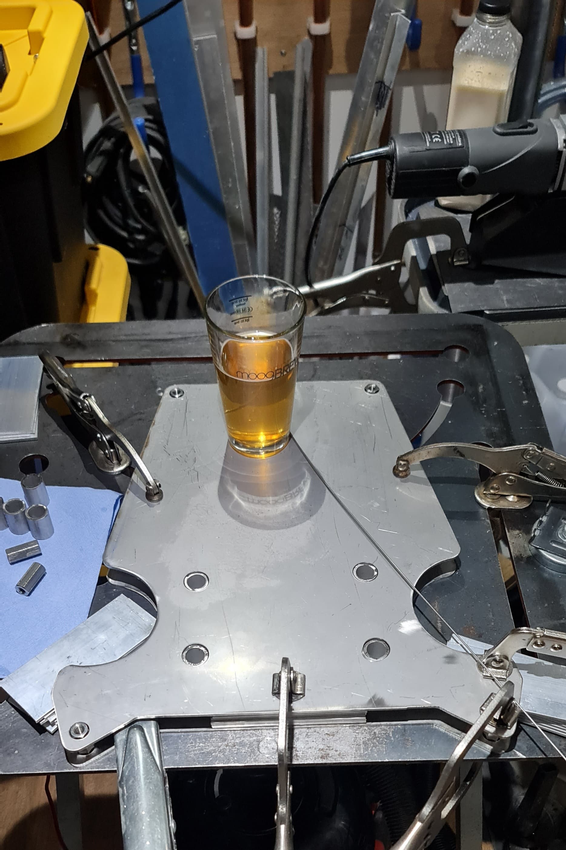

Clamped up and all ready for the first welds:
Welder lubricant is a 1/3 of a pint of Moogbrew “Pretty in Pink”, a pink peppercorn infused saison from my local micro-brewery and taproom.

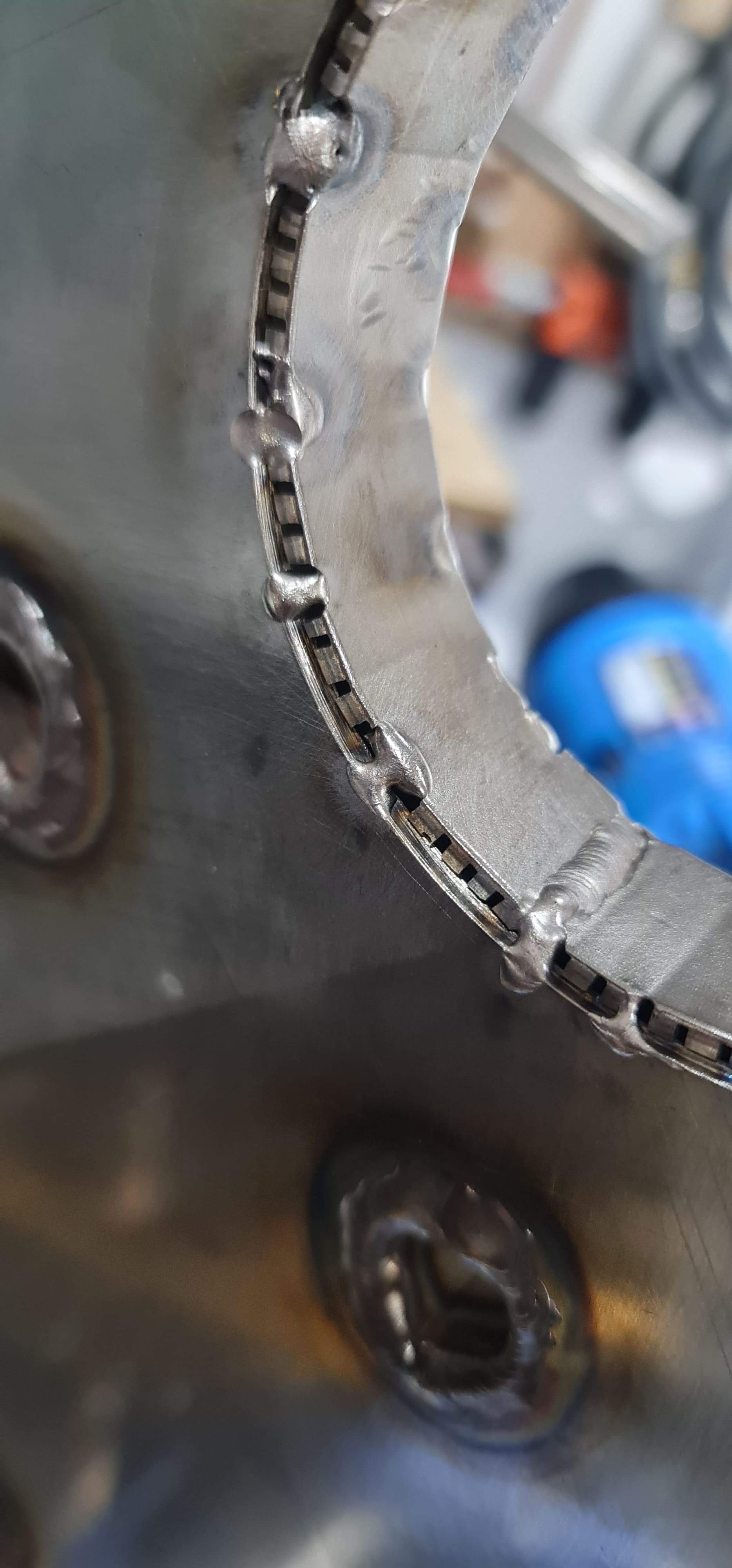

Also, as I feared, 25 x 3 mm is not so easy to bend, so I’m back to kerf cutting and bending, this time using the metal bandsaw:
Excuse the slightly ropey tack welds. I was trying to hold both the filler rod and metal in place with one hand and the TIG torch on the other. It’ll tidy up nicely when I run the weld bead.

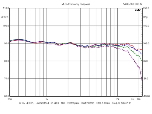

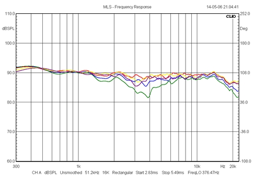

  3. Indeed, he does seem to place little emphasis on constant directivity, although generally, his measurements of horizontal and vertical dispersion aren’t bad:
PMS_V5_1mtfb_-22.3dB_horizontal-0-10-20-30_disp
Horizontal dispersion: 0, 10, 20 and 30 deg. (Red, blue, green and purple).
PMS_V5_1mtfb_-22.3dB_vertical_disp
Vertical dispersion from 1 metre distance. Starting position = between M and T = red graph. Blue = - 10 cm, green = -20 cm. Yellow = + 10 cm, purple = + 20 cm.
