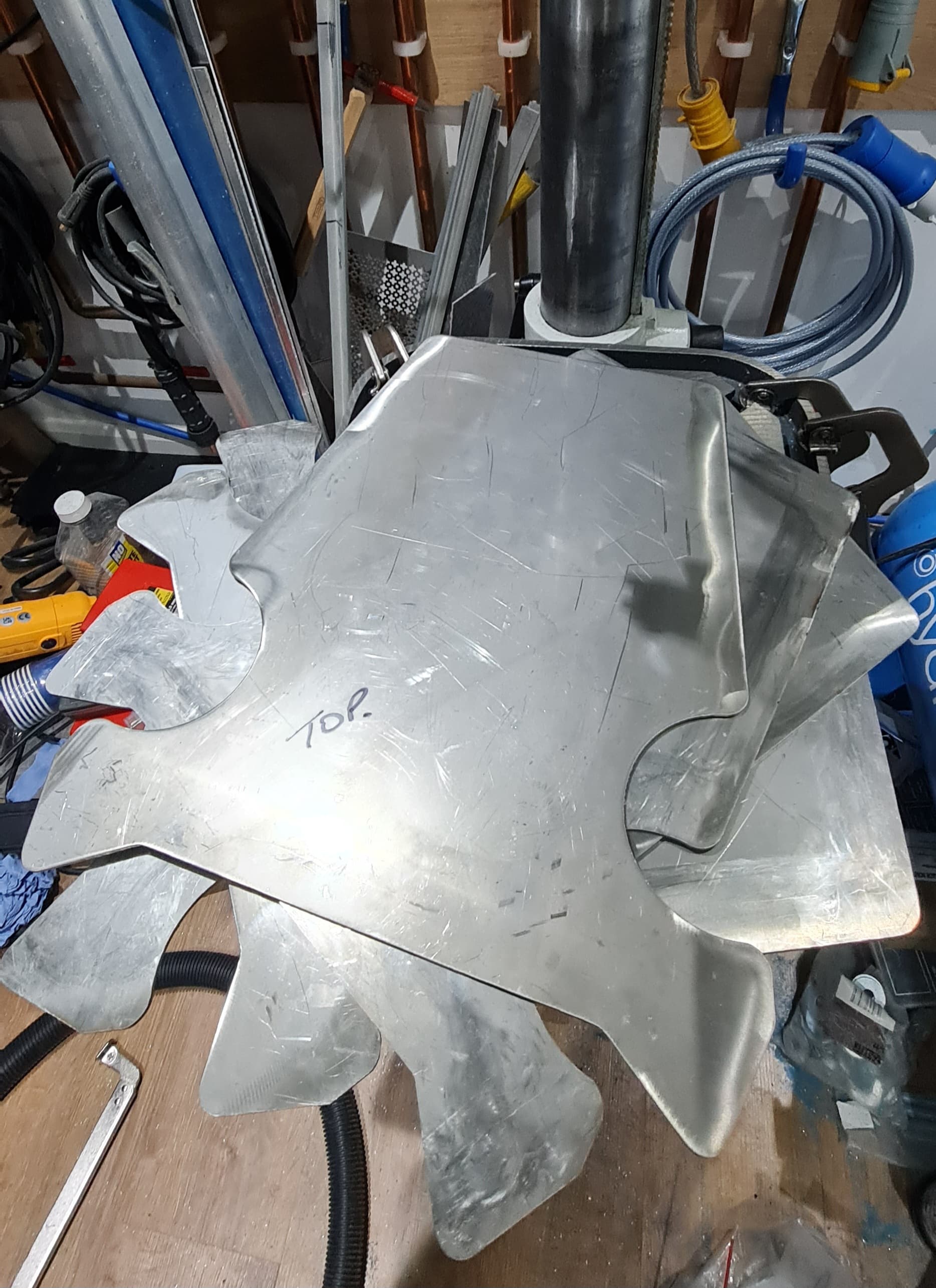

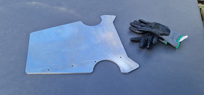

Corner radii for the template made from aluminium slugs cut out on the magdrill:
Corners trimmed and slugs removed:

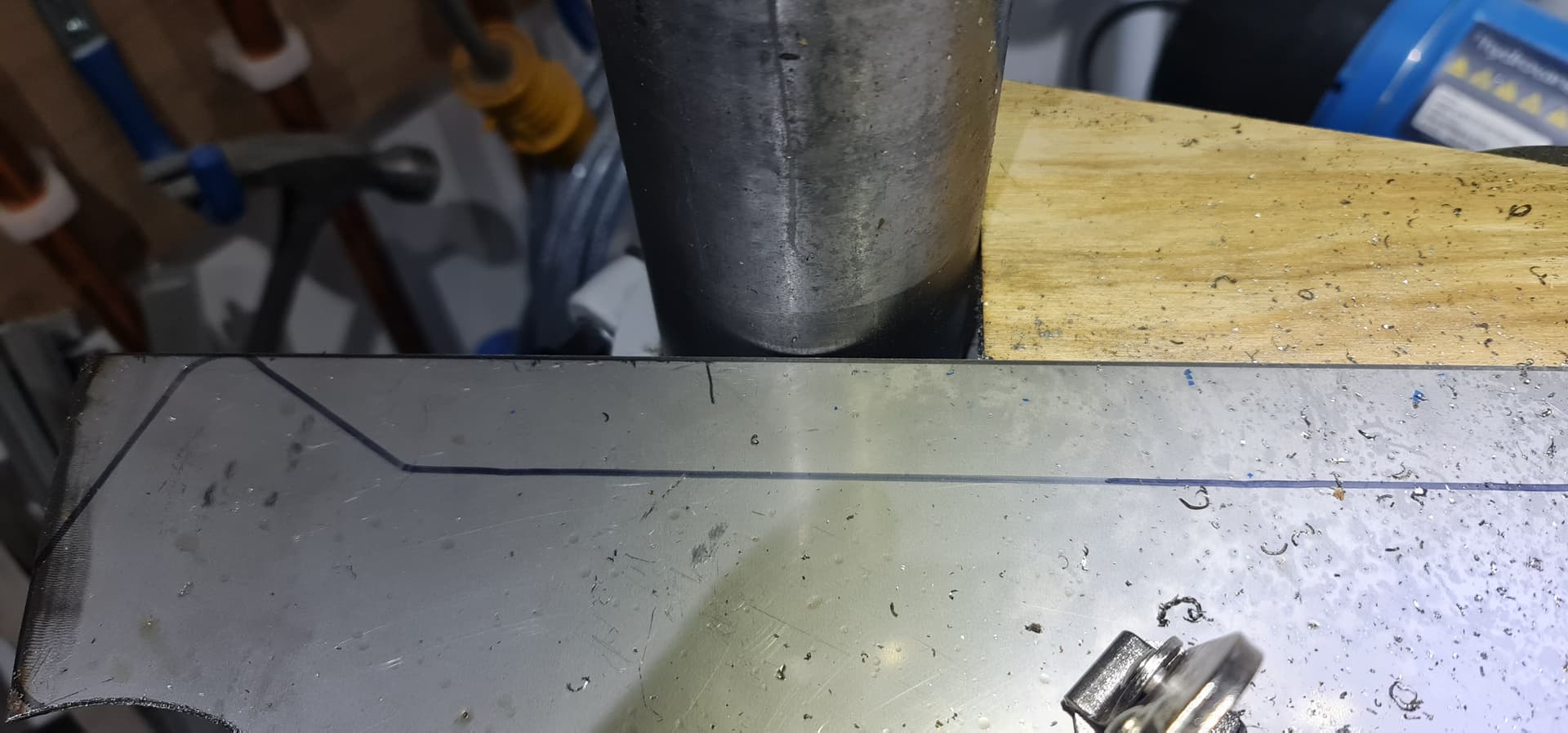

Ready to start cutting out the stainless now.
Progressing with the stainless now.

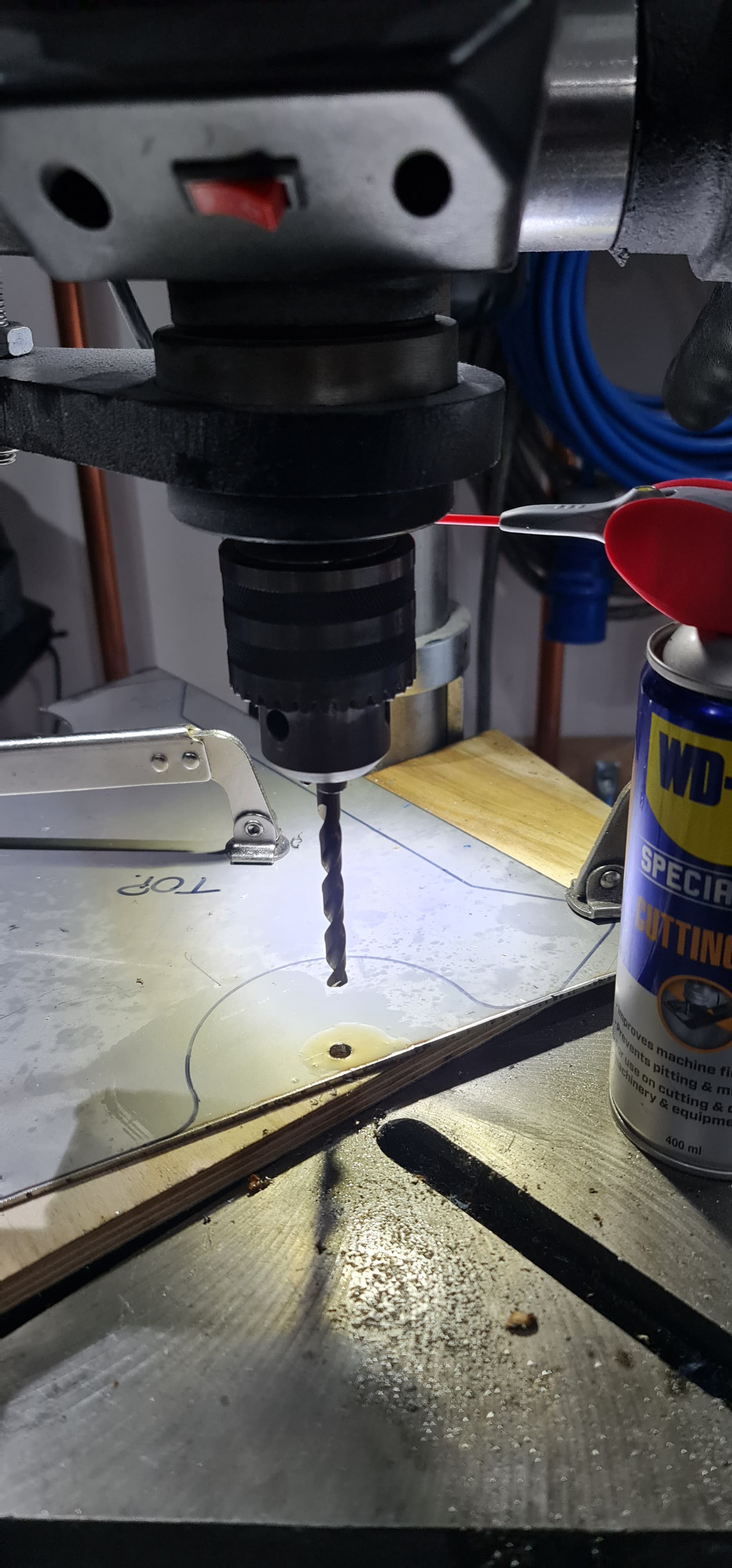

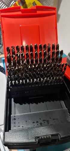

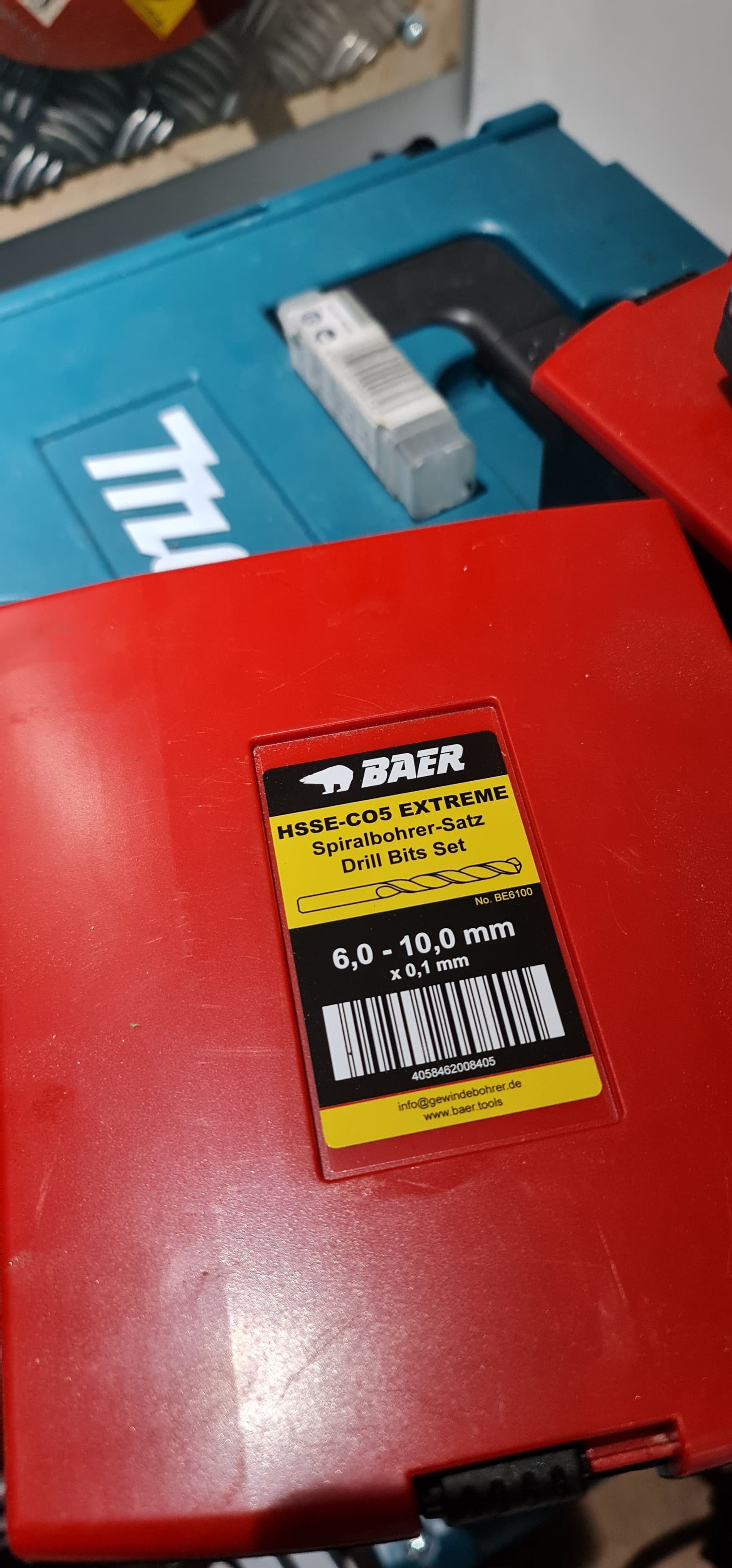

First, a 7.1 mm pilot hole with a Cobalt HSS-E drill bit.

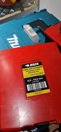

Picked up both the 1.0 to 6.0 and the 6.0 to 10.0 sets earlier this year:

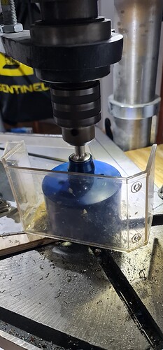

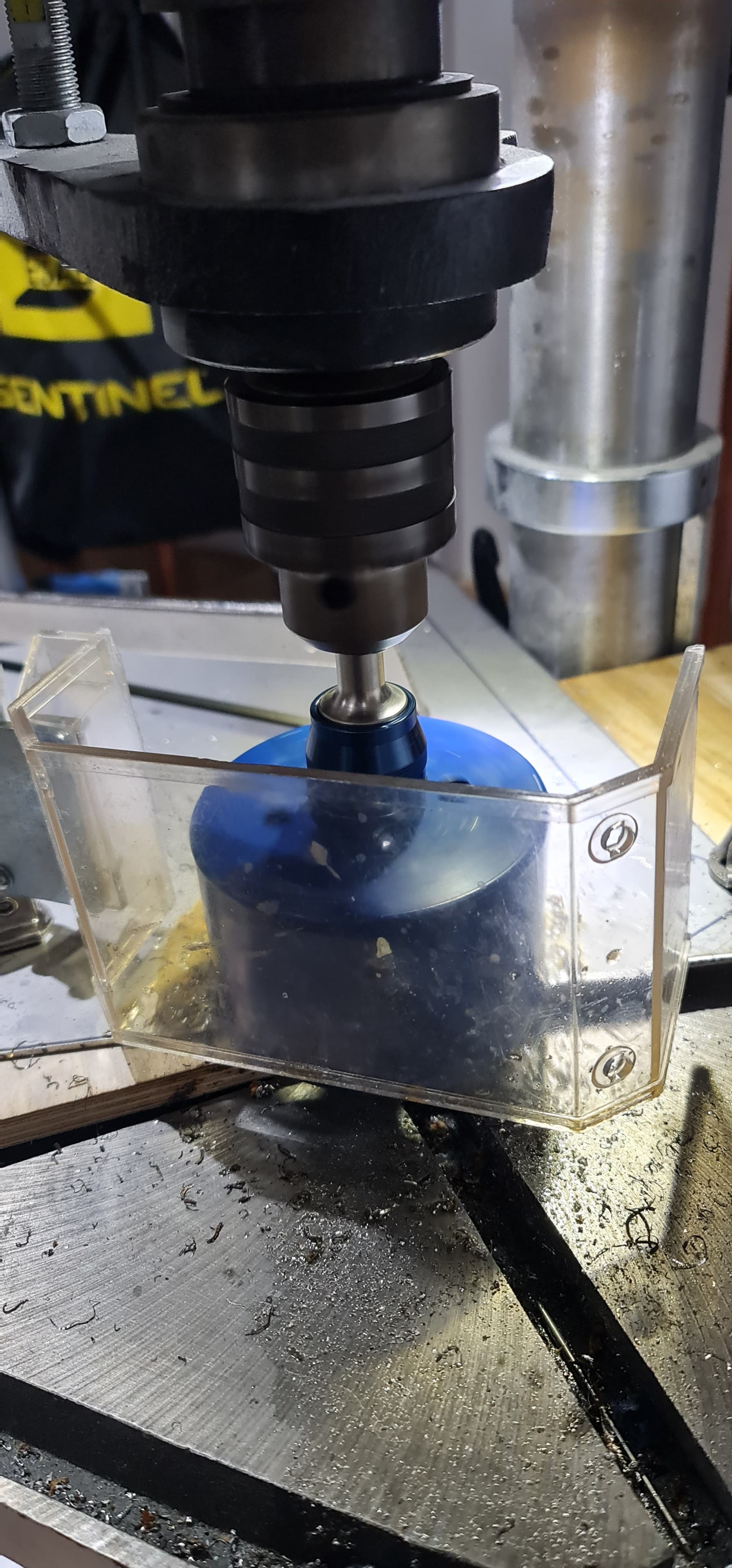

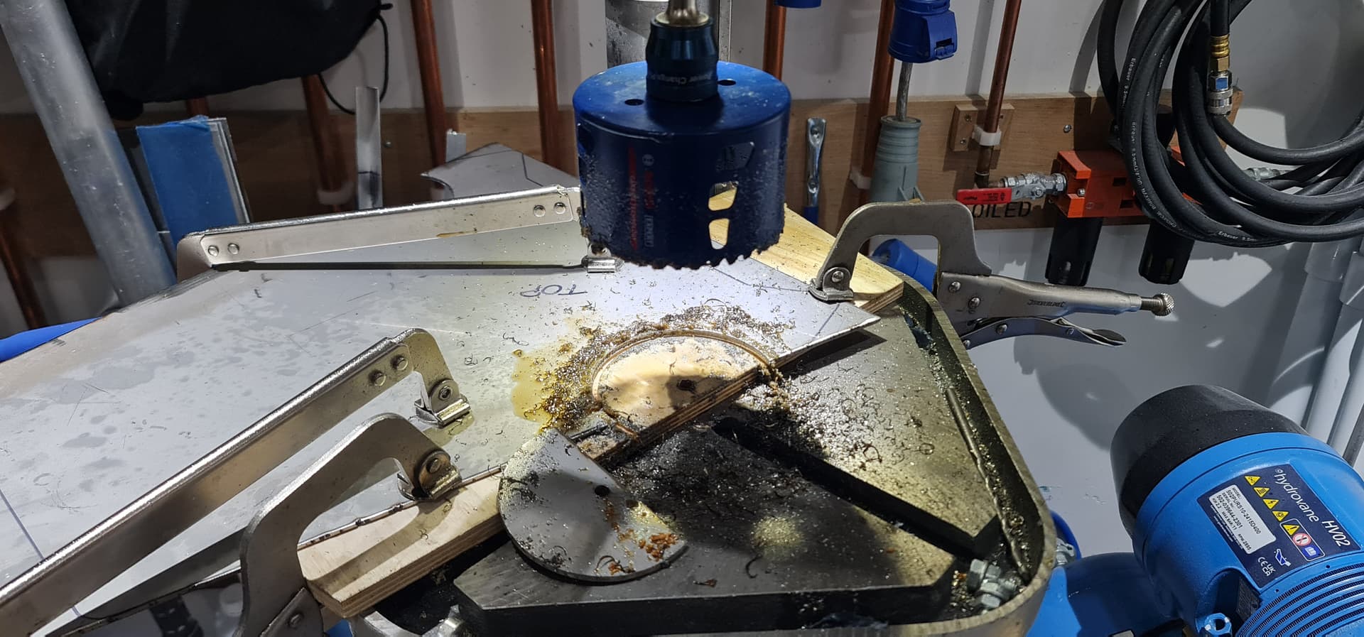

On to the holesaw next:
I’m really liking these new Bosch carbide tipped holesaws. They rip their way through stainless effortlessly.
SAFETY NOTE for the less experienced metalworkers. Using holesaws on sheet material on a drill press is potentially one of the most dangerous activities you can undertake in a home workshop. It’s vital the material is firmly clamped to the table, the table is locked in position and the material is wedged against the press’ centre column before starting to drill:
The last thing you want is a sheet of metal spinning around the table at abdominal height when you’re standing in front of it!

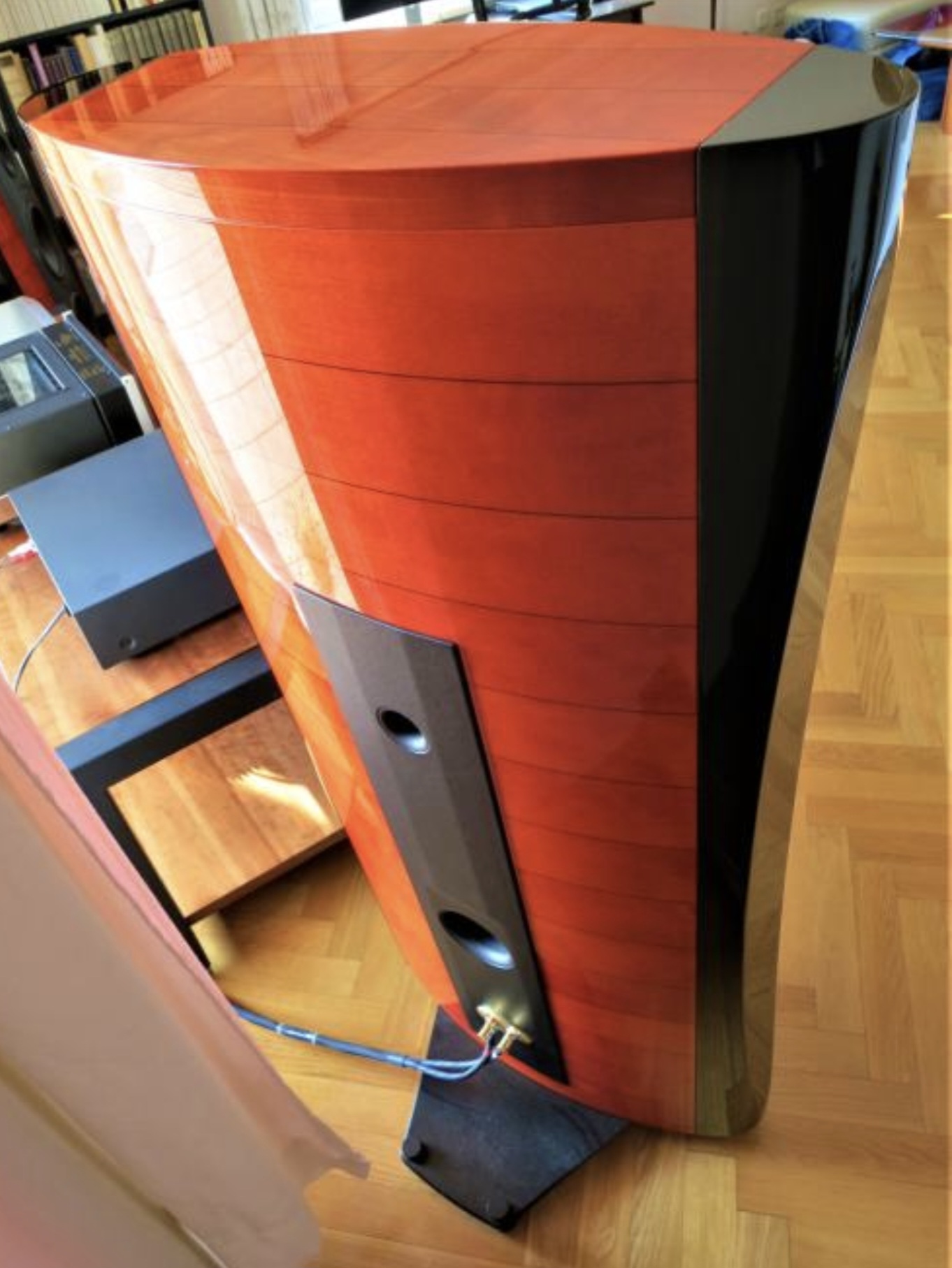

And, of course, I took some inspiration from the SF Stradivari themselves too:

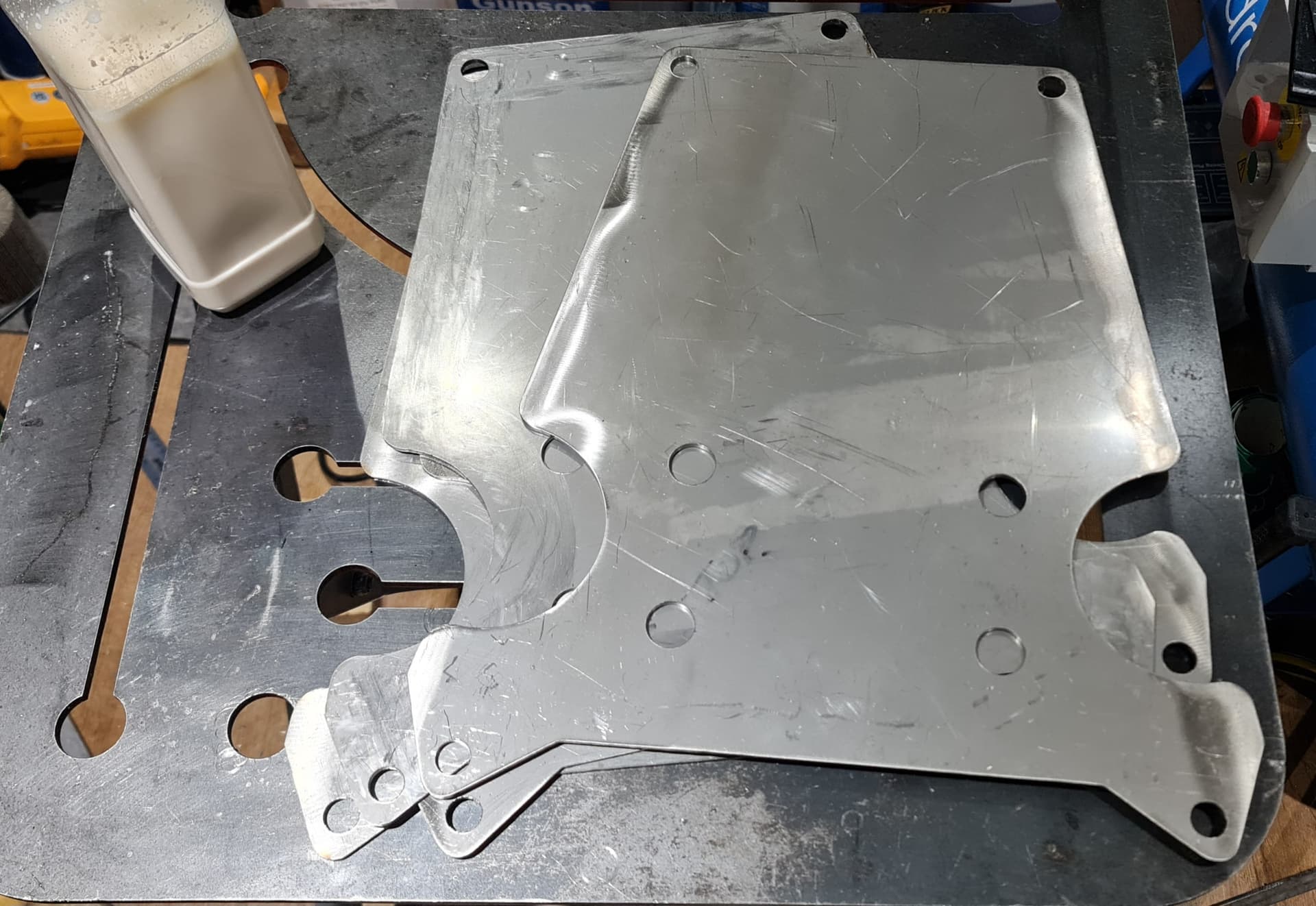

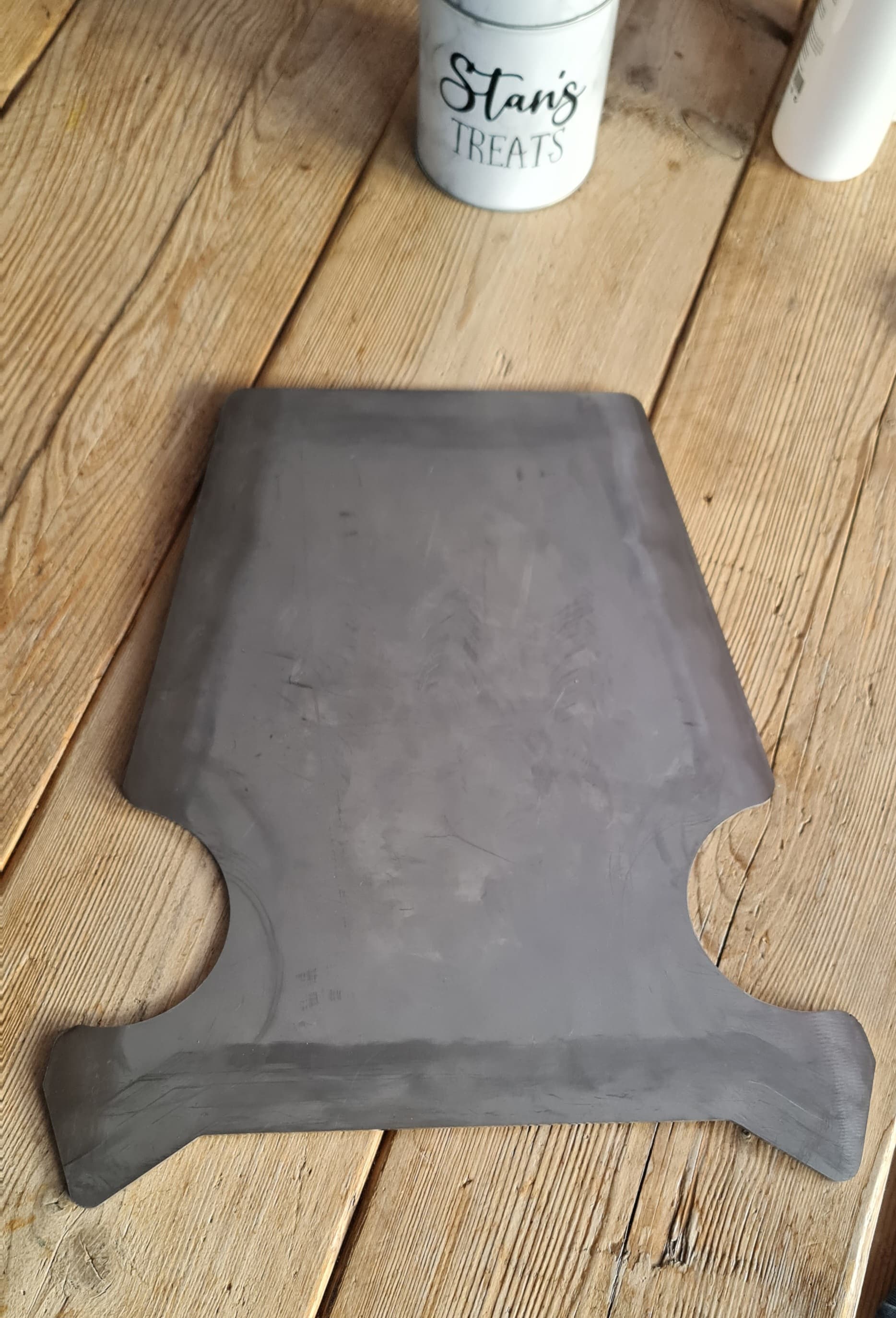

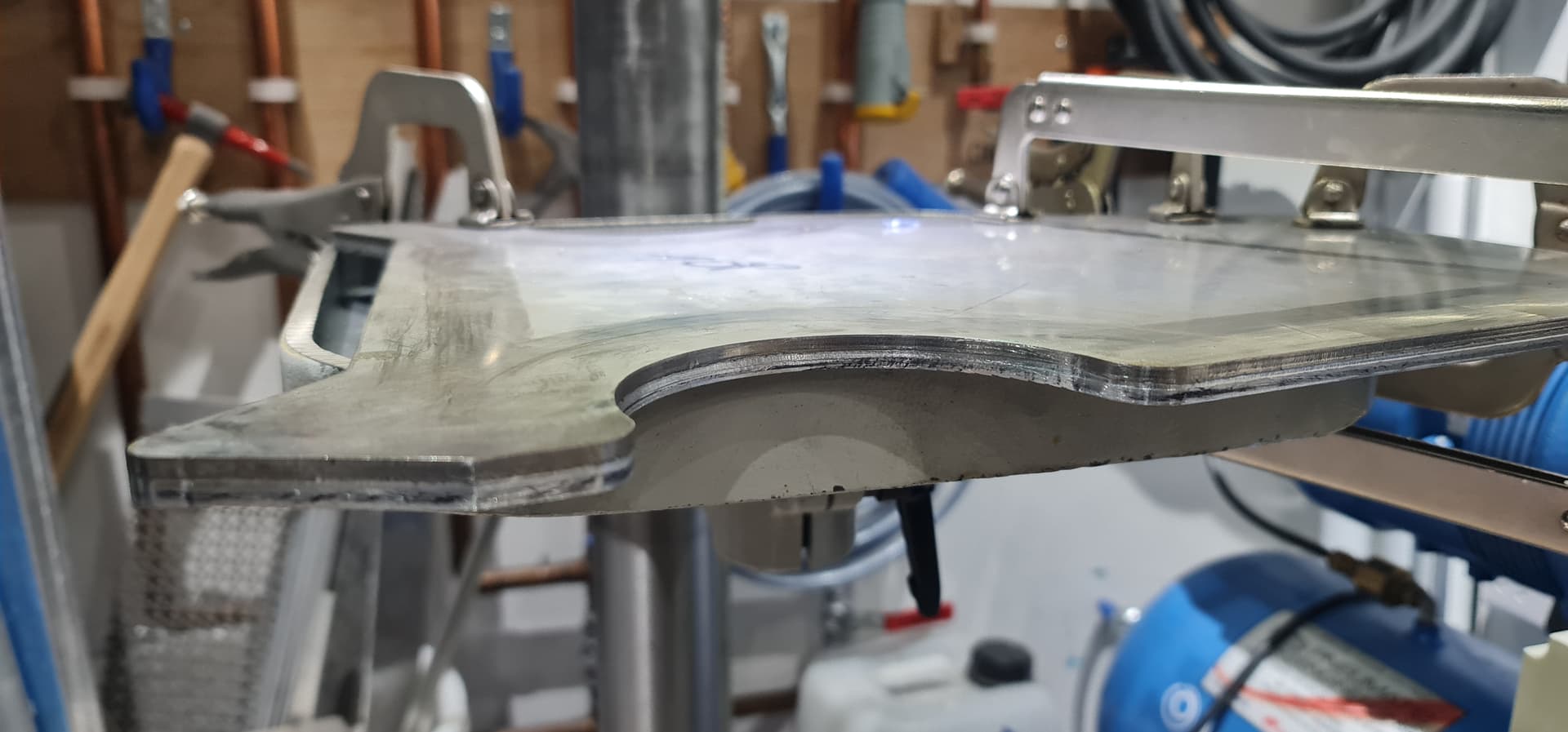

After making the holesaw cuts, I trimmed to length with a cordless metal cutting saw and then roughed the corners etc. down with a 5" grinder, leaving about 1 mm overhang all the way around.

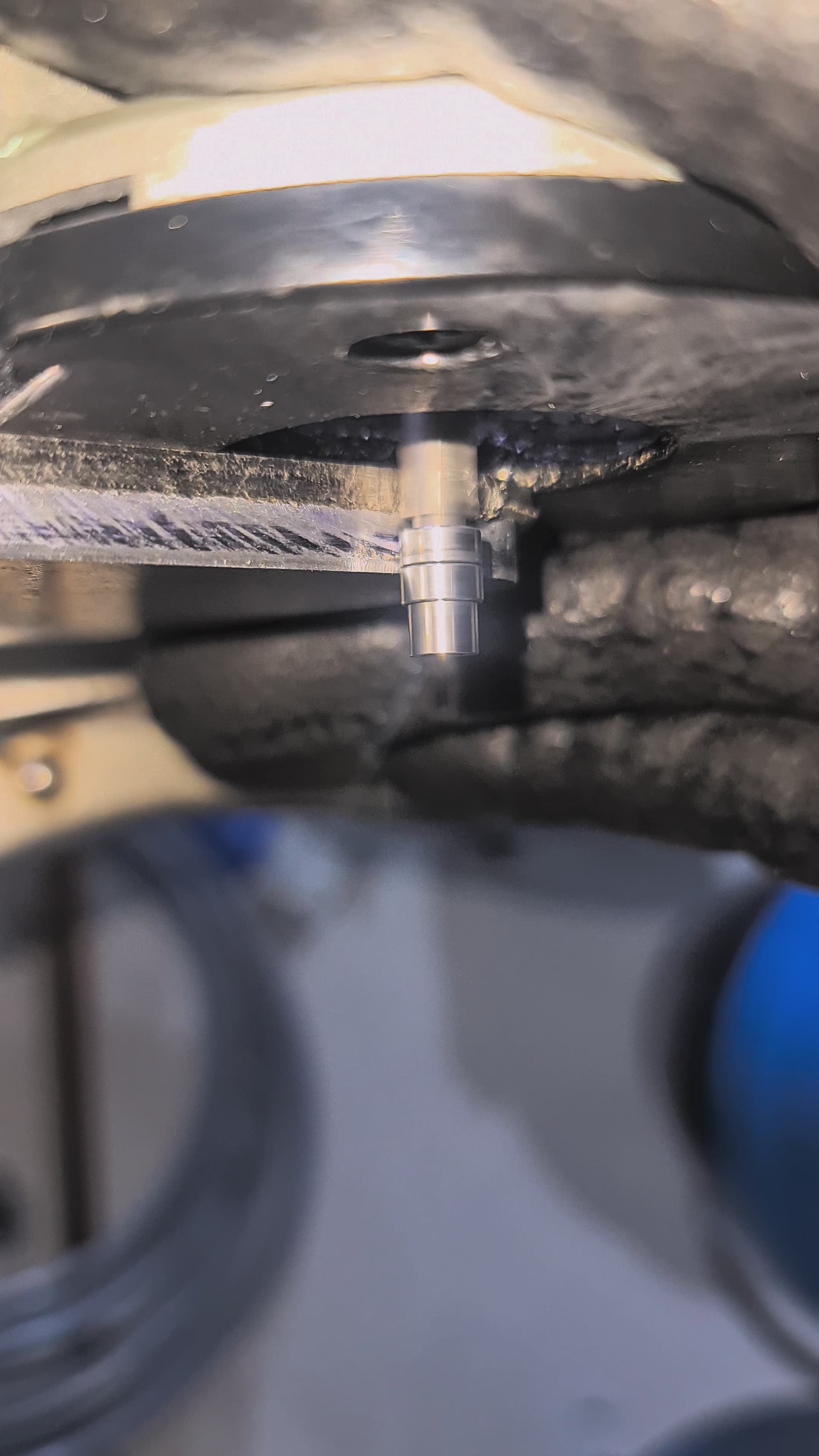

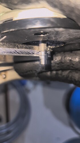

It was then over to my cordless Makita router trimmer with the bearing-guided spiral carbide cutter to shape the stainless to the aluminium template.
First one down, 3 to go:

Continued progress.

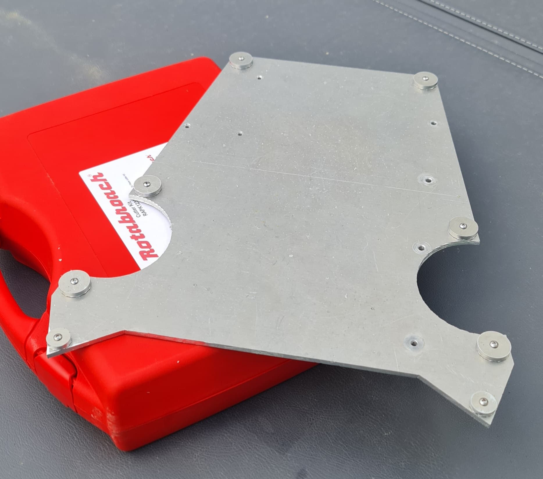

Stainless clamped onto aluminium template:
Milling the stainless flush with the template:
Another one completed:

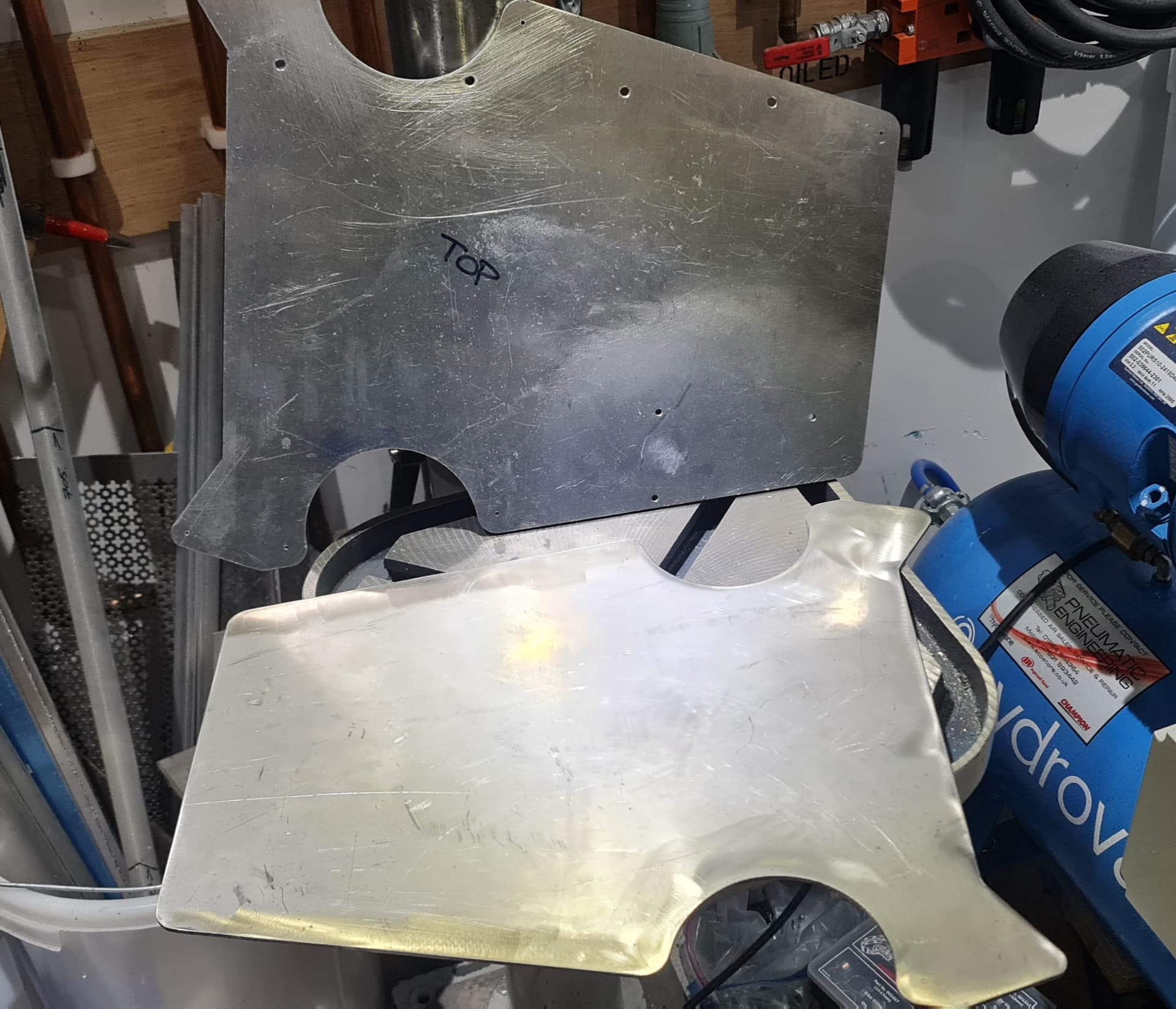

All four stainless sheets cut and ready for drilling:
And finally drilled ready for welding:
For the record, carrying out flood-cooled mag-drilling indoors is a really bad idea!
Drilling 16 x 22 mm holes and 16 x 15 mm holes used 3 litres of oil/water emulsion cutting coolant.
Next time I’ll wait until the rain stops and do it outdoors! :rofl:
