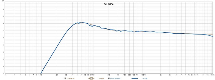

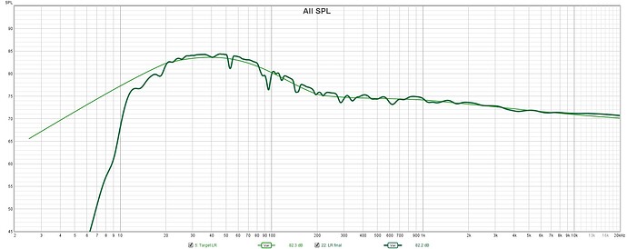

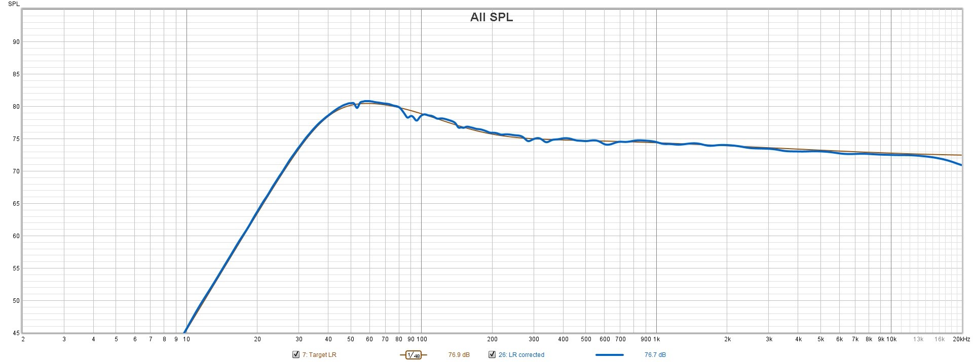

I did, however, manage to rustle up enough brain cells to sort out the bottom octaves a bit better. With ~91 dB sensitivity, 12 mm of linear excursion available on the CA22RNX, and a bucket load of gain still available on the Benchmark front end, I pulled the overall bass up a few dB and lifted the 20 - 40 Hz region up to more or less the same level as the rest of the bass. I also tweked the room curve a little in REW.

The difference is on the one hand quite subtle, and on the other quite staggering. It’s not bass-heavy - far from it. I’m really not into overpowering, heavy bass. Everything just sounds so much more together. Bass guitar and double bass sound richer, but the overall effect on the sound is so much more. Switching back and forth on the fly between the 2 filters in Muse - the filter without the bass and sub-bass lift sounds a bit ā€œhonkyā€ in the midrange.
With the bass and sub-bass lift, it’s just perfect.
I can’t believe that once-upon-a-time I was the kind of purist who decried DSP. The improvements it can bring to the overall listening experience and enjoyment (after all, isn’t that what it’s all about) are simply huge.

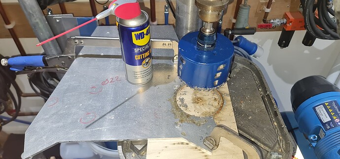

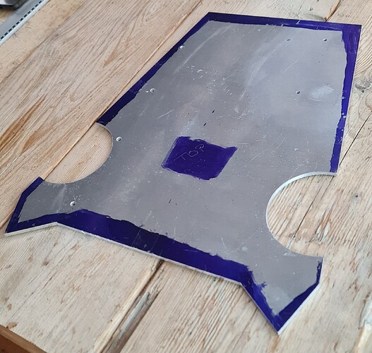

It’s been a heavy, hectic work week so not much time for progress other than thinking and sketches. I spent the late afternoon/early evening roughing out the 5 mm thick aluminium template for the plinth top and bottom panels. Track saw with an Alu cutting blade for the basic shape, then hole saw for the port clearance holes. Some corner radiuses to cut and some holes to drill, but it’s the weekend and I’m back in my happy place.
