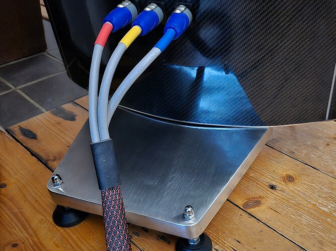

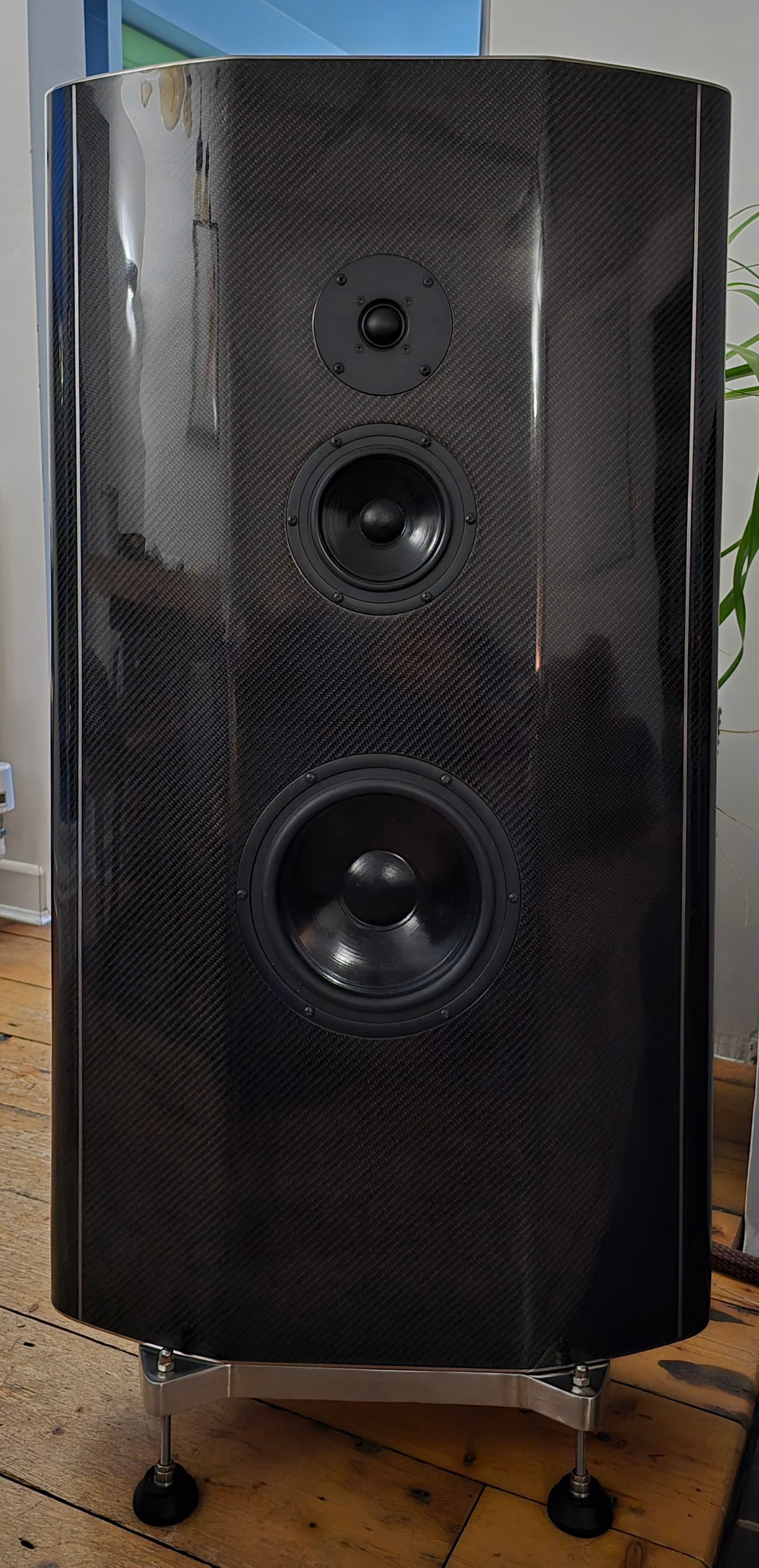

First one finally completed:
Congratulations Graeme, those look fantastic.
I’m sure I am not the only one that has been eagerly anticipating viewing the finished result.
Amazing. I feel I need to go back and read through everything again. Such an impressive build. Congratulations.
Did you change the plinth design or are those the welded cut outs from earlier. Looks like a block.
The design hasn’t changed.
The same 3mm thick top and bottom plates with 3mm thick strip around the sides. All TIG welded up, void space filled with steel blasting shot and welds ground smooth before satinising with a 46 grit polishing wheel
17 kg for each plinth. Brings the gross for each speaker to 71 kg. Each one is heavier than me!
Wow Graeme this is amazing work and great to see it coming to an end. With so much weight they will help keep the house stable.They look absolutely stunning.

Love the attention to all the details, with the wiring color coding obviously marked according to wavelength.

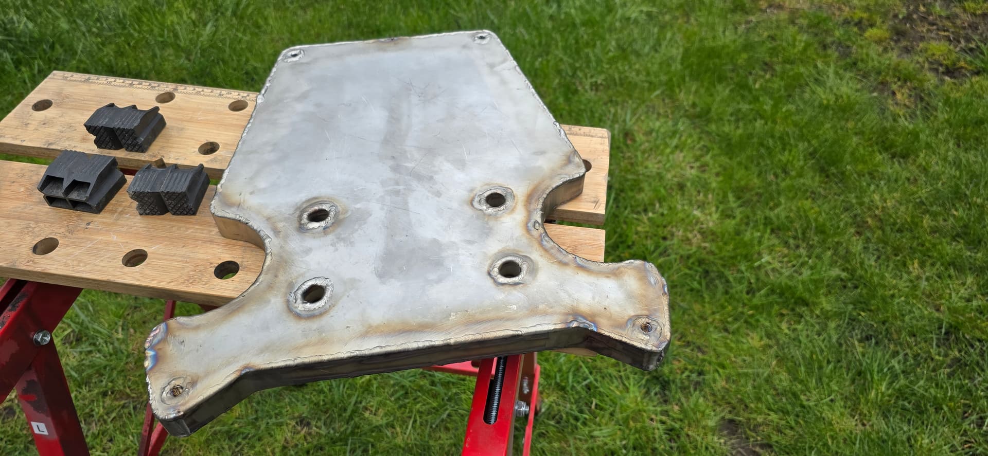

Here’s a few of the second one:
Welded up, ready for grinding

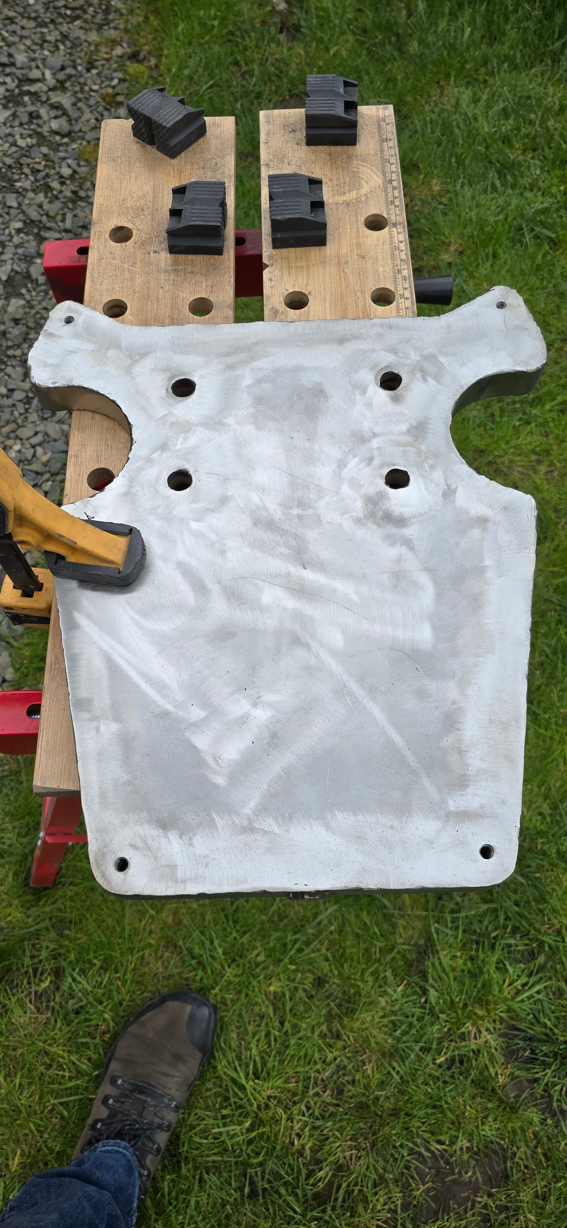

Welds ground flush

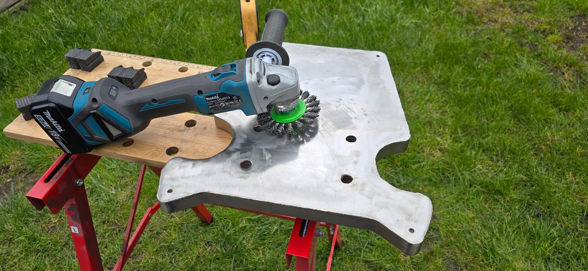

Quick buzz with a stainless wire wheel for cleanup before acetone wipedown to prep for the last weld pass.

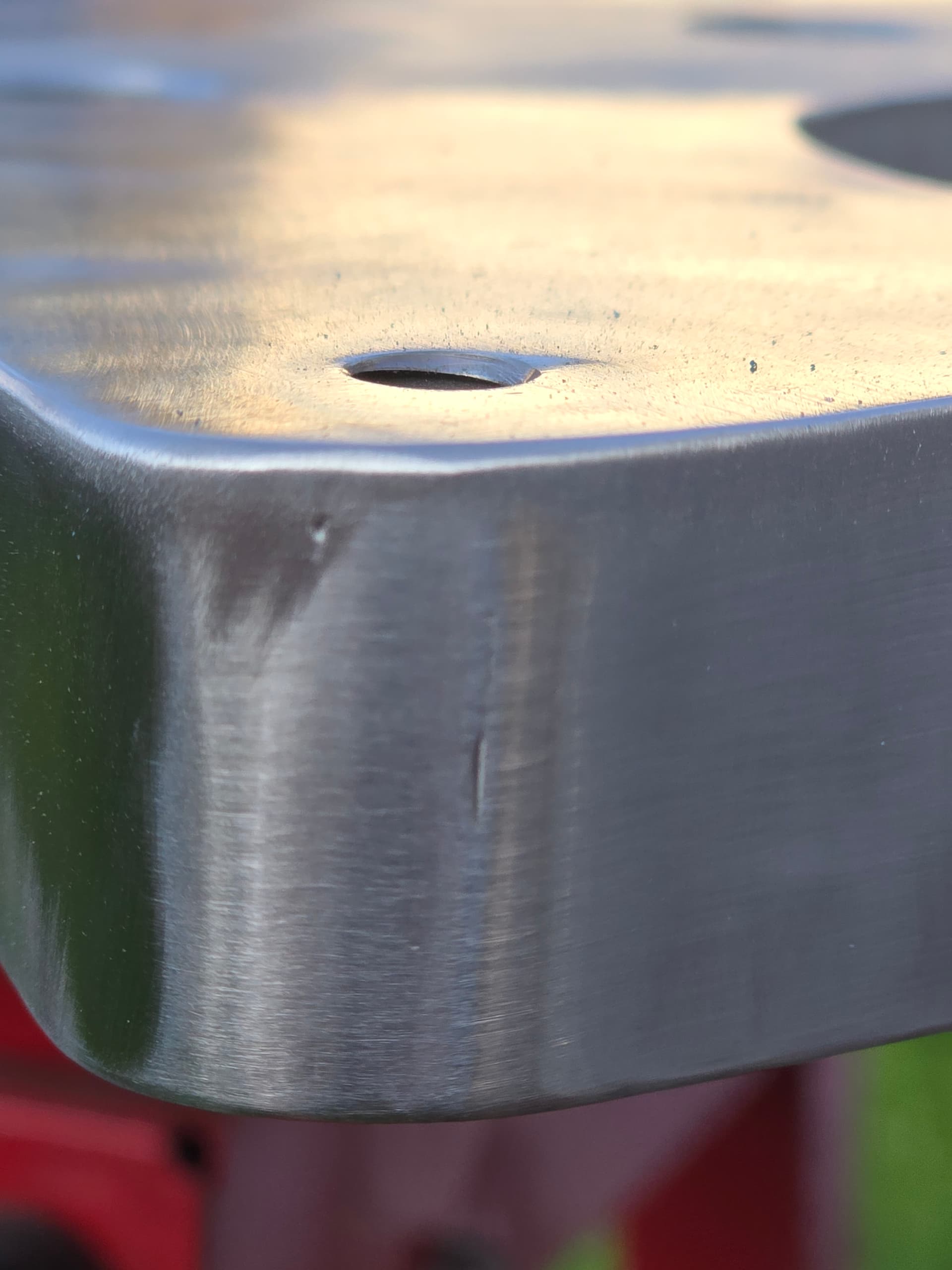

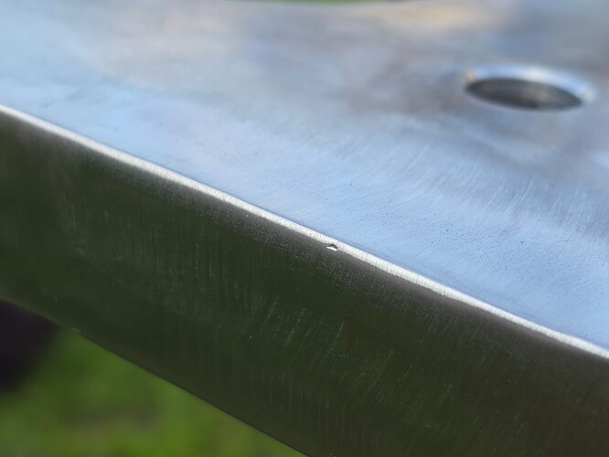

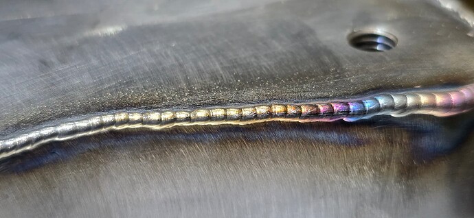

Laying down the last weld pass on the corner prior to the final grind and polish:
Second plinth will be finished this week.
Confounded by the weather yet again. Managed a little grinding yesterday in-between downpours.
Eventually got the grinding of the “final” weld pass finished this evening, only to find a couple of imperfections to reweld:

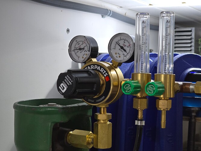

Chewing through a lot of argon, but still ~110 bar (~5000 litres) left in the bottle:
