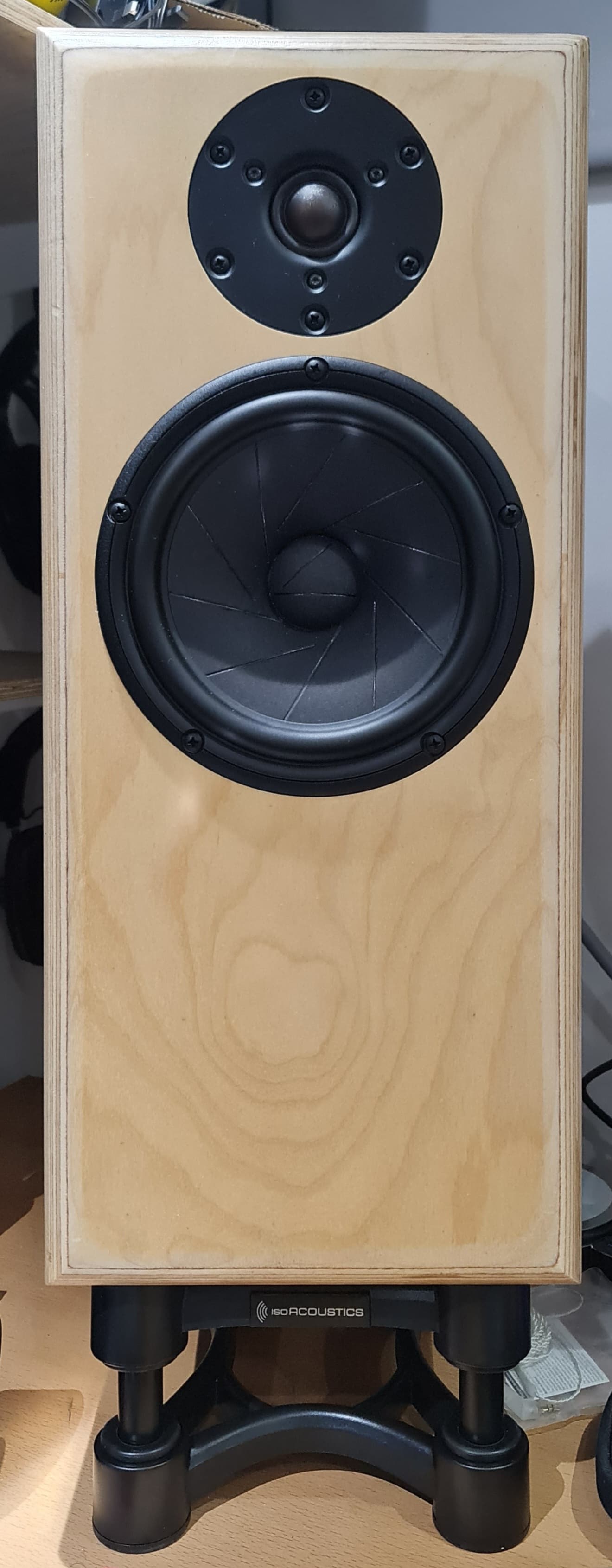

Second plinth completed.
Stan approves!
Stan is a legend and I must say he challenges being the best reason for the picture.

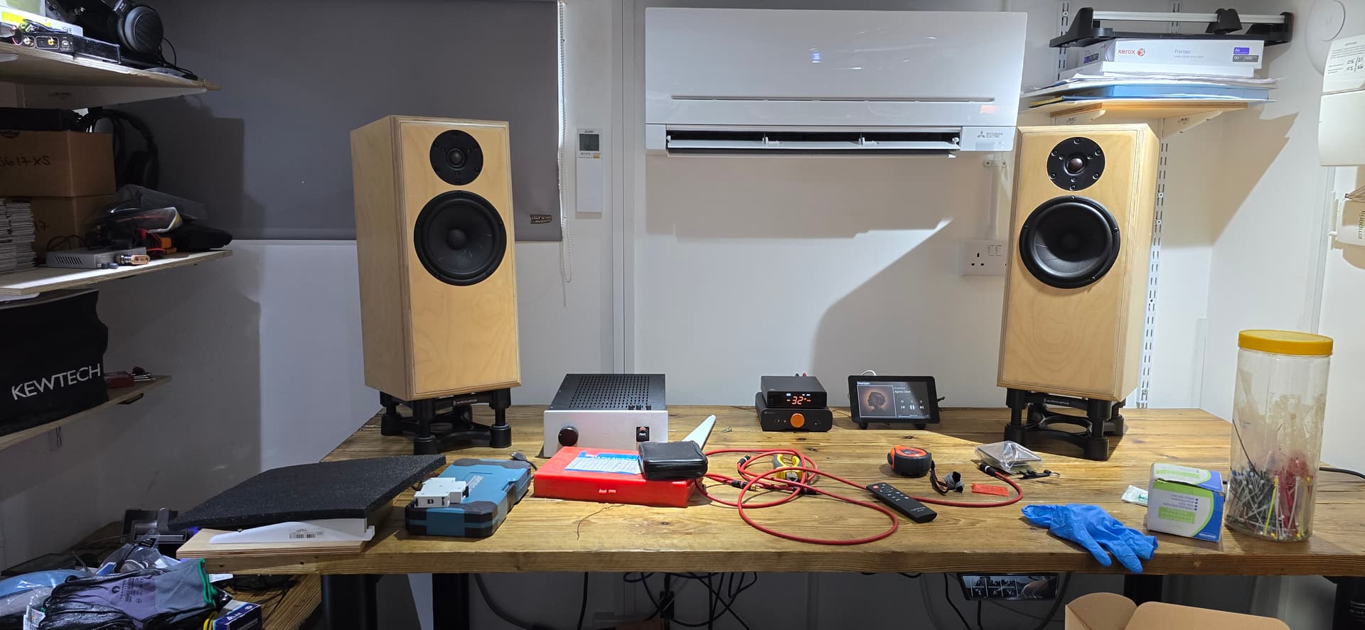

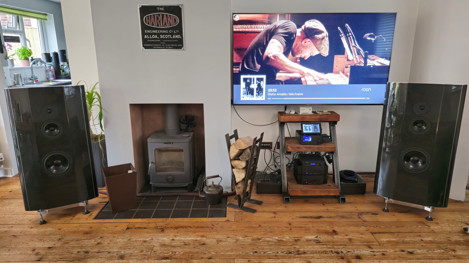

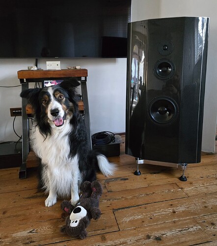

We need some pictures of the finished speakers in place and in use. Show us from a distance that shows the entire setup. Thanks.
EDIT: Eye candy.
EDIT2: Thanks Graeme. Beautiful setup. I’ll bet it sounds as good as it looks. You should build an airplane next.
What just to prove they actually exist and haven’t been CGI all along :rofl: :smiling_imp:
And perhaps pictures of the next project!!!
Here ya go:

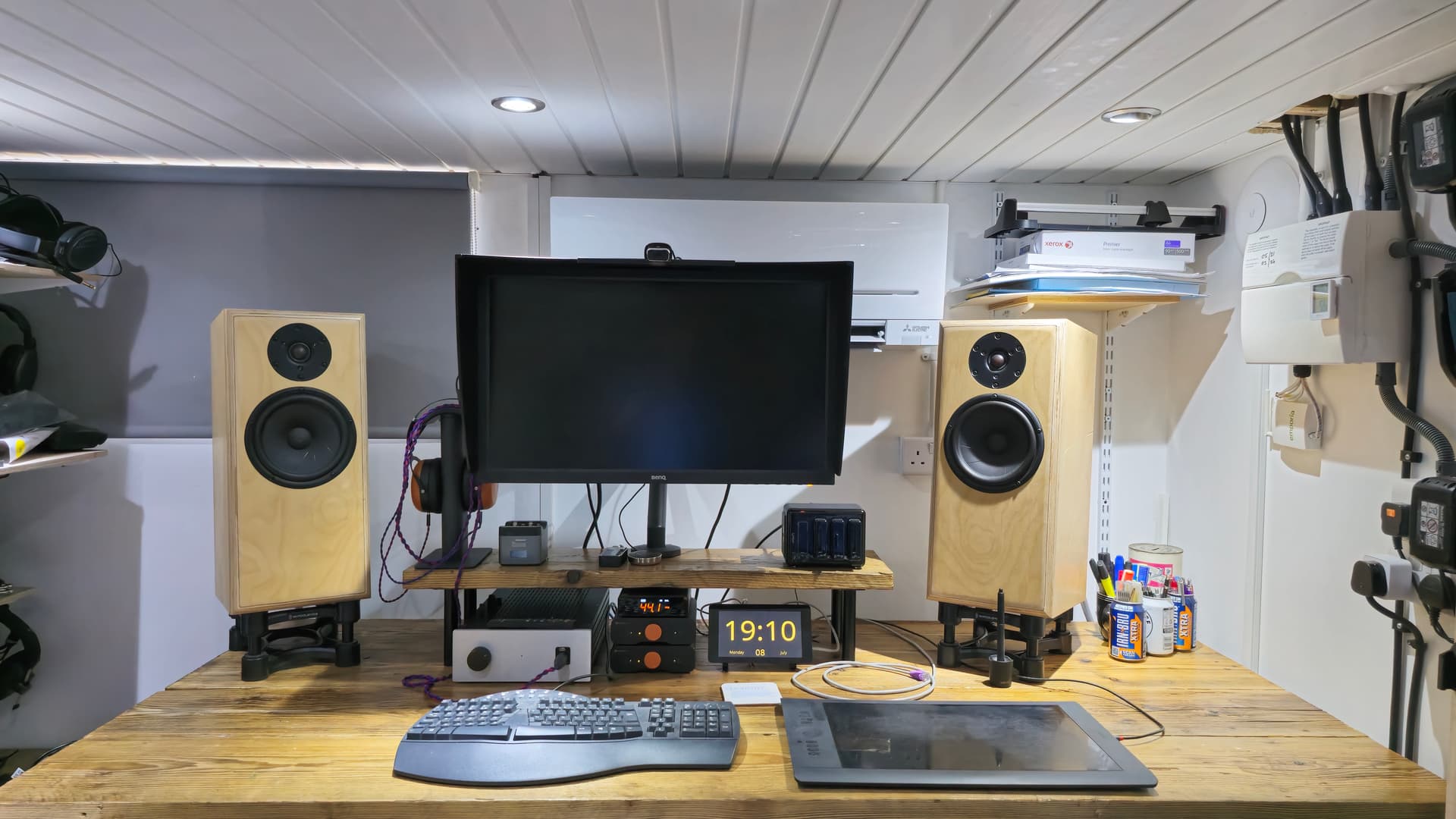

Now that I work a 3-day week, Mrs. Mad Scientist has been cracking the whip and has given me a spreadsheet detailing all the jobs to be done in and around the house!
I have managed to squeeze in some work in the Man Cave, though that’s mainly been sorting out to enable other stuff to be done (and to dump the old desktop etc. as we had a 4 cu. yd skip for a couple of weeks).

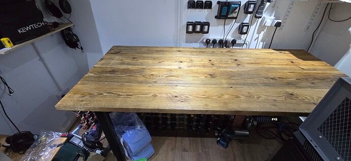

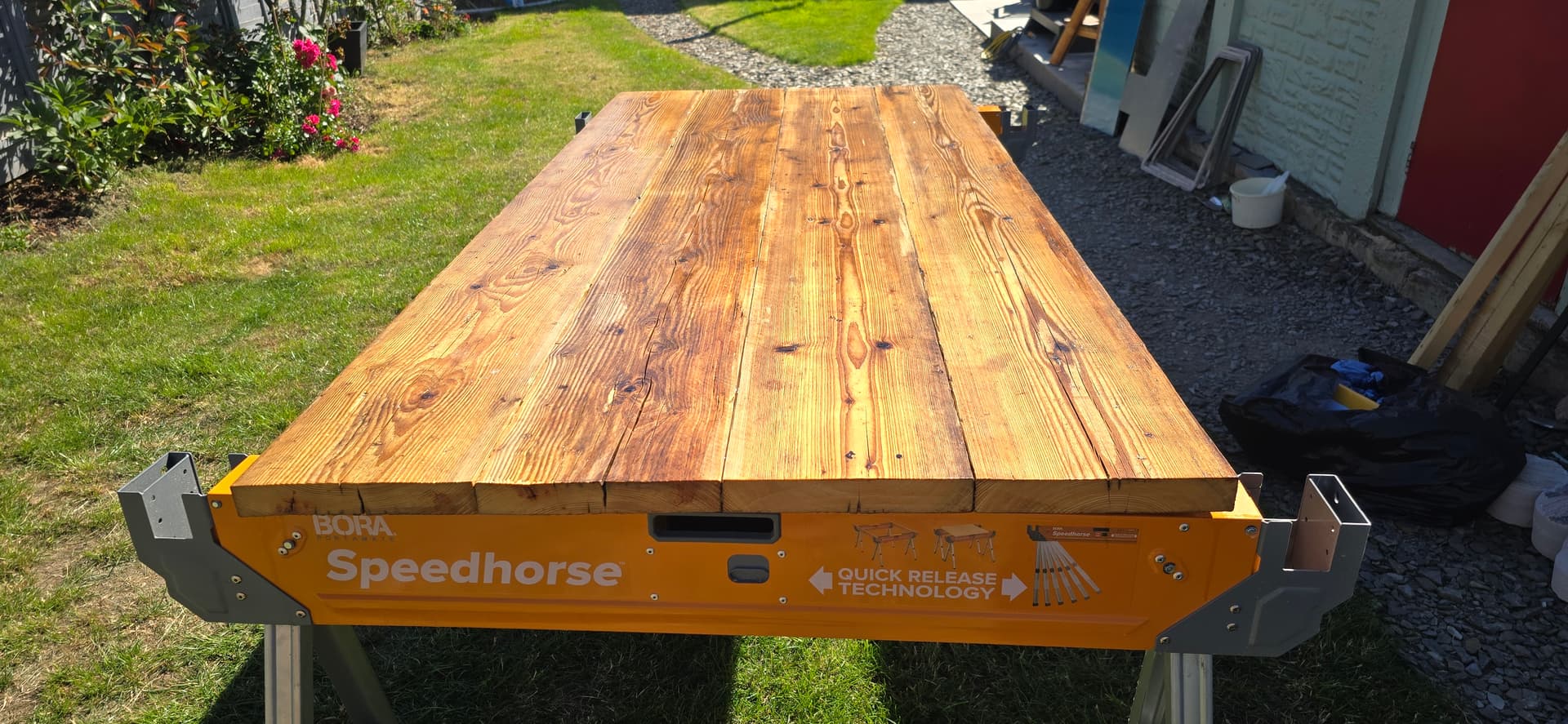

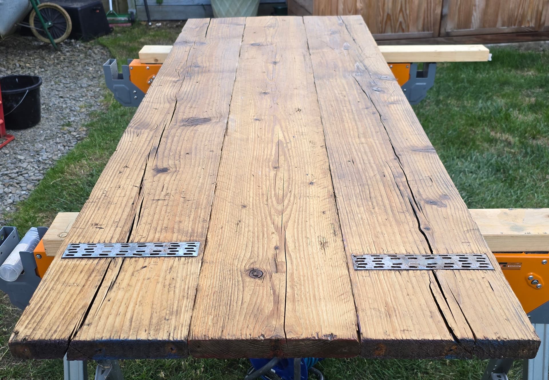

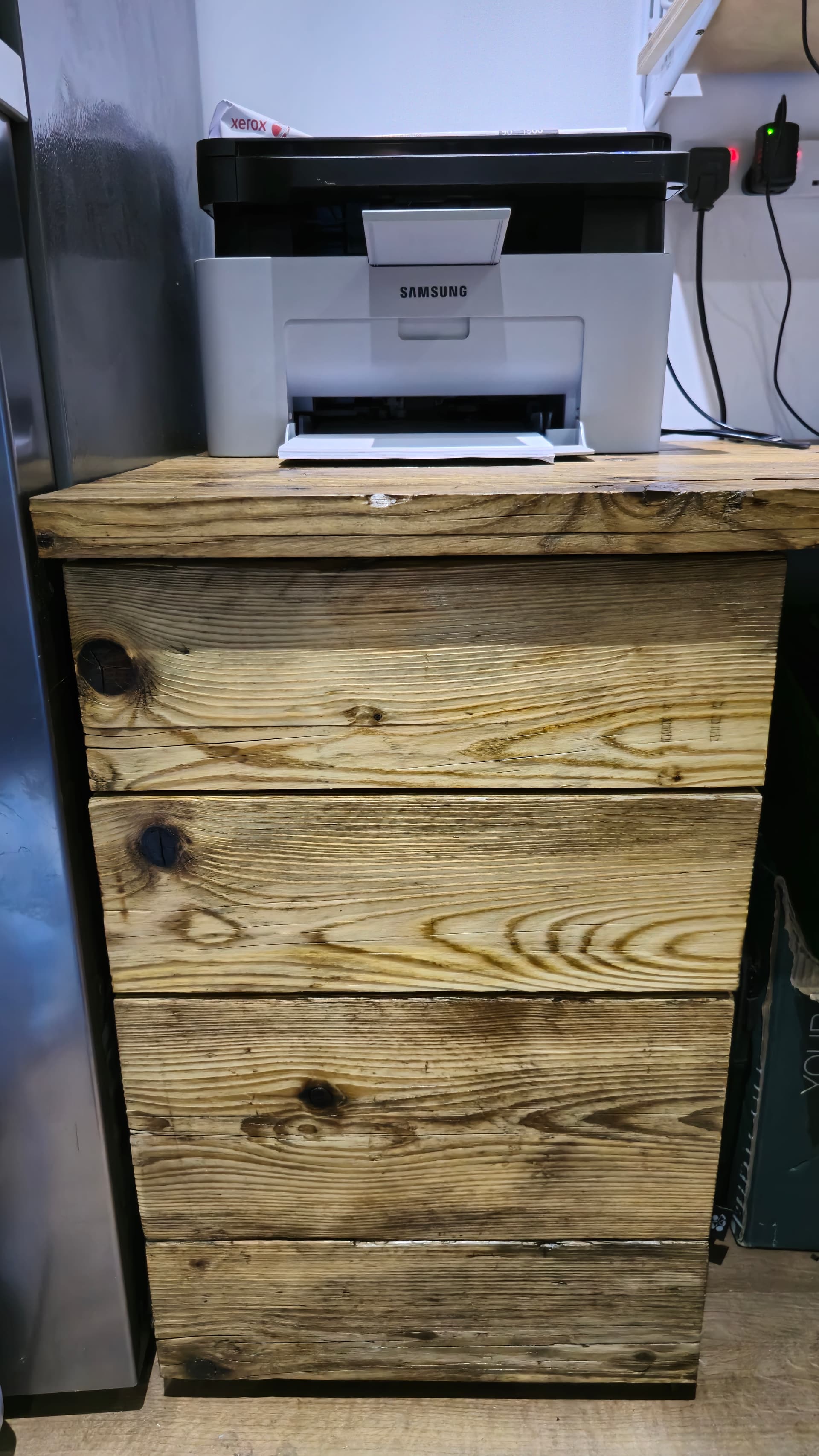

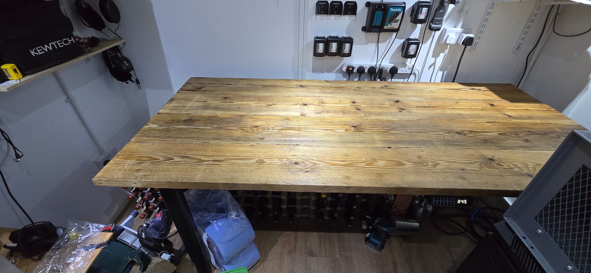

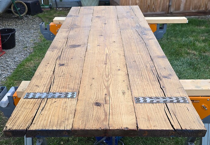

Fabricated a couple of new desktops out of reclaimed scaffold boards, had to fab a set of legs for the fixed desk as well and replaced the drawer fronts on the desk unit too.
Meant a lot of rejigging stuff around too.

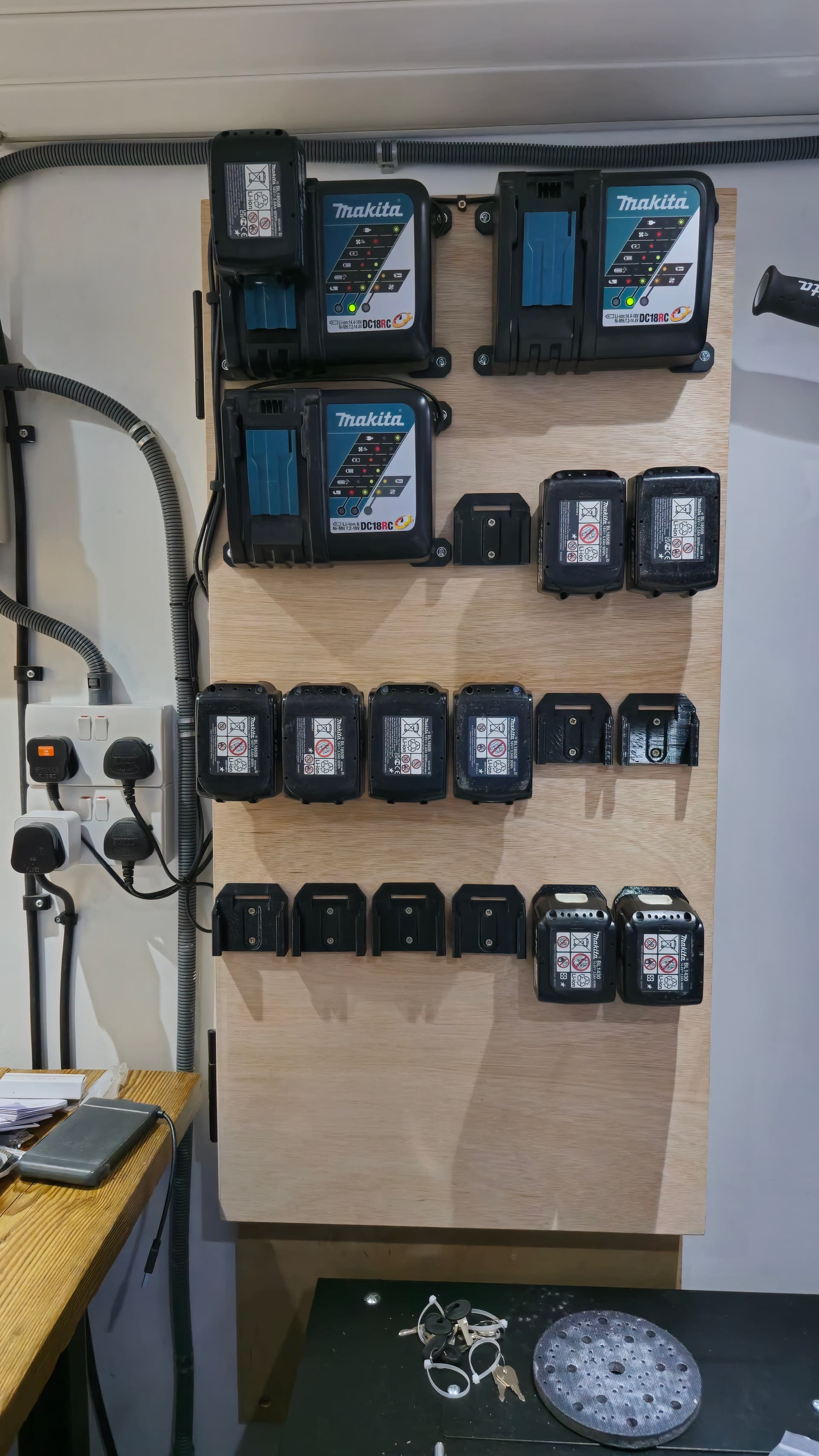

The new desk frame is an electric sit/stand unit, so all of my batteries and chargers needed a new home:
I moved the server cabinet 90 degrees around the corner and that meant recabling everything to reach the desk from the PC. l had to move the welder socket and put up some new power outlets for the relocated chargers.

It doesn’t look like you can stand up in that room.
The photos of the desk were taken with the top of it just over a metre from the floor. The ceiling is only 2 metres (6’ 6") from the floor, though. I’m only 5’ 10", so plenty enough headroom for me! :smile:
As I"m a little over 6’2", it seems a bit crowded, LOL.

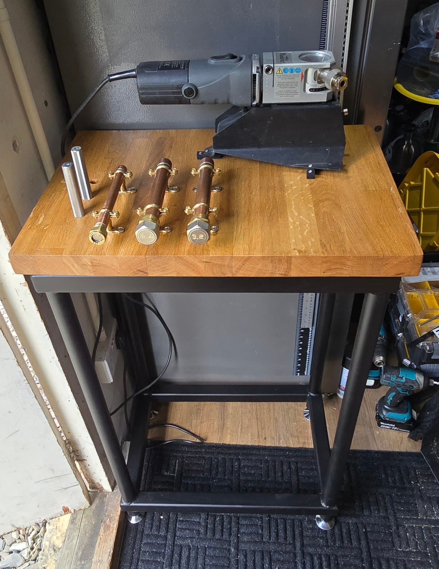

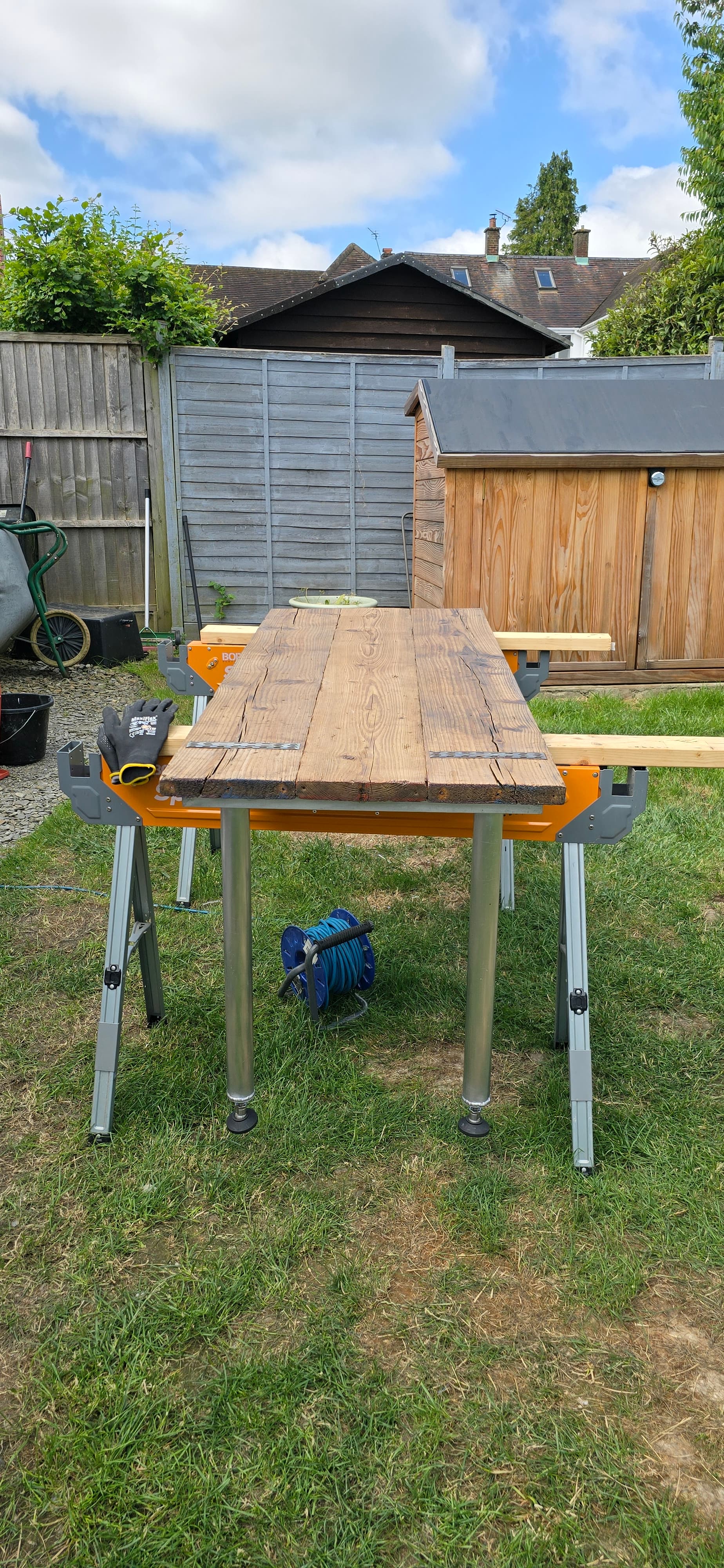

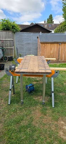

Built a proper table for my tungsten grinder:
Still got the bottom shelf to finish for my boxes of collets/bodies/cups.
For any one who doesn’t know, these things are ridiculously noisy and produce a lot of vibration.
The frame is 38.1 mm (1½") box section with 34.8 mm (1⅜") tubing for the legs. I welded up the rectangular box section pieces, then mag-drilled holes to accept the tube, only inserted to the thickness of the box section. Once it was all welded up, I drilled the top rectangle above each leg and filled the whole thing up with SS330 grade steel blasting shot (4600 kg/m³ / 287 lb/cu ft), about 26 kg (57 lb) in all, then plugged the holes with Cu968 silicon-bronze TIG brazing rod. Quick grind to flush, a lick of matt black paint, then topped off with a piece of reclaimed oak worktop supported on rubber isolation mats. The grinder itself is also mounted on rubber. The mounts are screwed to the worktop and the grinder screwed into the mounts.
Now the whole workshop doesn’t shake when I’m sharpening tungstens.
