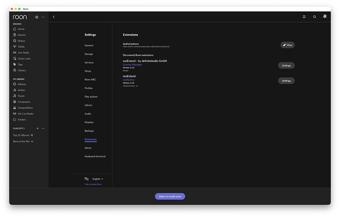

I checked roon/Settings on my roon remote iPad and saw the rooDial was there, but no longer Enabled. Don’t know how that happened, but I enabled it, selected my speaker, and now all is well.
How do I find which version I am running? Sorry, but I never paid it much attention.
You can see the version in Roon under Settings > Extensions.
