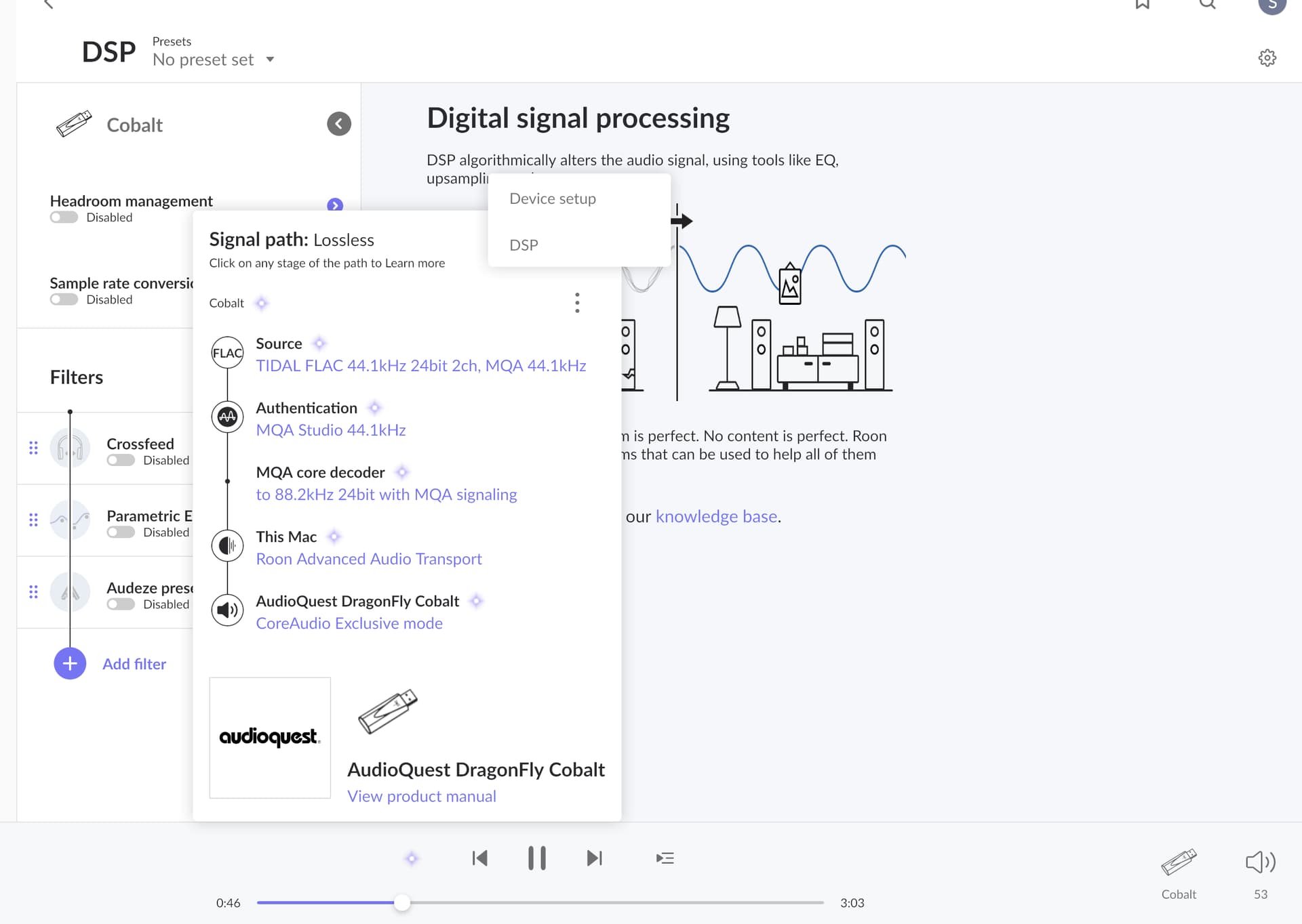

Please share a screenshot of the signal path. I agree with @Rugby that DSP is probably involved or you’re not using Exclusive mode and the laptop is doing something.

At these setting the light is yellow. If I turn it to 100 it will be purple, but not nearly as loud as the device is capable of from other sources on this laptop.

Make sure you’re using Exclusive mode. (There’s nothing wrong with Roon’s signal path and Roon is clearly sending a bit-perfect stream with MQA signaling to the DAC.)
My settings for the Cobalt in Roon are: exclusive mode ON, device set to Renderer Only and MQA core decode ON. This works as expected. These are the same settings for all my remotes on iPhone, iPad and Macbook.
If using the Tidal app, this should also be set to Exclusive Mode.
EDIT: forgot to mention that in Roon, volume for the Cobalt is set to Device Volume.
