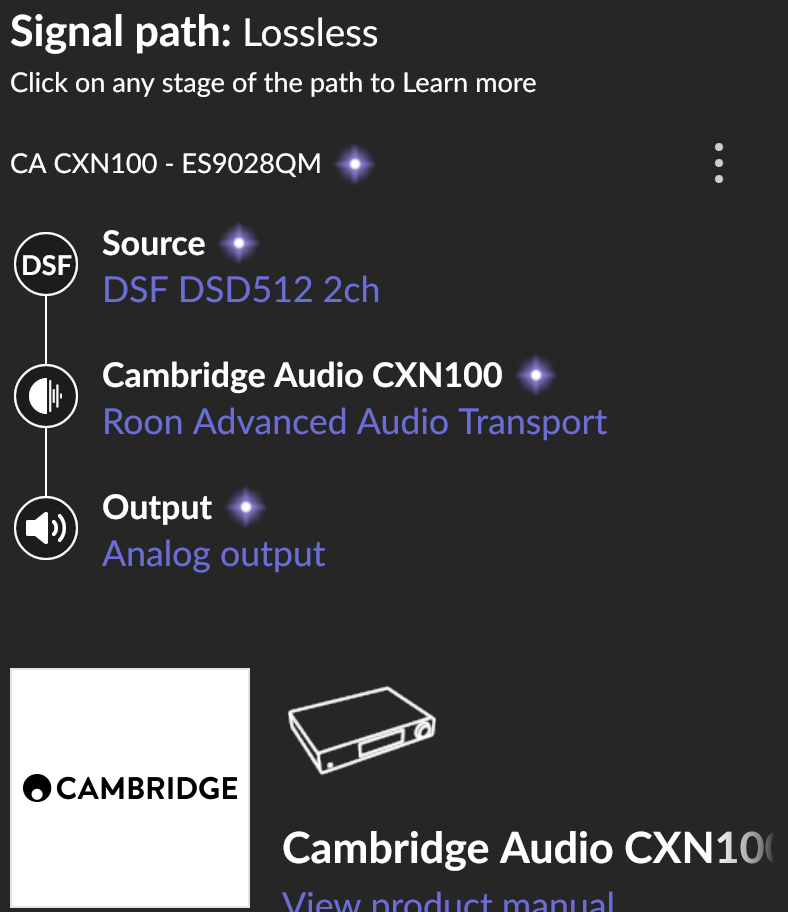

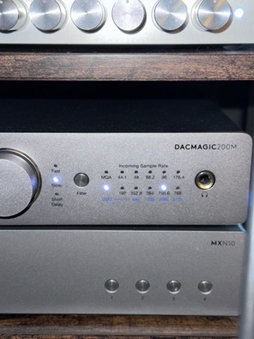

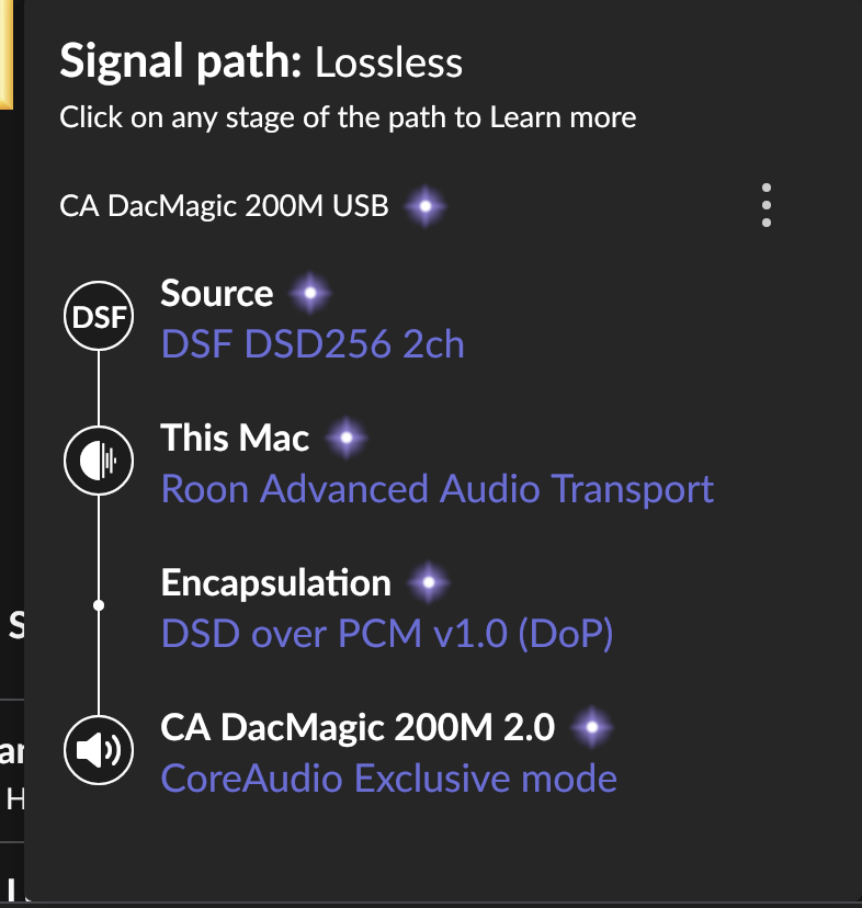

I don’t quite understand. I have a Mac mini m4 and have it connected to a DACMagic 200M directly via USB and I’m getting DSD256 using DoP. I also have a CB CXN100 in another room and I get DSD512 over the network. So what am I missing?
DoP max rate is exclusive to the max PCM rate of the DAC. The K13 R2R max rate is 384khz, which translates to only DSD128 for DoP. a 768khz capable DAC can do DSD256 over DoP, so on and so forth.
