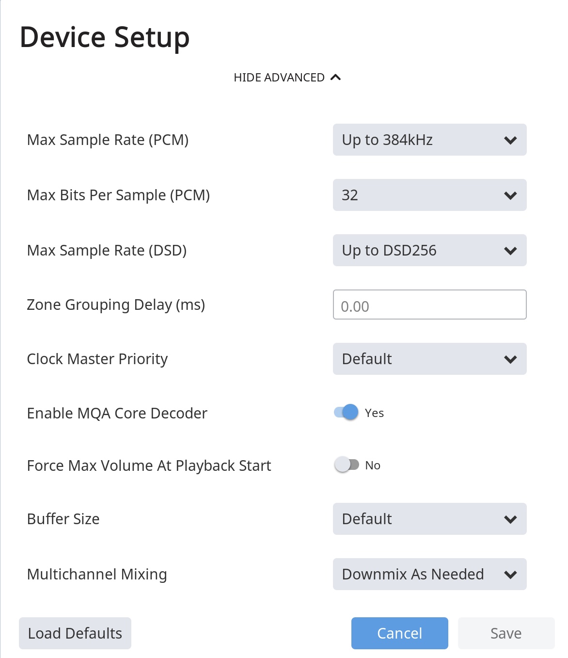

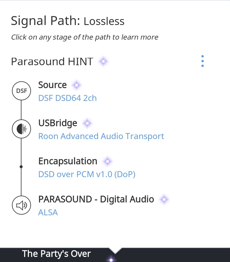

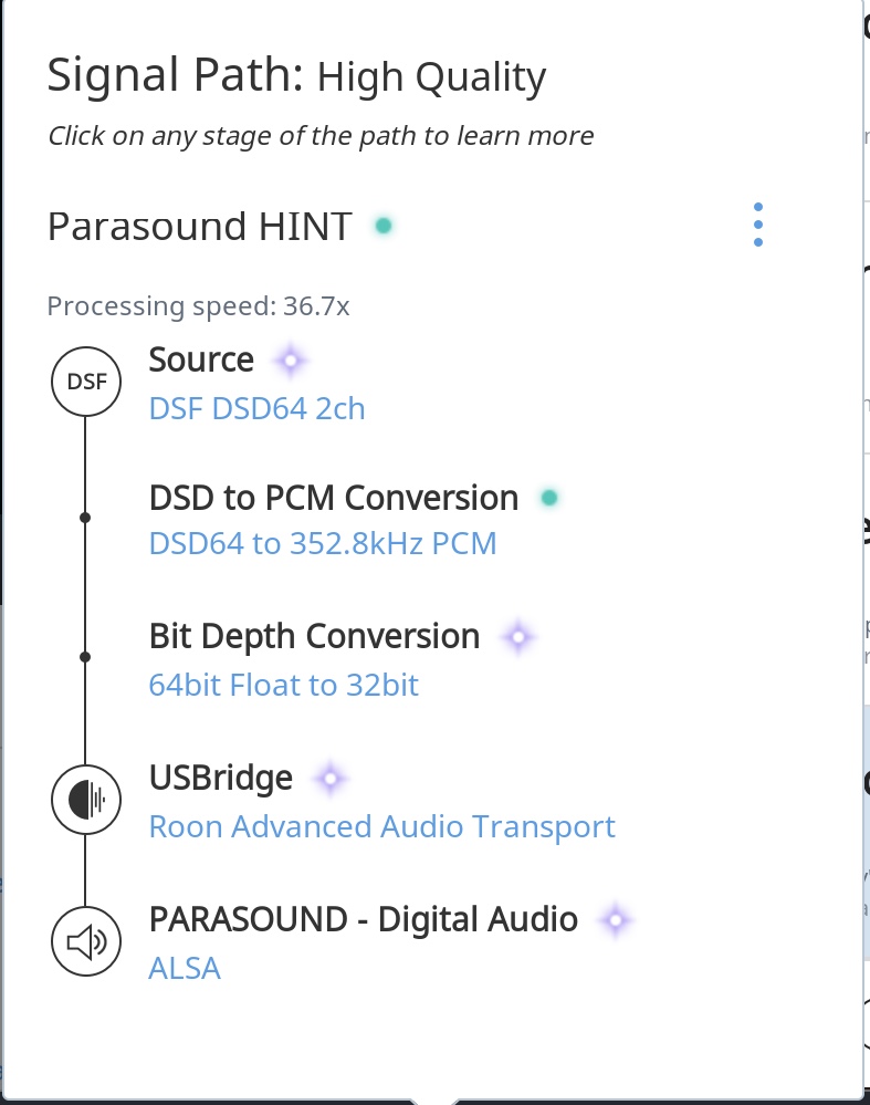

The problem is I only get a hiss when playing DSD file via DOP with Parasound HINT. Only option is to switch to PCM (see screenshots).

This last config won’t give any sound despite looking like its playing
I had a similar issue with my McIntosh C52, try setting Force Max Volume at start up, that fixed it for me.
Thanks Mike. Tried that but didn’t help.
