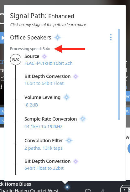

The processing speed indicator on Signal Path might provide some clues.
Yes, of course it does. Should have thought about that. This is the “problem” with DSD; that what you hear is what you get. I am running on Samsung Ativ 9+ with i5 2.3 (max?) MHz
I don’t think an i5 should have trouble with DSD->PCM conversion. What does the processing speed indicator say when the problems are happening?
I am having trouble replicating the error as the DAC now enters the “unsupported” status (384kHz mode) once I activate DSP. However before that, I believe I saw values between 0.8 and 1.3
This is a 5.6M recording that is playing now just fine without DSP enabled, using that Ativ laptop as remote against a MacBook Air 2009 1.8GHz, which uses Roon: 35-50, Kernel task; 8, and RAAT 6 % CPU
Can I make a setting on the PCM conversion in order to evaluate your question?
Turn off DSP Engine and turn on Volume Leveling or Crossfade–that will cause a DSD->PCM conversion without triggering much extra work.
