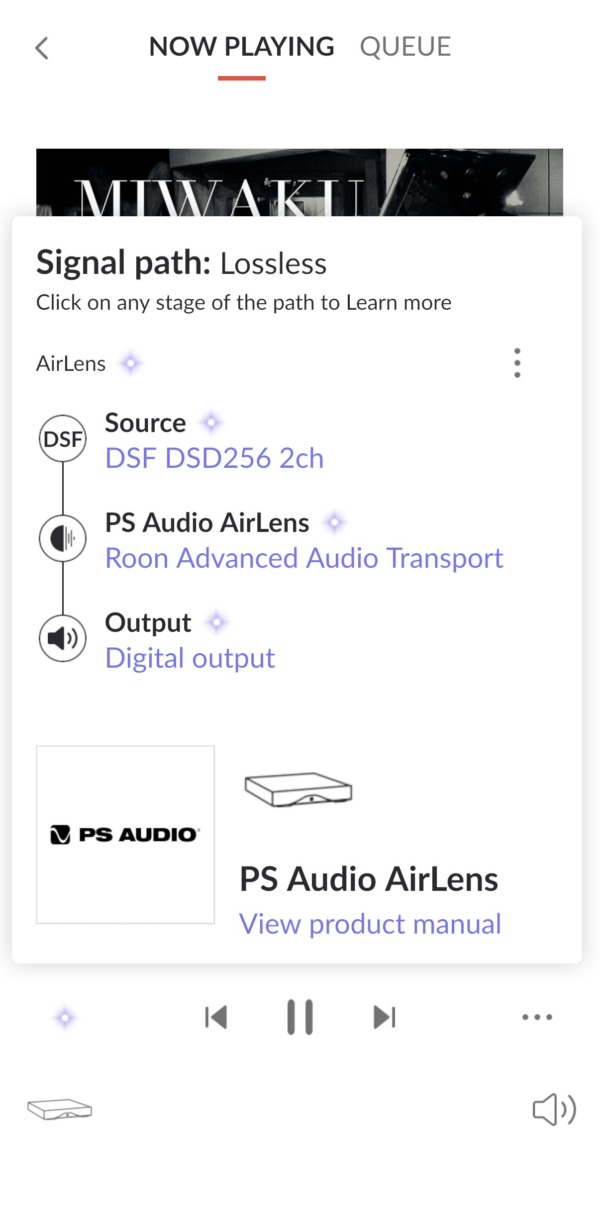

When I switch to Chord Poly/Mojo2, there is no problem so I suppose it’s a handshake issue between roon rock and PSA AirLens? I went through possible settings but no luck. The AirLens dip is all up position, connected with I2S to the PSA DirectStream DACII

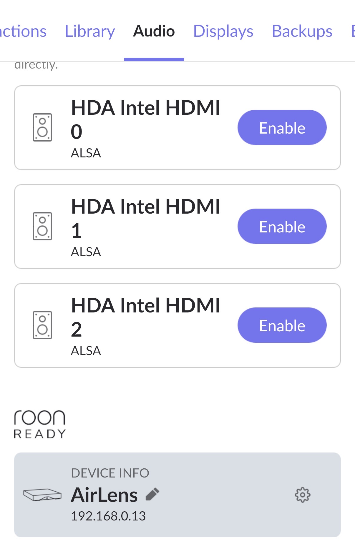

  1. How the PS Audio AirLens is connected to Roon
  • Is it enabled and selected as a Roon Ready device in Roon → Settings → Audio?

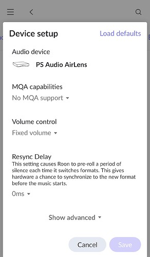

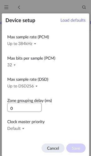

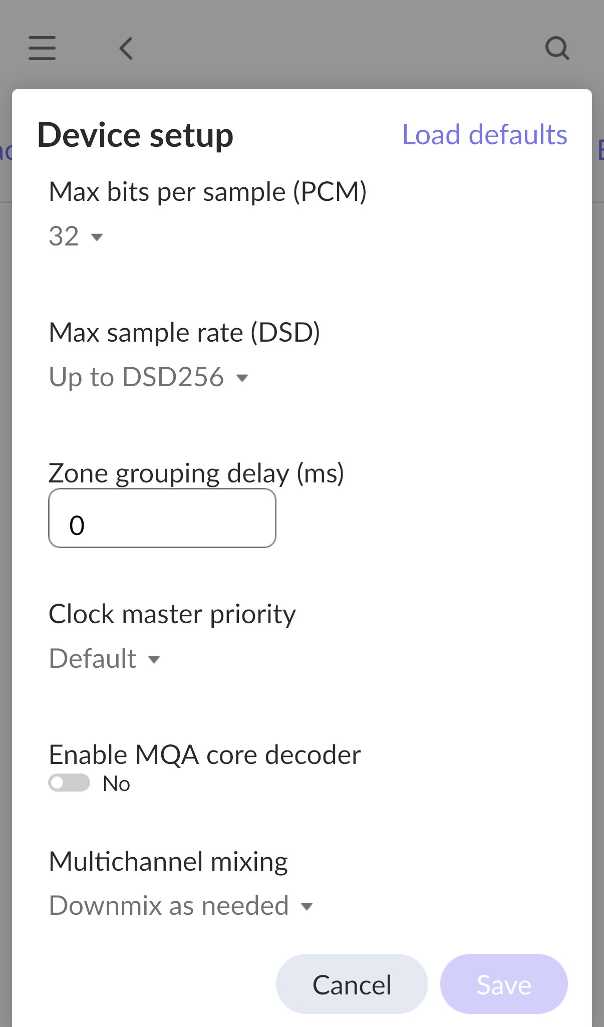

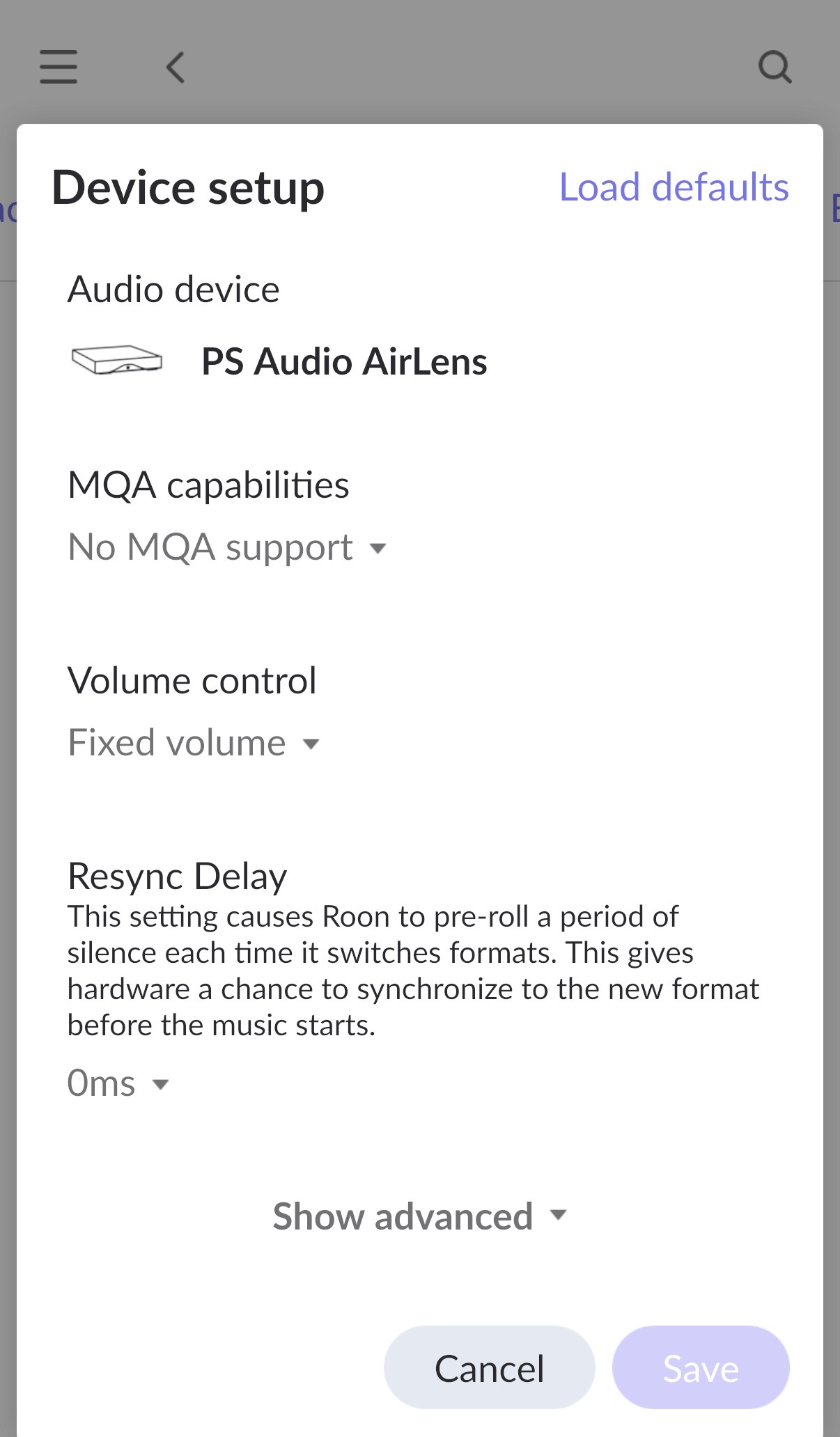

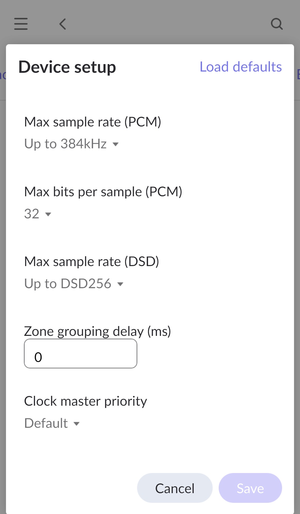

  1. Please also share a screenshot of the AirLens device settings in Roon
    (Settings → Audio → PS Audio AirLens → Device Setup, including the advanced options if available).
This will help us confirm what format Roon is sending to the AirLens and whether any conversion or limitations are being applied.
Once we have that, we can advise on the next steps.

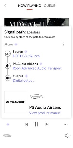

  1. Yes it is connected as roon device and network chain seems ok
  2. Pls find the screenshots of the details
Hi @Tak,
Thank you for the screenshots — they’re very helpful.
From what we can see, the configuration in Roon looks valid:
  • The PS Audio AirLens is correctly identified as a Roon Ready device
  • DSD playback is enabled up to DSD256
  • The signal path shows lossless playback with no obvious conversion or processing applied
At this point, nothing in the settings stands out as incorrect or misconfigured.
