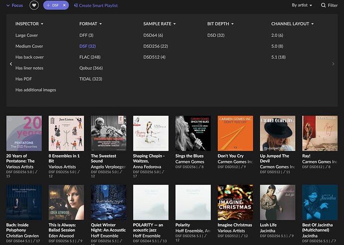

Certain DSF Files Don't Appear in Roon. One album is DSD 11.2896 and the other is DSD 2.8224. I am wondering if Roon cannot see .dsf files of these types.
My music files are in Roon on a Windows 11 laptop. I play my music using an iFi Stream connected to a McIntosh stereo. My network is an Archer wifi 7 system by TP-Link. The iFi Stream is connected to the router via Ethernet.
I have a some DSF format files, DSD 64/256/512. That are in my Roon Library.
