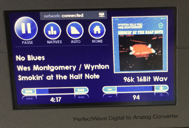

As of 12/22/2017 I’m running the latest versions of Windows 64-bit roon core 1.4 (build 294) to a PS Audio PerfectWave DAC with Bridge II (also at the latest versions). When playing hi-res files (96-24) the DAC reports 16-bit WAV if the DSP Engine or volume leveling is enabled. If DSP is disabled the DAC reports 24 bit WAV as expected. I would not expect the bit depth to be degraded when using DSP. I’m not sure roon 1.3 did this or not.

Simplest case: No DSP Engine, just switching Volume Leveling from OFF to AUTO.

Turn Volume Leveling ON
The PS Audio DirectStream figures out the bit depth and sample rate on its own. It does not rely on the source to tell it what those values are. So, if a 24 bit or 32 bit track only contain zeroes in bits 17 to 24 or 32, the DAC will display them as 16 bit files. I can’t tell you why the original unmanipulated track shows as 24 bits. But, after manipulation that track is down to 16 bits plus a bunch of zeroes from bits 17 to 32.
