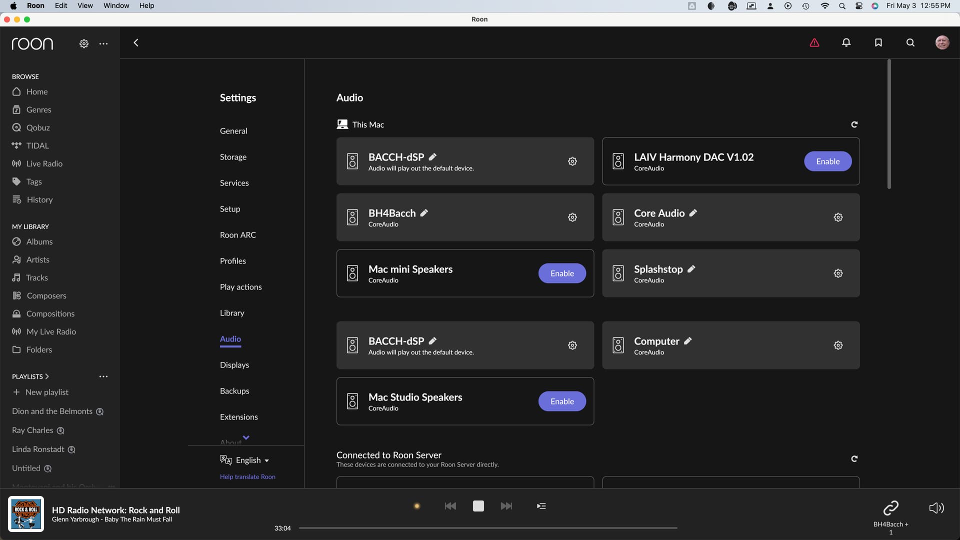

Settings:audio and select your output , make sure it is enabled, see screenshot
I don’t have the same menu that you do but it doesn’t appear that I can select an output that has any other output other than “Default” which is the Mac Studio. See below Bacch DSP selection: “Audio will play out the default device” There are no other choices.

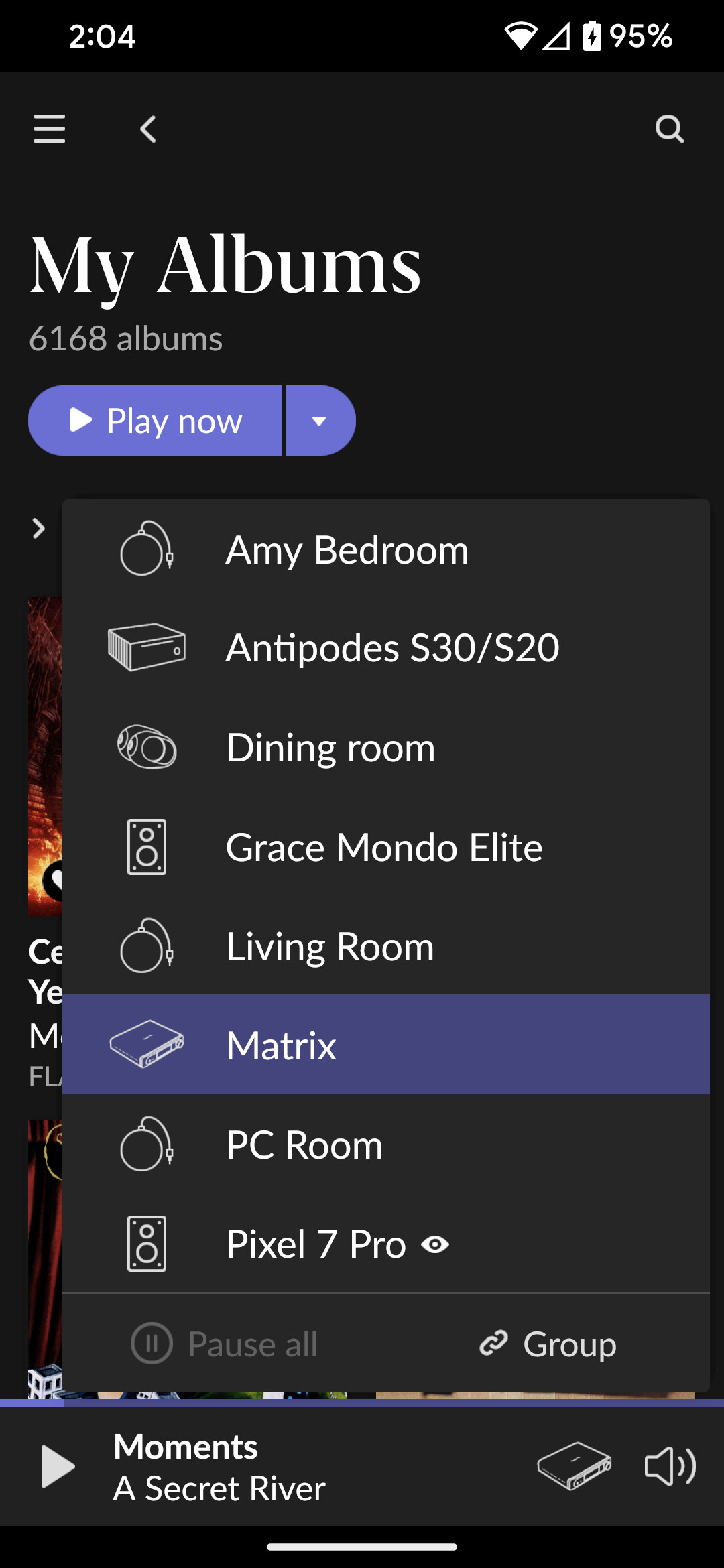

You don’t see this at bottom of screen?
The bottom row next to end icon is your audio output where you can select it.
Yes, of course. However, when I open that selection up It still says “Audio will play out the default device” and this doesn’t appear to be modifiable. So what is the “default device” is it simply the endpoint that is identified - in this case BH4Bacch?
But I think that is referring to the default audio of that device not a Roon default device per se.
