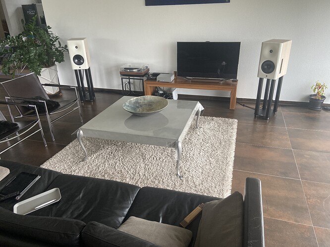

Speakers are 307 cm apart, distance to listening position from either speaker is 340 cm. Speakers are angled to the ear, so roughly 60 degrees. Speakers are pulled out from backwall (40 cm from midpoint of the back of the speaker. Either speaker is free from sidewalls by more than 1 meter. Tile floor but big rug in front speakers. I do have a large coffee table, see picture of the room. High ceiling that angles down towards listener. I use REW and simply added uBAACH after
I use a NUC for Roon/Qobuz (plus analogue source but uBAACH does not affect that)
Your setup should work well, except for that coffee table. It will cause strong and very early reflections. Please move it out of the way and do an extended listening session with BACCH enabled.

  • coffee table is indeed an issue. If you make measurements with REW, make sure to remove it before
