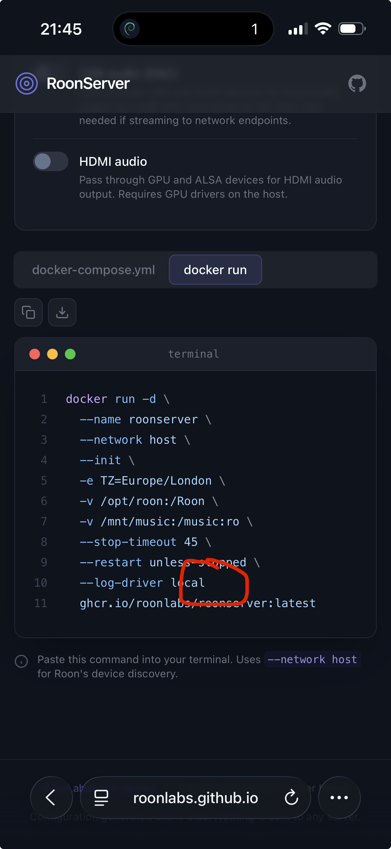

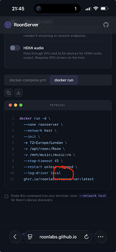

This is just a confirmation that Roon’s auto update worked fine for EA build 1648 using the new container image.
@Stephen
Missing \ :wink:
