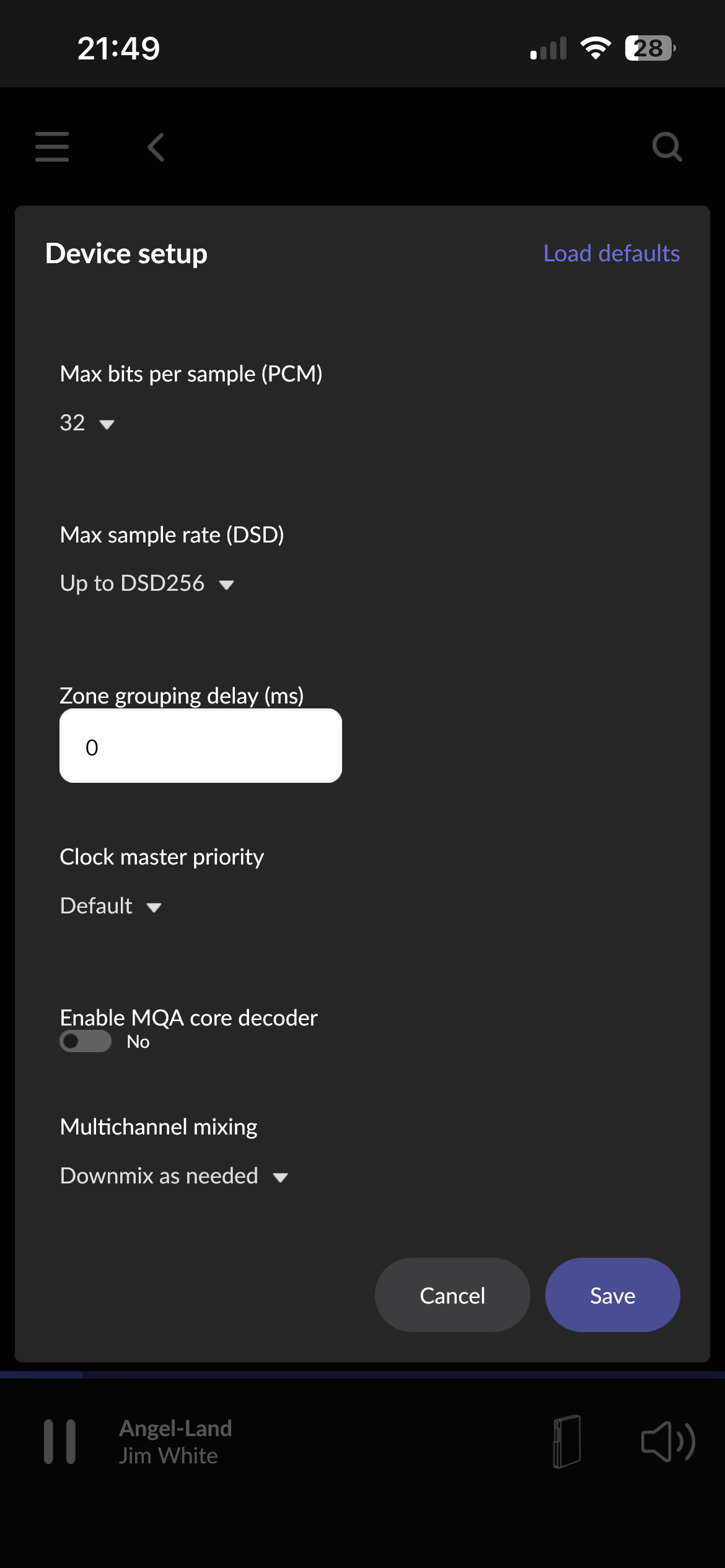

RAAT (as employed by Roon Bridge devices and Roon Ready endpoints) is the most reliable for grouping zones and also allows you to delay zones in order to properly synchronise them:

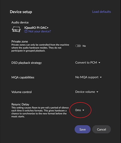

I believe the Resync Delay configuration for the device helps prevent playback issues at the beginning of songs (such as silence or hearing pops/clicks) when playing a DSD track after playing a PCM one (or vice versa). Some devices (DACs) have trouble immediately playing a track that’s a different format from the prior one.
Sorry wade that’s more to do with DACs and switching rates between tracks it has nothing to do with group play.
Op needs to set one device to be the master clock and the play with delay one to get them in sync.
Yes. I got confused. My mistake. I knew there was a setting in there somewhere though.
But since I have never had occaision to use either…

I’m only seeing one Lumin registered to your account with both Roon Ready and Airplay mode. Are you currently seeing both Lumins under Roon Settings → Audio? If so can you share a screenshot of what you see there?
