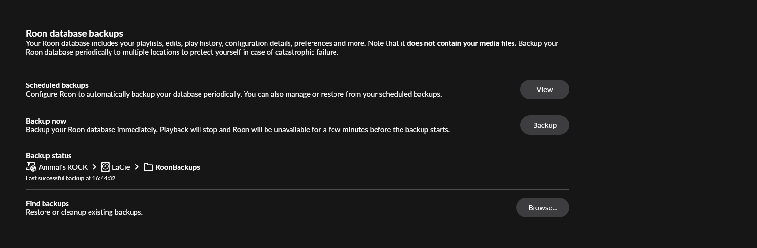

Can you try to doing a 1-time database backup? since 880, backups check for database corruptness before backing up, so it’ll confirm whether your db has something wrong with it.
A corrupt db could result in random edits being missing.
Ok, just did the backup and it worked as it should. Thankfully, no corruption or anything.
