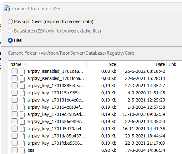

Yesterday I was able to access the server with Linux Reader and found the file ‘bits’. The file is indeed in the exact location as you described.
Because Linux Reader is for reading files I also tried PuTTy but got stuck after the successful login. To be honest I don’t know how to stop the RoonServer and how to access the files with PuTTY.

I first pasted the new bits file into the files section of the server using my internet explorer.
To find your Vortexbox using PuTTY, you need the IP address. You can find that by typing http://vortexbox/ in your browser.

I first copied the bits file to the root directory using
Then you need to copy the new bits file to the same folder by typing
  • copy “bits” var/roon/RoonServer/Database/Registry/Core

I used PuTTY to connect to, stop and start the RoonServer as explained by Siegfried.
Instead of the IP-address also ‘vortexbox’ can used as the Host Name when using PuTTY.
For removing the file named ‘bits’ and placing the new bits file on the server, I used WinSCP. In my search I found WinSCP and this tool looked more easy to use for me than PuTTY.
WinSCP has a graphical interface like Windows explorer and it also integrates with Windows. With WinSCP it is easy to access all files on the RoonServer, delete files from it and copy files from Windows to the server. This can be done by drag and drop instead of using commands.
