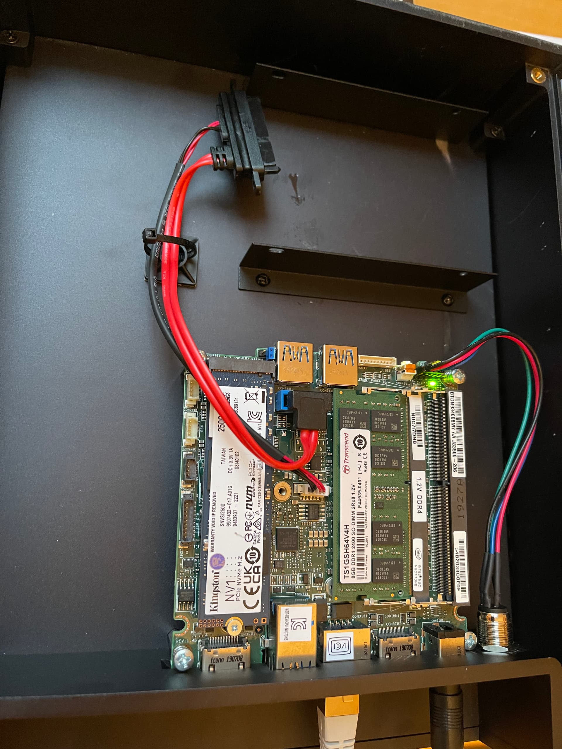

I added a picture.

Hardware looks like this:
Even just by going in and out of BIOS my Nucleus got into this endless starting and shutdown loop.
I could only get it started and back into my Network by disconnecting the electricity for approx 20 Minutes…
Then I disconnected electricity and LAN and implentented the SATA Samsung SSD.
Connected the Electricity and LAN , pressed the start button and the endless starting/ shutdown loop began again.
I took Nucleus another 20 minutes from electricity and tryed to get into BIOS during restart with F2.
Didn‘ t get so far, due to that even my USB attached keyboard have been ignored during system boot.
And again the endless boot/ shutdown loops started.
Really don‘t know how to continue…
