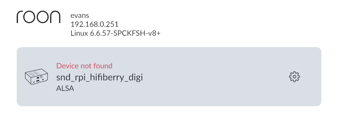

After the latest Roon update, I cannot enable one of my endpoints ('device not found')

I followed your instructions:
  1. Local Network was already “on” for Roon, so I turned it off and back on for both Roon and Roon Server
  2. After restarting the Mac Mini Roon prompted me to update to build 1483 which I did
  3. Now my 2 endpoints do not even show up in Settings > Audio :frowning:

I just noticed that when I try to access the endpoints using a web browser, neither of them is reachable from the Mini. They are both reachable just fine from any other machine on the network. And yes the Mini has internet access.
Actually rebooting my router on top of the above fixed the issue :+1:
