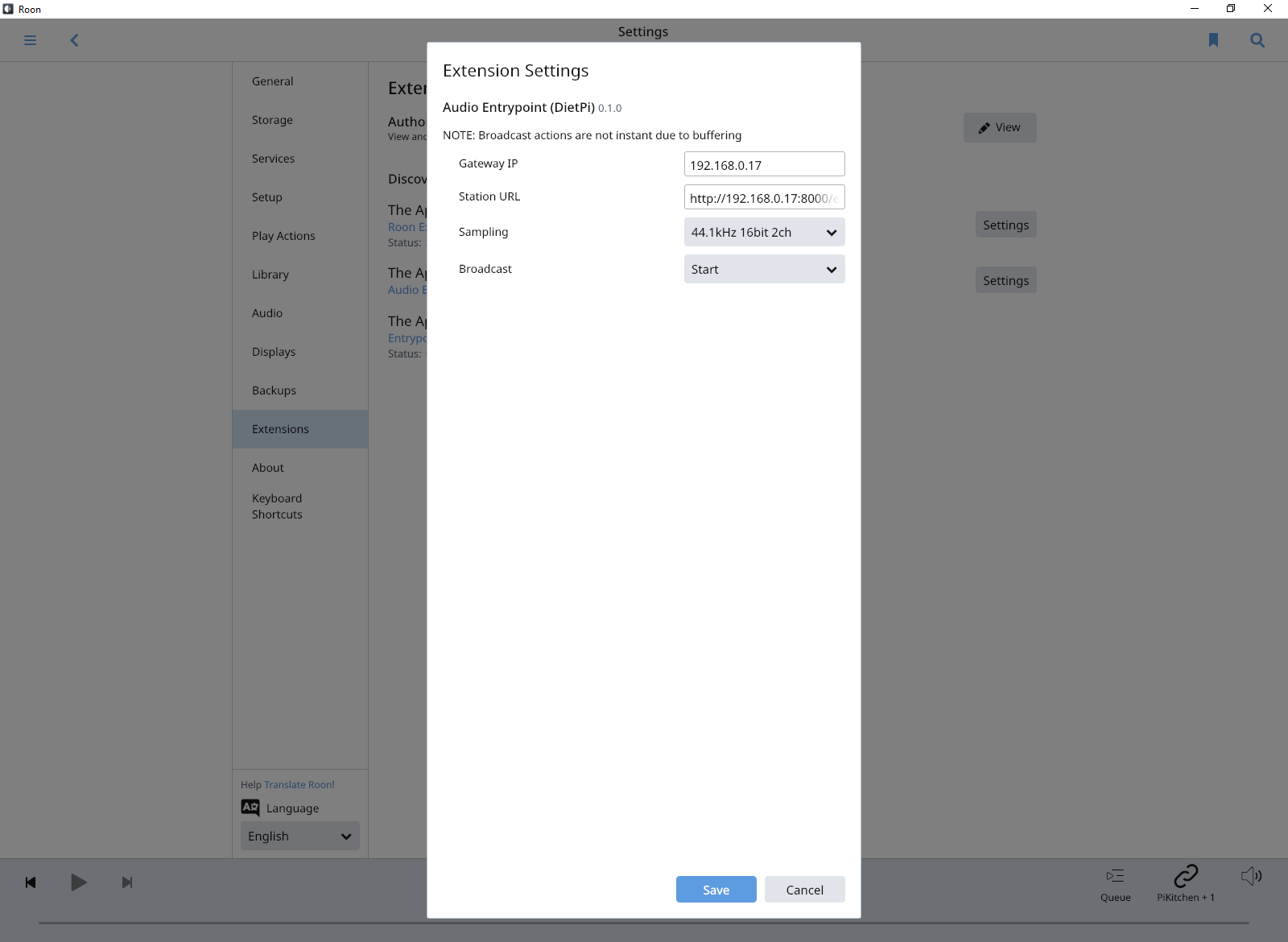

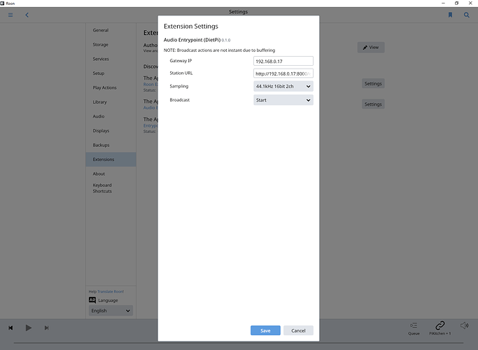

Audio Entrypoint v0.2.0 is now available
Since the initial release of Entrypoints I especially got feedback about the Audio Entrypoint. The experiences from @anon44636269, @Todd_Haugen and @Ian_Foulger helped me in working on the weak spots of the initial implementation. Thanks guys for your input!
This release contains some of the “finetuning” I was talking about in the initial post.
The biggest change is that in the Settings screen of the Audio Entrypoint you have to select the soundcard that has to be used. Last weekend I discovered that using the “default” audio device is causing high CPU loads, by specifying a specific device the load drops very significantly. As an example, on a Raspberry Pi 2B the load dropped from a single core load of 95% to 10% while capturing a 44.1 kHz, 16 bit signal.
@anon44636269, this might have caused the difference in performance you saw when you compared the Entrypoint with your own Liquidsoap experiments. Might be worth a retry :slight_smile:
@Ian_Foulger, I hope that the new soundcard selection solves the problem you are facing, let me know.
Another point is the manual actions that had to be performed to have the stream active and be able to setup the radio stream in Roon. Here I made some improvements to have it active as much as possible, only if the soundcard has specific limitations that prevent this (like the blocking behavior of the HiFiBerry Digi+ I/O) then a manual action is required. For the HiFiBerry DAC+ADC, that I acquired for testing, you now only have to activate it once in the Settings and after that it will stream what you feed into it, or silence.
Here is a screenshot of the new Settings dialog:
I hope that this update will give a much better user experience. Let me know how it works out for you!
