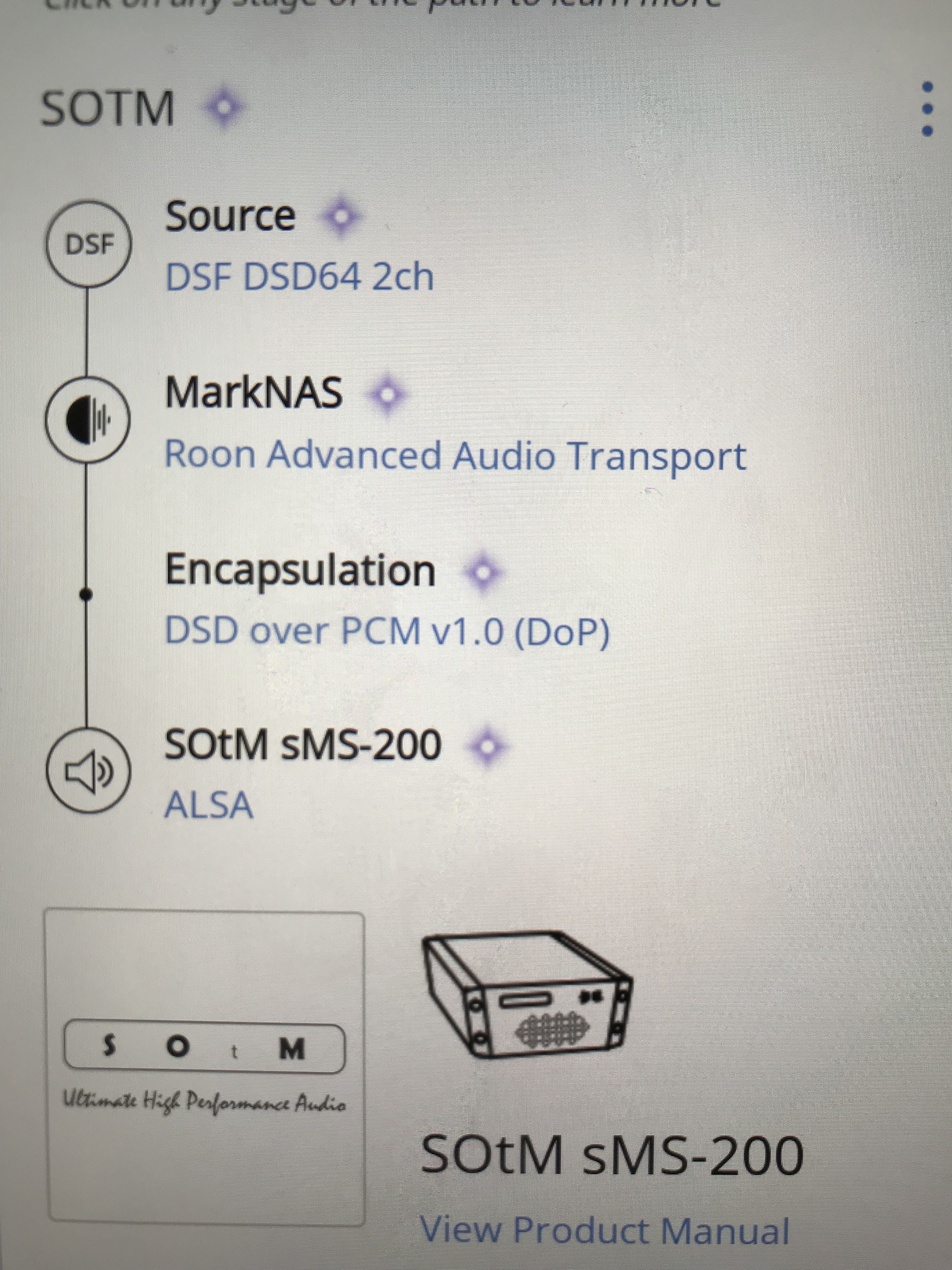

If you note the last screen shot when it played DSD the USB was in the signal path. Now on that last image/signal path the path stops at the Sotm
How come sotm shows as both connected to core and networked. Never seen that before.

BTW - the first signal path you show, i.e. ending in USB output, is what I get with my SMS-200.
No idea. QNAP server connected to router houses Roon Core Ethernet to SOTM with SOTM Ethernet cable, audio USB into CXN DAC

Also, you have zones named āsotmā and āSOTMā. I donāt know if upper/lowercase is recognized as two different things. On the signal path that showed USB output, the top part was cut off so I couldnāt see what zone it was.
MarkNAS is shown as RAAT, whereas the signal path that has USB output shows the SMS-200 as RAAT. THere would seem to be a problem.

One other thing, in the signal path that has USB as output, there should be some reference to DSD, which I donāt see.

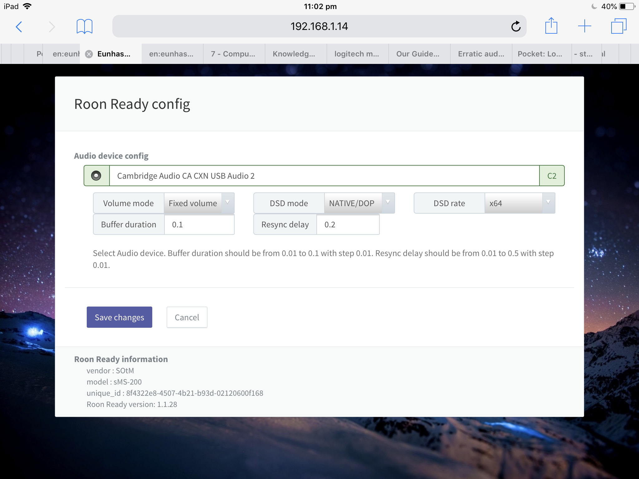

Maybe, go back and double check the SMS-200 settings?
Thanks Slim for your suggestions. Where the USB path is it does show dsd at the top of the path but it is converted down
SMS settings seems pretty straightforward. Click on Roon, select etc and activate. Iāve been in and out of there and tried everything and it doesnāt seem to complicate etc.
Just had another crack and it is back after I selected āfixed volumeā in both Roon set up AND SOTM settings. Go figure!? Thanks slim. Unfortunately it means I cannot control volume from Roon.
