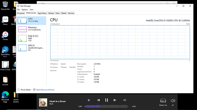

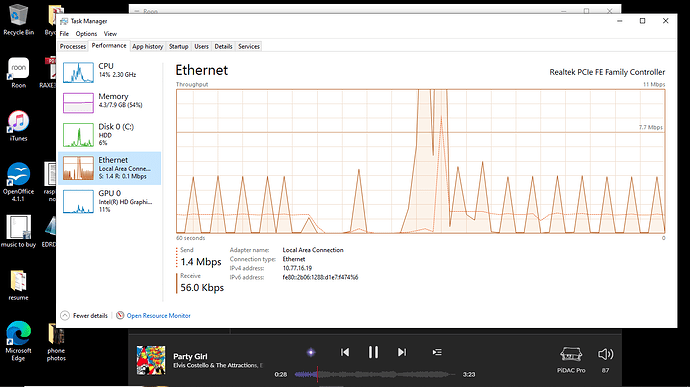

Hello everyone - My Roon was working just fine until the last Windows update (see config above). Now when I start playing a song it loses connectivity after about 15 to 30 seconds and then skips to the next song when connectivity returns. All the network connections are hardwired and there are no other applications running on the network when this occurs. The issue is either in Windows or the router, but I highly suspect Windows. When I run the task manager and go to the “performance” tab, everything goes fine until the “Ethernet” box on the left side just disappears for about 5 seconds, then comes back.
sometimes the disruption is short enough that ROON will skip to the next song, and sometimes ROON just stops. When I click Play in Roon again, the same thing happens on the next song. I am REALLY hoping it is a known issue with WINDOWS and the answer is not "You just need to go spend $3000 on a new core computer. Any assistance would be helpful. Again - everything was working fine with this configuration until about a month ago.

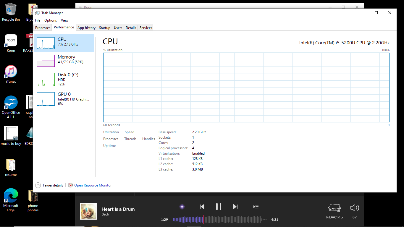

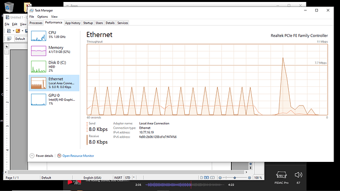

Here is what the task manager looks like when the “Ethernet” drops off the left side:
And here is when it comes back a few seconds later and Roon skips to the next song:
