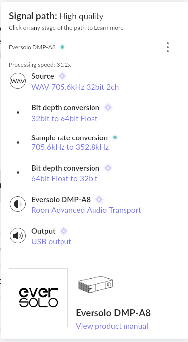

If you’d like us to investigate further - please share a screenshot of the Device Setup page in Settings → Audio for the relevant Zones. Please also share a screenshot of Signal Path for the configuration to which you’re referring here.

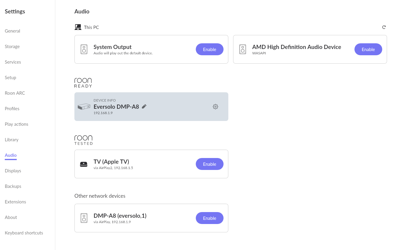

Hi - Please see attached screenshots. It shows Eversolo only to to do PCM - 384Khz
Thanks for your help
