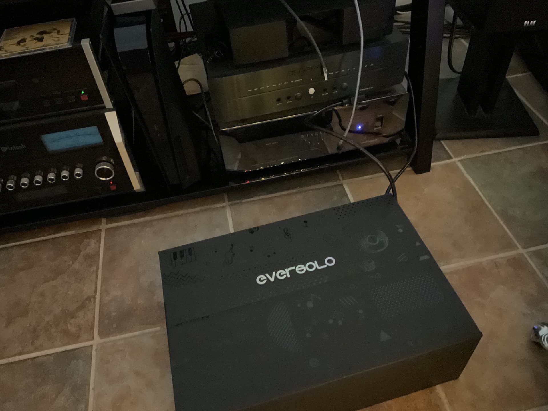

Eversolo T8
Arrived a day early
Eversolo T8 (Streamer)
