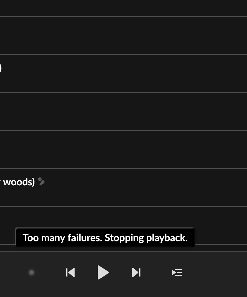

Just tried it again.
Time was 12:33 and 12:34 Pacific.
Thanks for your help, let me know next steps.
Tried my old first Gen Chord Mojo with same results. The Mojo is recognized and comes up as an audio device, but then the playback skips a few tracks until it gives the same “too many failures” message.
Wireless Roon is working perfectly. I am able to send music form the Nucleus one to two Astell and Kern portable players and control their playback fully from the same Mac.
This appears to be an issue with Roon and whatever most recent Mac update happened, as this is now two DACS that exhibit this behavior.
The error time for the Mojo test was December. 6th 10:59 to 11:00 PM.
It’s Definitely something wrong with the Eversolo Z8. Not sure if it is the unit or some new incompatibility with the new Mac OS.
The Ak portables were Abel to connect directly via usb-C and played fine, so did the Mojo after the computer was reset and I reinstalled Roon.
Any insight into possible fixes to the Z8 would be greatly appreciated.
